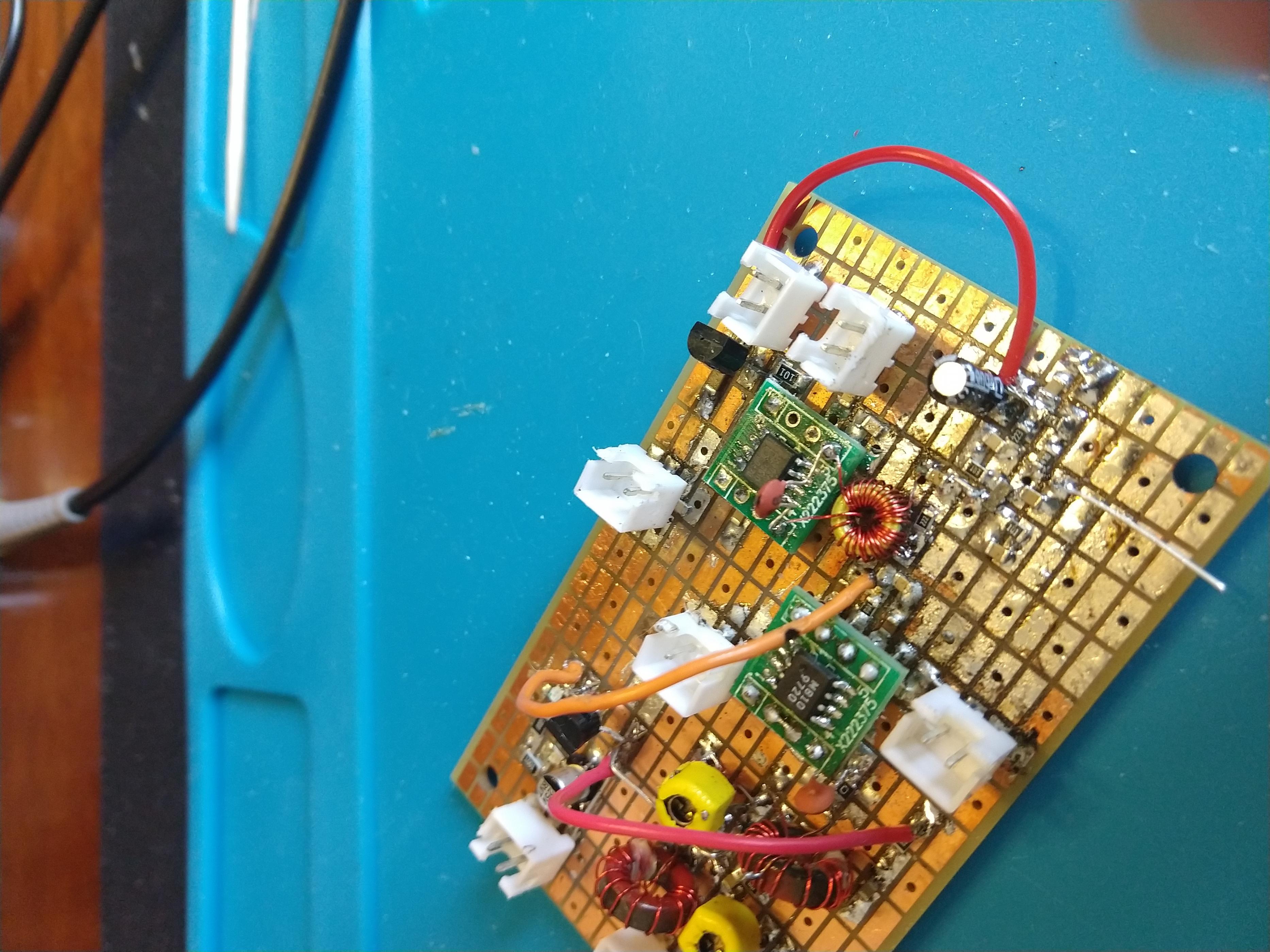

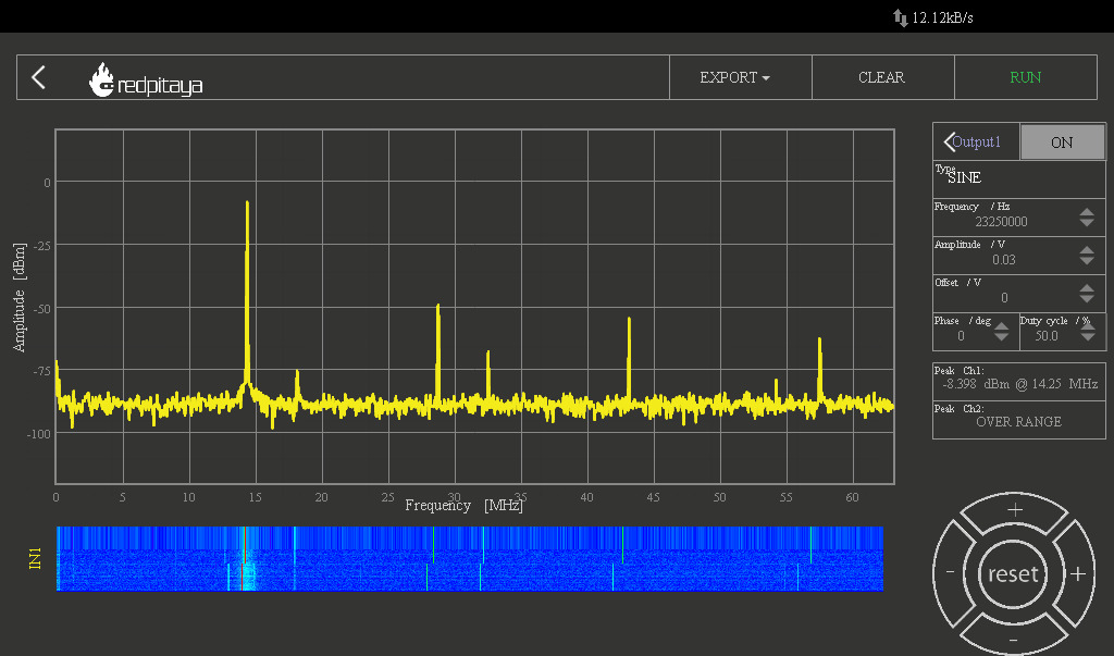

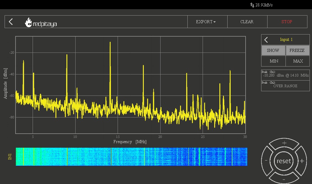

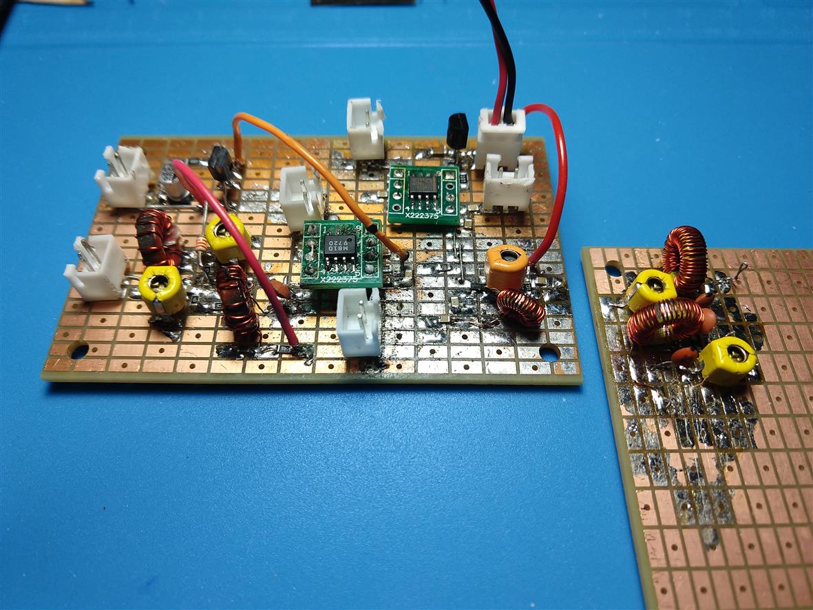

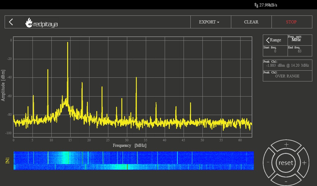

Just for fun, I decided to rework the post mixer untuned amp into a tuned amp, and see what, if any, difference this made. This turned out to be borderline difficult, since I really didn't allow room for a tuned circuit in the first instance, and I didn't want to rebuild it from scratch, which might actually have been easier.
The smallest toroids I had were T-25, and even though these are quite small compared to the T-37's, a T-25 and trimmer cap was a tight fit. I got about 1.8 microhenries worth of wire on the T-25; that and the stray capacitance floating around was enough to resonate it at 14 MHz with just a trimmer cap.

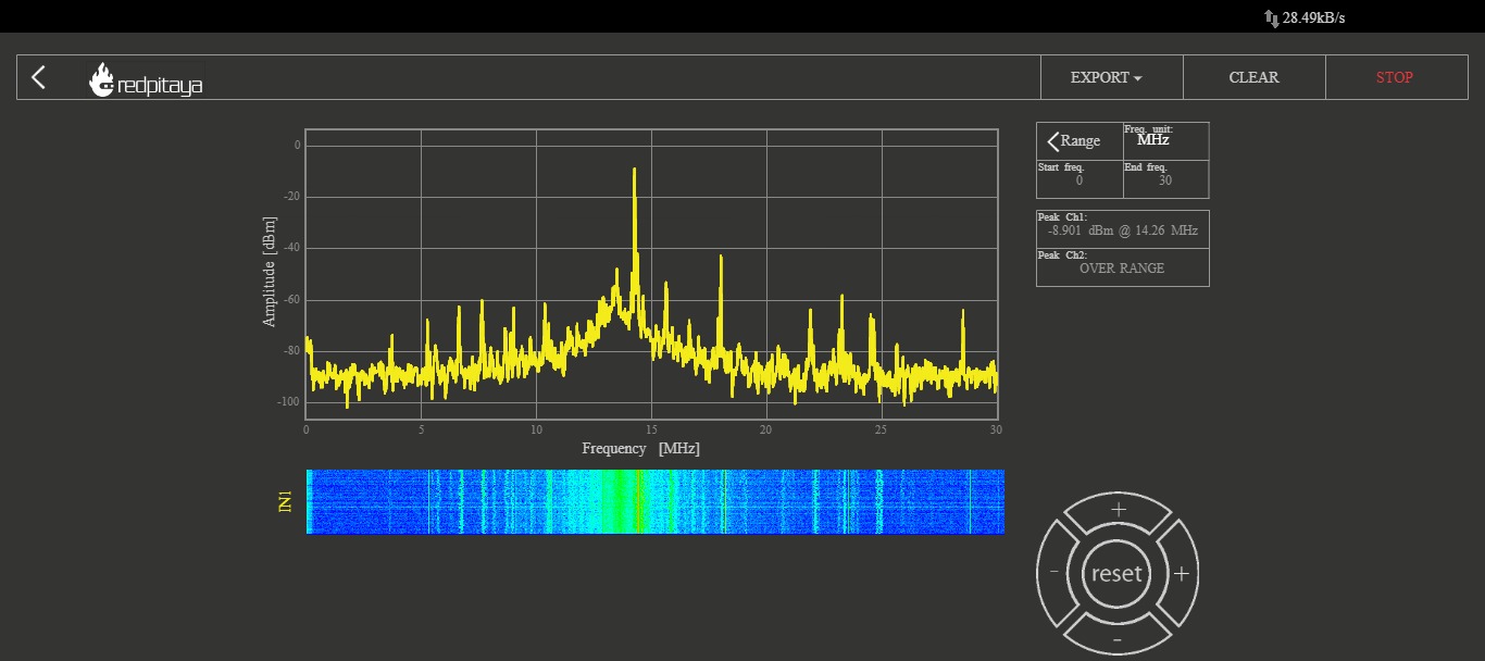

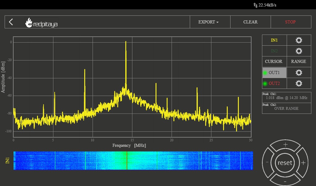

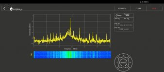

The results look to be worth the effort - the first spectral pic is the untuned amp, and the following spectral pics are the tuned amp. The improvement was substantial: about 12 dB more power at 14 MHz, and about an additional 20 dB reduction of the 9 MHz component.
The center pic was the first spectrum shot I took - I couldn't figure out what all that width was at the base of the 14 MHz output, so I flipped on the 51S-1 to listen to it, and it was AC hum. After hooking it up to a battery supply, and unplugging everything in the vicinity with a switcher, except the little wart powering the RP, most of this went away as shown in the other shots. The residual is probably the RP power supply.
I expect this won't be an issue since it is going to go in the trunk of my car. I may play some with balancing the SA602 output, or adding on a little more filtering on the DC, or I may not. I really want to be done with this board and move on.

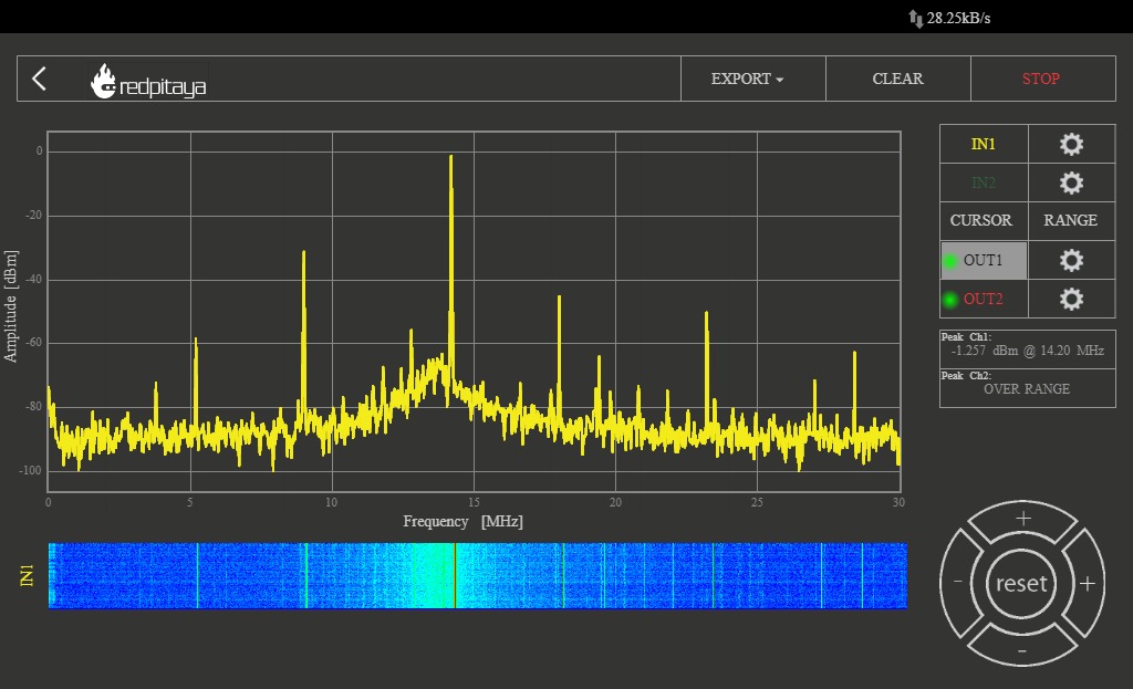

I put a ( sort of ) broadband transformer on the output of the SA602 to balance the output. The smallest ferrite toroids I have are FT-37, so it's way too big, but it's rigid, not fragile, and looks to make a substantial improvement on the suppression of both inputs, but didn't do much for that second harmonic of the 9 Mhz input.
It didn't do anything to solve that wideband noise issue. Nor did power supply filtering, isolation, etc.
I've never had anything that can "see" a wideband parasitic oscillation, but that's what I'm seeing ( and hearing - the classic AC buzz ) isn't it?
a) it shows up as soon as I put a Hi-Q tuned circuit in the drain lead;
b) it peaks at a point just slightly below the resonant frequency of the Hi-Q tuned circuit;
c) I've read that toroids are self shielding, but that trimmer is sitting right on top of one of the gates, and could be a low capacity feedback path into the gate; that extra bit of stray capacity explaining why the oscillation peak is a bit lower in frequency than the intended tuned circuit?
Is this plausible? I don't have a hot air gun here at the lake, otherwise I would just take it apart right now to test this theory.

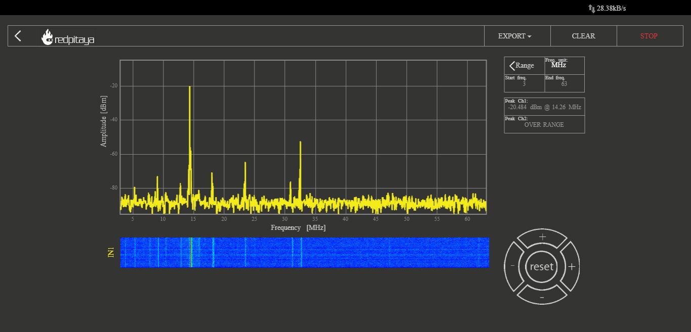

It was oscillating, so I moved the tuned circuit to the output of the SA602, where the T-25 toroid transformer was a perfect fit. There was no room for a trimmer, so I hand selected capacitors to resonate the primary of the coil.
It resonates somewhere between 56 and 82 pF. The only leaded value between those points that I had in my tool kit, was 68 pF, which is fitted. This looks pretty good, but might still have room for improvement.

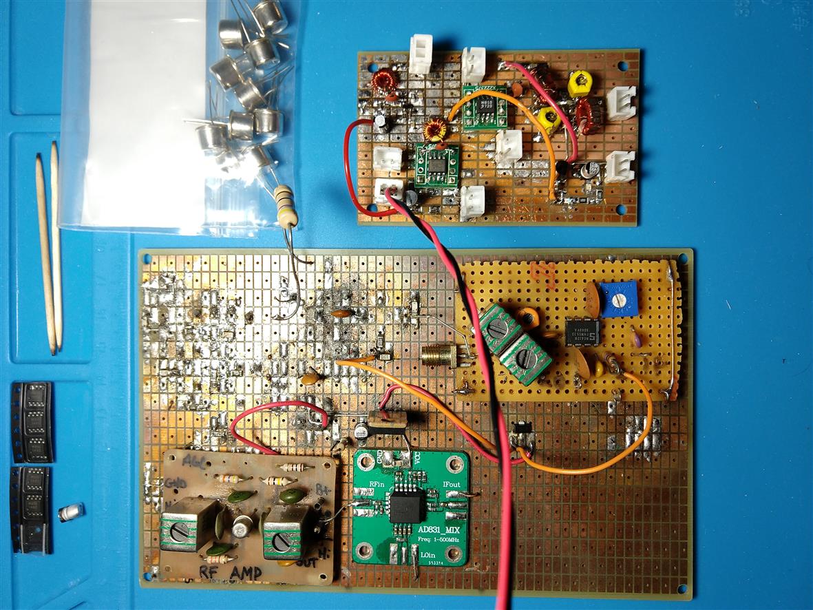

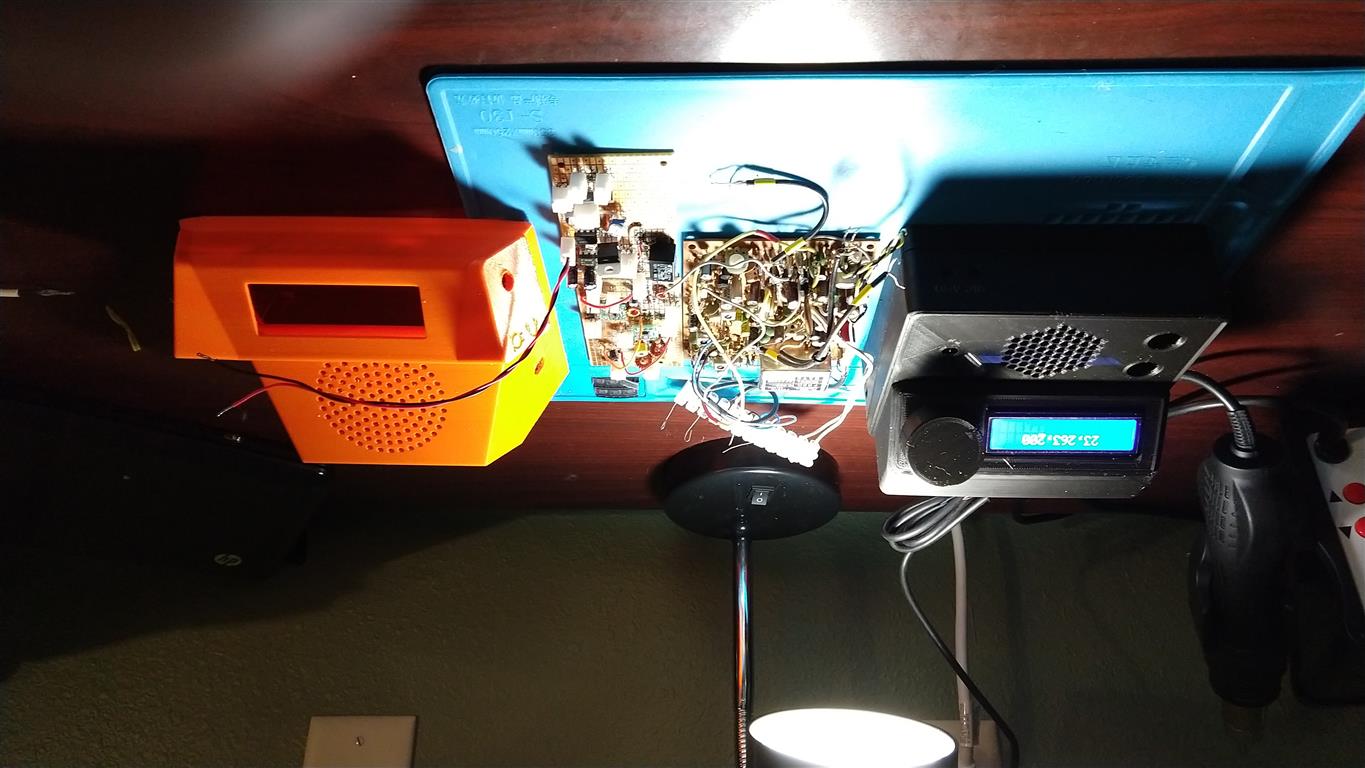

I reworked, slightly, the tx post mixer amplifier, and, unless it just won't work in the actual radio, the low level transverter board is done. All of the IF and LO is gone, most of IF + LO is gone, but harmonics of 14 MHz are present, presumably from the BF992.
I was going to scrap out the ugly experiment board, but it occurs to me that it would not take much at all to make it into possibly the world's largest and ugliest single band 14 MHz DSB transceiver. The data sheet for the AD831 says the IF can go down to DC. I think I can put audio into the NE602 and use the balance control to null the carrier. Might not even need a speech amplifier. It has the 14 MHz bandpass filter in place and tuned up. So, for now it will remain intact, or whatever one wants to call it.
The bag of transistors are supposed to be 2N3553; about $7.00 USD for a bag of 10 from AliExpress. 2N3553 was pretty hard to find in the day, so I doubt these are genuine, however, I do have some real 2N3553 from back in the day to benchmark them, so, in due course, we shall see.

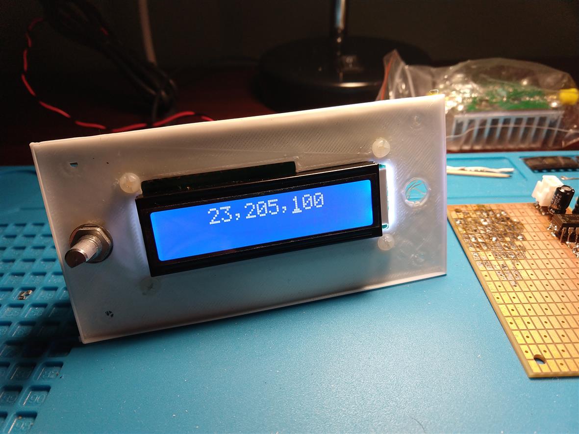

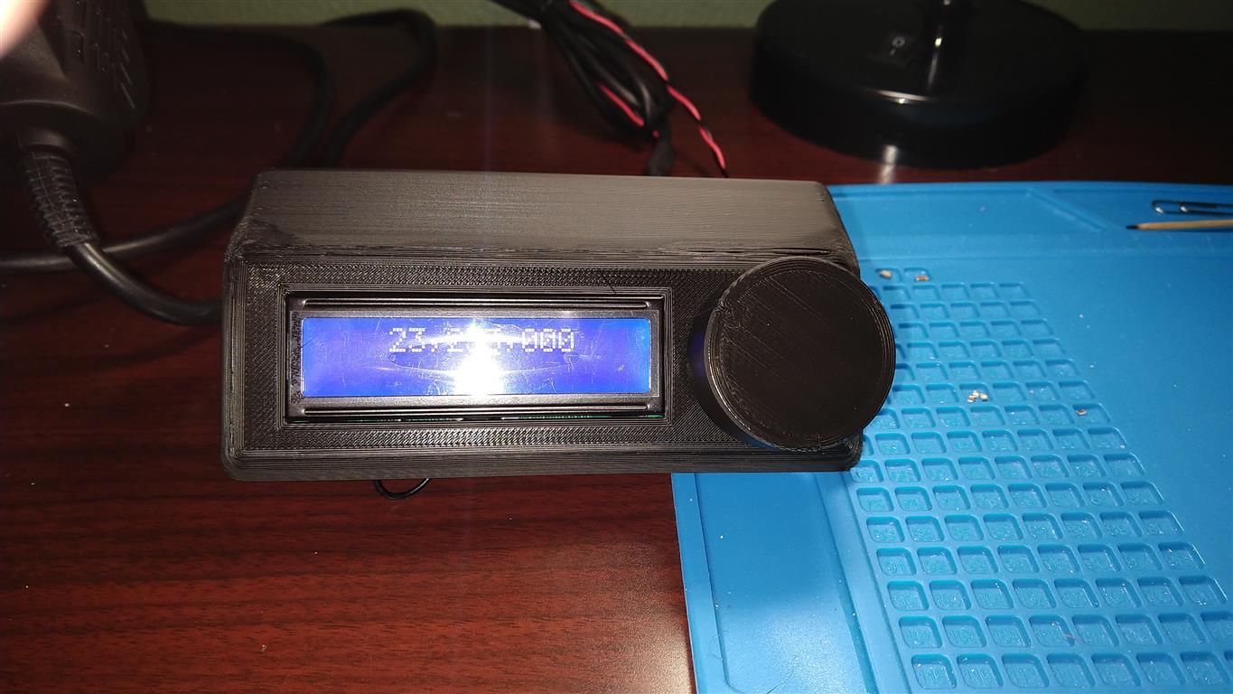

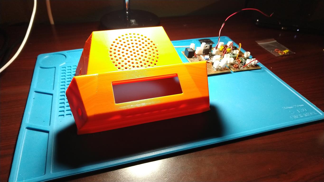

Beats having it flop around on my desk, but in no way acceptable for a car, although I suppose the longer this drags on, the more willing I am to compromise ...

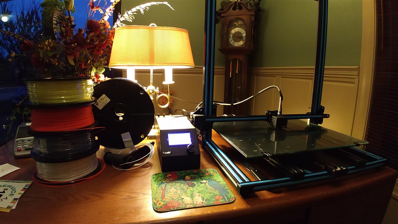

This printed in about one half hour.
edit: I think, if I can remotely master the 3d printer thing, I see no reason for the display and controls to be on the same panel - frequency display should be somewhere where it is in sight without taking eyes off the road, while volume and frequency control can be somewhere close to hand, with different shape knobs, which can be printed ...
Looking good, though. 3d printing is a doddle so...
Perhaps, but I have no prior experience with CAD stuff so it is ab initio and yet another big learning curve for me. I do think once the software is useful for ordinary people, these will be as common in the home as PC's are today.

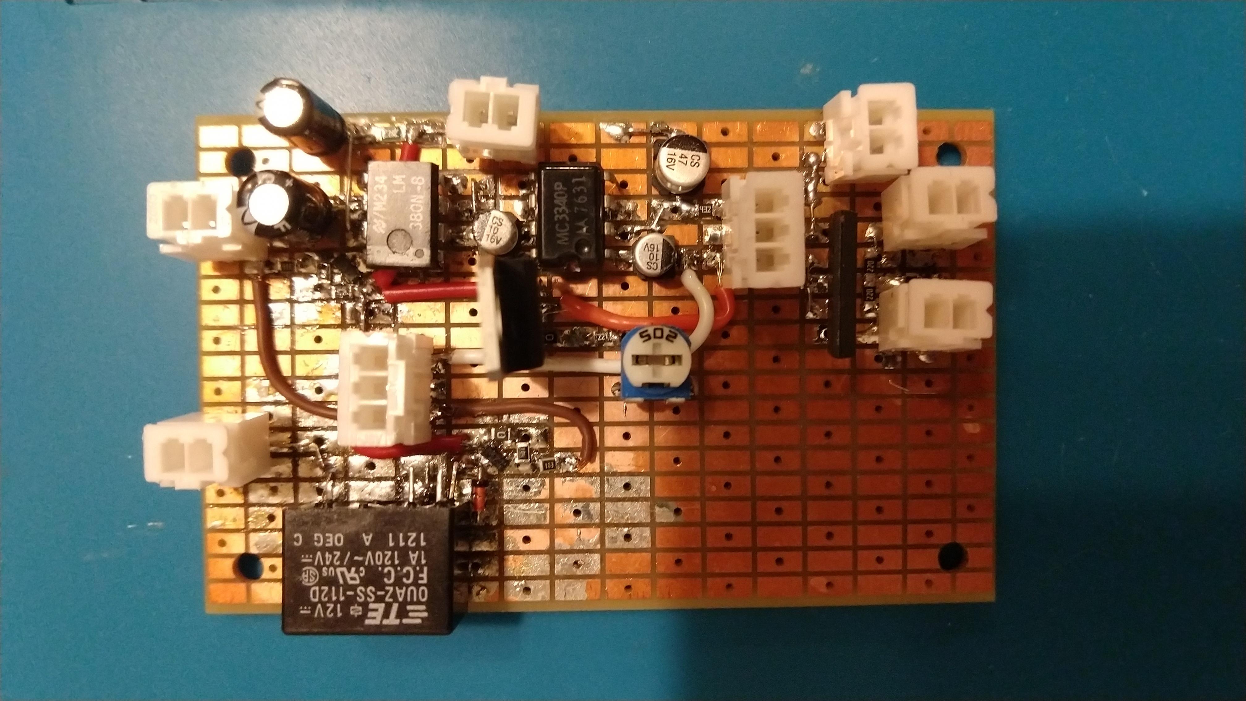

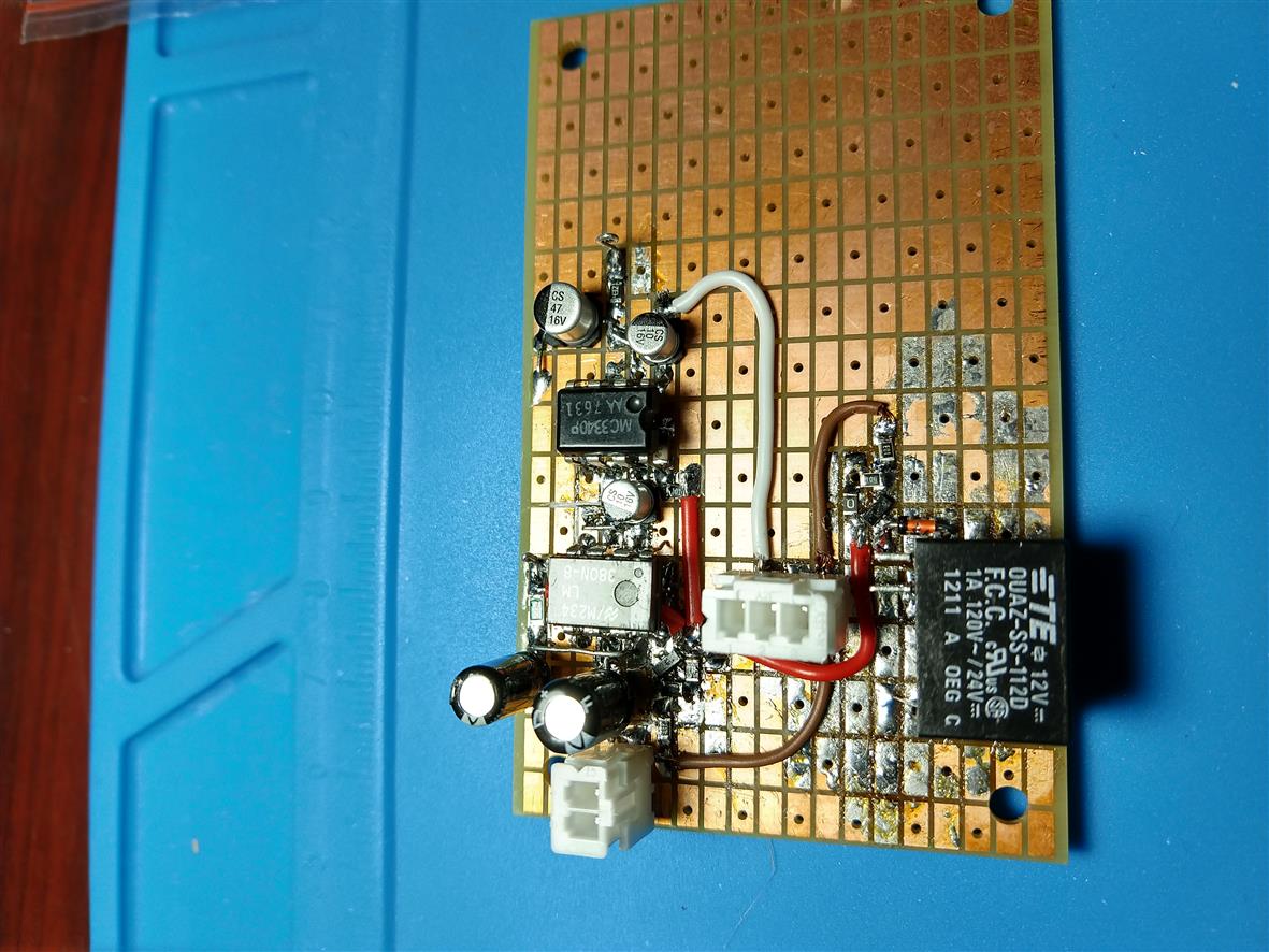

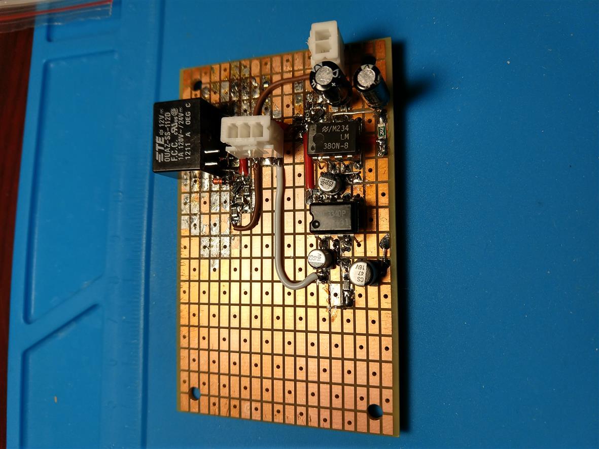

In the meantime, I've been working a bit on what I call the housekeeping board - this will have the remote volume control, a lower gain audio amp to better distribute the audio gain and hopefully improve the volume control action, T/R switching, LO splitting and conditioning, etc. It is about half done. The SG-9 handles low current voltage switching between receive and transmit, and has voltage lines to control the transverter board.
The remote volume control is an MC3340P. Obsolete, but I have a half dozen or so. The amp is an LM380N-8. On both of the chips, the bypass and decoupling caps, RC networks, etc., are under the chip to save space. It's not on the data sheets, but likely well known that in the LM386 and LM380 / 384 chip family, the bypass pin has a secondary function as a mute pin - connecting the bypass pin to ground, or to the positive voltage rail ( builder's choice ), cleanly and quickly mutes and unmutes the chip without thumps, clicks, pops, or other drama. Here, as the PTT line goes low, a '3906 type puts the bypass pin high to mute the audio chain. A similar switch toggles the TR relay.

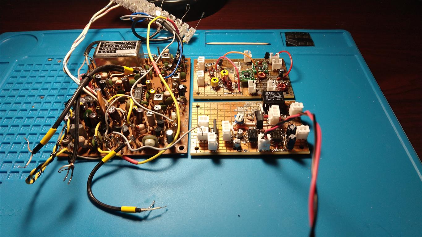

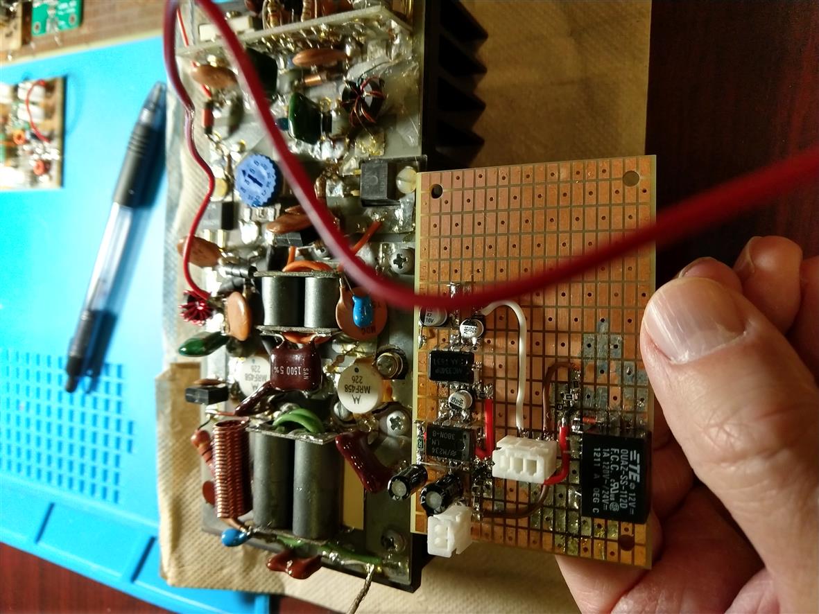

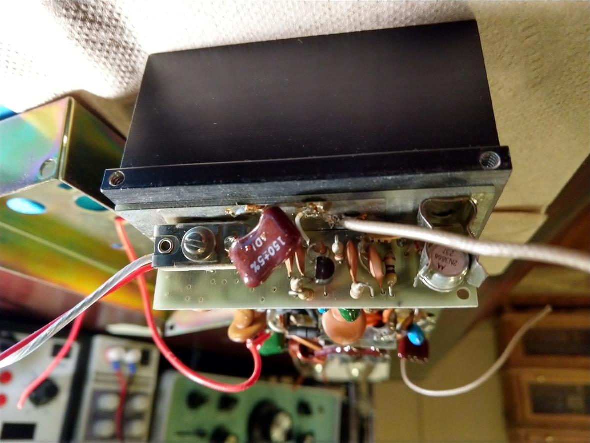

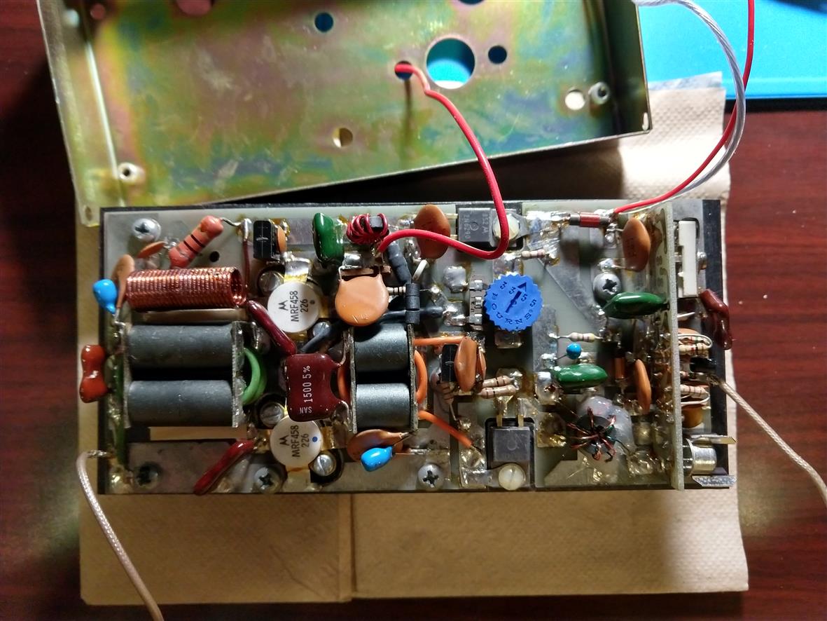

So, this is the Dentron brick, 100 watts + output at HF ( when they work ).
It is quite compact, as shown in the comparison to the proto boards I am using.
The low level input takes it's drive directly from a dual gate MOSFET TX mixer in the donor radio, so sub milliwatt to milliwatt level drive is all this requires. The TO-5 transistor is a 2N3866 so probably a watt or two out of this. This looks like it could be transplanted to my radio. I have genuine 2N3866 transistors in case this one is fried, but I would probably sub in a 2N3553 if I rob this board from the brick. I might need to bypass my TX post mixer amp.
The driver is an MRF476. I may have one or two of these in the junkbox.
The output transistors are MRF458 with a blue dot. RF parts has them, the ordinary MRF458 is $60 / piece. The "low beta" MRF458 ( which it sub lists as MRF454 ) is $26 / piece. I don't know which is applicable here. I think it likely the output transistors, or one of them, are shorted. I don't know if it is worth pursuing a repair of this, or if other transistors would work. I would like to extend the range to 6 meters, but I don't know if frequency is limited by the transistors, or the ferrite, or both. The little low level board should go to 6 easily; 2N3866 is a VHF part.

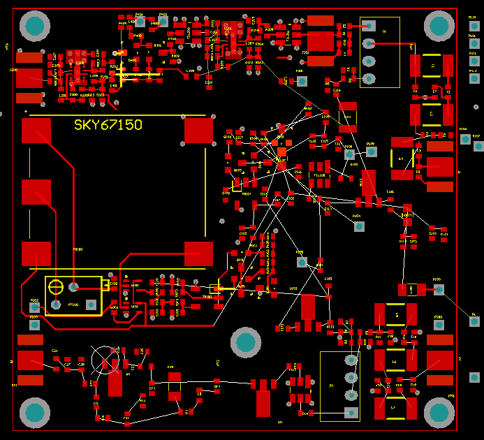

I'm not really far with the transverter project for 432. I'm still moving components
on the board. I have built the input stage. Expected 0.3 dB noise factor and we
measured 3.x dB. Got the only demo board from DigiKey. Probably my SAW filter
is too narrow for the 8970B. My noise head is at Bernd's for comparison. A real
calibration would cost some €600, that's not justified.
The pic is the transverter board. it is about 2.5" * 2.5" ( 60 * 60 mm).

I worked some on mine this afternoon.
Added the signal conditioning for the LO. It's laid out poorly, and may need to be redone. It's calibrated for the DDS, the Si5351 will need addtional attenuation off the board. The DDS and Si5351 require different voltages; I added an adjustable regulator to accomodate either, and any voltage drop on the way to the control head. I didn't have any coax, so I have not finsished two connections to the TR relay.
The housekeeping board is denser than I anticipated, but I still have empty space for one or two TX power stages if needed. I'm a little surprised at how many connectors it takes to cable everything together. At least the connectors are cheap.

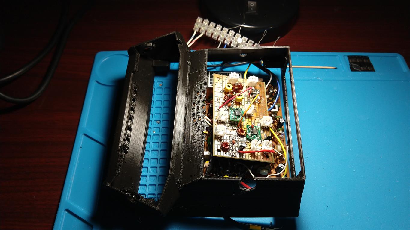

I think I am at the point where I can think of cabling this all together and packaging it ( even though I am still only at mw TX levels ), and being able to print some boxes has made me ( maybe ) rethink how I want to do this.
I had planned on using the printed box just as a less ugly way to hold the tunable local oscillator/frequency display and the knobs, speaker, etc. Everything else would be in the fugly metal box back in the trunk.
But the SG-9 IF board is pretty small. It fits easily in either of these boxes. I half printed that funky box so I could see down inside it, and there looks to be room for the transverter board above the SG-9; likewise with the square box. With everything in one box, the housekeeping board would be mostly eliminated - I would not need the remote controlled attenuator for the volume control, and could use the audio amp built into the SG-9. All I would need would be a TR relay, and the regulator for the local oscillator power supply. I could use that metal box for the transmit PA.
So now I'm not sure which way I want to proceed. I guess that's a good problem.
