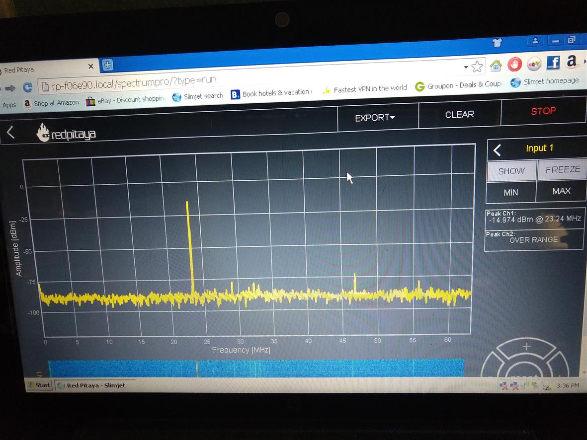

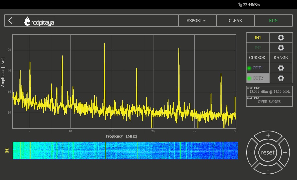

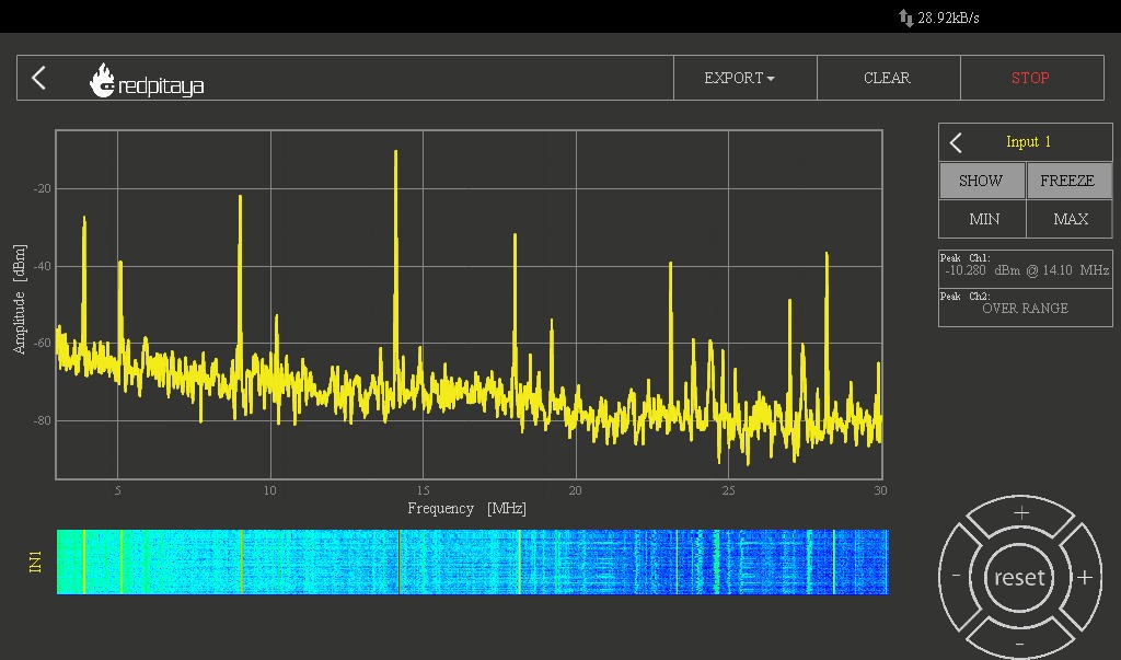

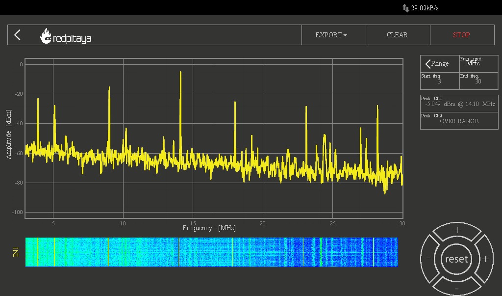

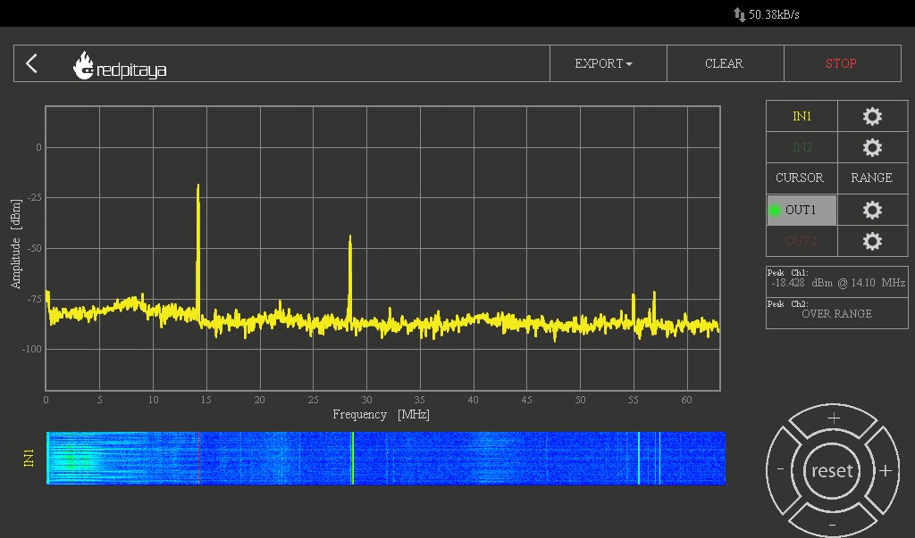

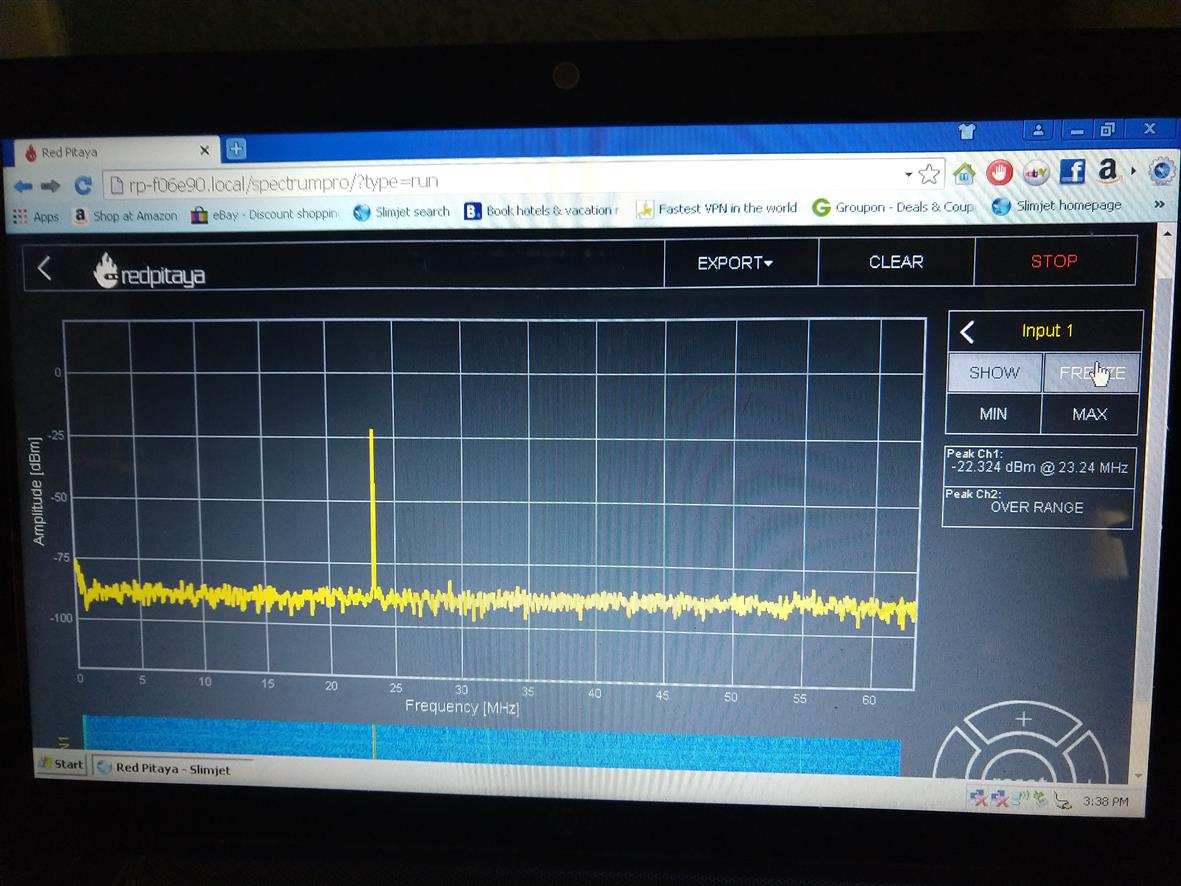

I got some of those 23.4 MHz EPCOS SAW filters, and removed the existing input attenuator, and put the SAW filter in its place.
According to the RP, it looks like it has about 8 dB insertion loss, so it will be about right for the DDS LO. For some reason, I did not check the passband width or slope of the skirts.
I think the spectrum pics are at the input to the SAW filter, and the last pic is the output.
edit: in these pics, the RP is generating the test signal - the DDS is at home ...

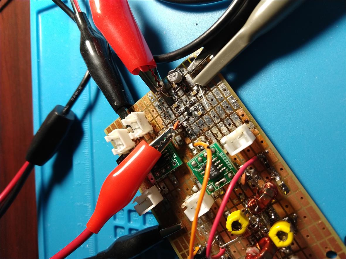

I worked on it yesterday, with the intention of getting the new board mounted in the chassis where I could see how the RX would work, but a handful of SNAFU's thwarted that.
I've been waffling on whether or not I wanted the LO filtering / attenuation on the new board, and I finally decided to put it on the board that will handle the T/R switching and other housekeeping, so I removed all that stuff.
I got the TX mixer locking connectors installed, and was killing some time playing with output filters, when the TX SA602 just died. I replaced it, and the replacement also died instantly. The culprit was a bad 78L05 regulator at the power pin, but it cost me two SA602 before I figured this out. The regulator was from a bag of about a hundred that I got for some insanely low price at a hamfest, so I should have had better sense than to use them, but other than being all over the place in voltage ( I've seen anywhere from 4.9 to 5.4 VDC ) they haven't given me any trouble. This one had burned in for about a half hour before I trusted it, and was outputting a steady 5.2 volts at up to 16 volts in, to simulate what my alternator can put out.
Naturally I replaced it with another one from the same bag, burned it in overnight, and it is spot on at 5.0 VDC. To hedge my bets, I replaced the SA602 with one from a strip obtained cheap via Bay from China.
The pic is the eBay '602 going through burn in on the RP. I stated before I could not tell much, or any, difference, between these dubious '602, and genuine '602 and that is still true. The second pic is my notes on this chip, measured by the RP. The LO is suppressed 38 dB at the output, and the IF is suppressed 27 dB, with the inputs and outputs being single ended. I think I am going to use a 3 dB pad between the output of the SG-9 and the transverter board.

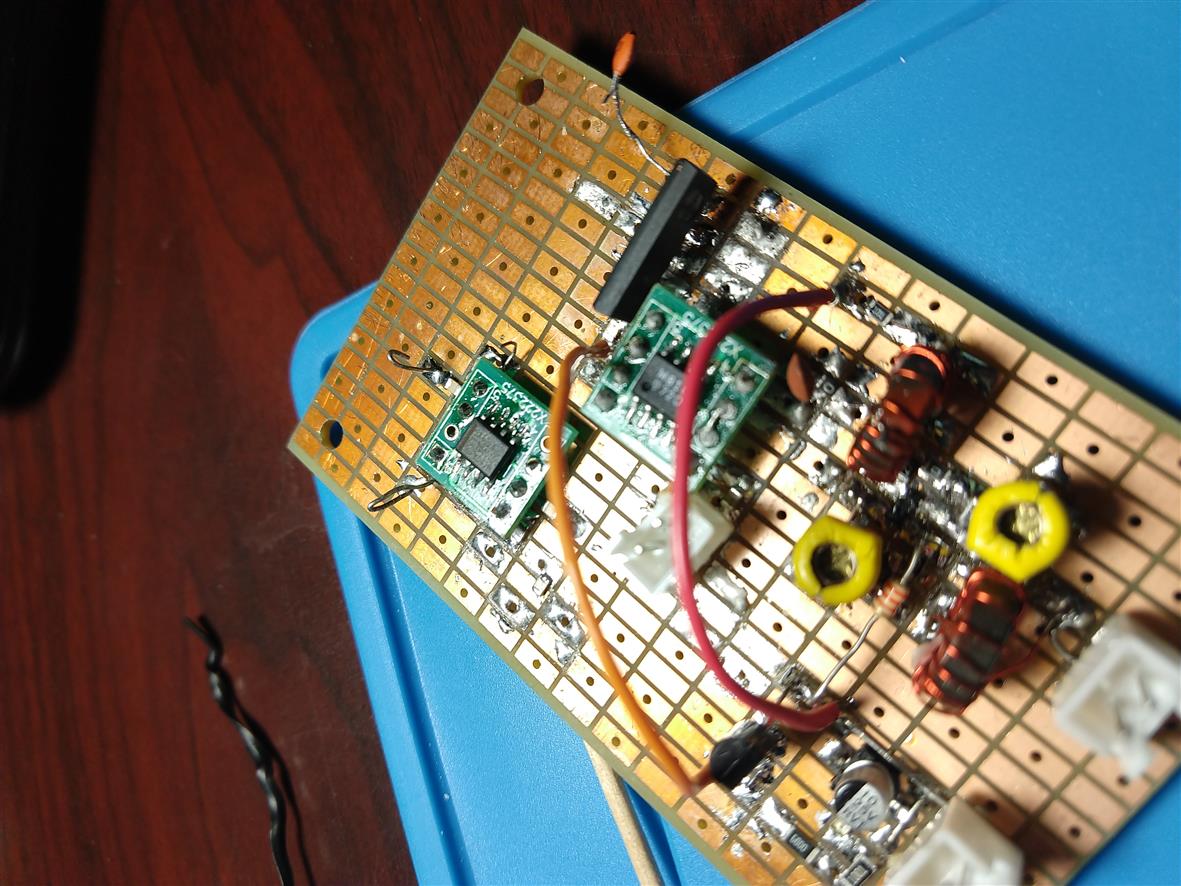

This is a dual gate MOSFET (BF998) broadband amp following the TX mixer.
I'm using the RP to feed it the -27dBm that I expect from the mixer, the drain load is a 47 ohm resistor for a 50 ohm output; I'm getting -18 dBm or about 9 dB of gain, pretty much flat out to 50 MHz ( as high as the RP goes ).
Is this about the right amount of gain given the low drain load, or do I need to do some tweaking on it?
I burned out the last of my MMIC's last night - just could not make them stable. I suspect they all died from self oscillation, which when combined with the desired signal, exceeded the max power. I couldn't see where they were oscillating, but they were acting wonky, consistent with a VHF oscillation.
On the plus side, I've gotten pretty good at being able to rework these proto boards without damaging them.
I changed the bias on the control gate by adding a couple of volts, putting it at about 3.75 VDC g2s, and dropped the source resistance down to 100R ( 0.41 VDC ), and this more than doubled the output from the untuned amp.

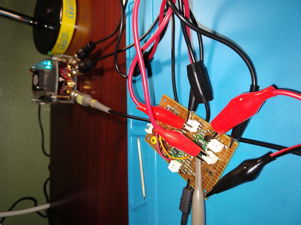

Here is the whole smack strung together, with the RP as the signal source, eBay SA602, and the Infineon BF998 DG MOSFET.
I can push the output up over 0 dBm if I want, but it is yet to be bandpass filtered, so I'm not sure I want it too strong. The bandpass filter will go on the board for the TX strip.
This board is going to go in service in the chassis, so I can start testing the receiver in the car.

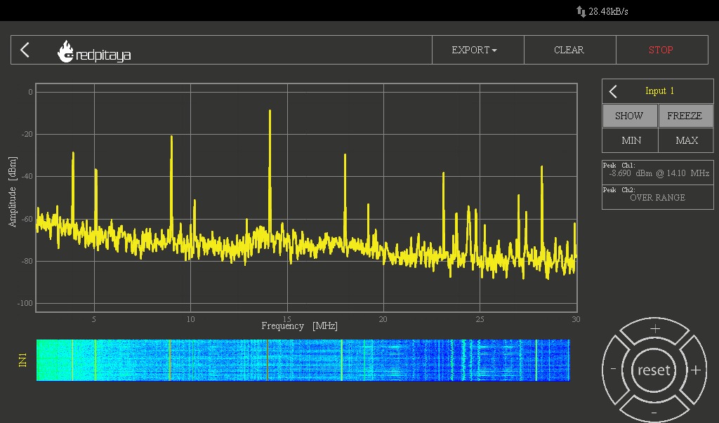

That gradually descending high noise floor was bugging me, so I stayed in the office at lunch and played with it a bit.
It's not related to the input drive levels.
It does seem related to matching between the SA602 and the BF998. Best I recall, the output load of the SA602 is about 4K. I had a pretty high value R on gate 1, so I dropped it to 2200R since I am taking the output from the '602 single ended.
This made a 10 dB improvement in the noise floor above about 5 MHz.
I think there is still a lot of power and gain left on the table; the 100 ohm source resistance could probably be reduced a lot, maybe by a factor of 10.

This is a genuine SA602. Compared to the eBay '602 under identical conditions, it looks to me like the genuine chip has:
marginally less spurious response;
marginally lower noise floor;
marginally less output (3 B)
marginally better suppression of the 9 MHz IF signal ( about 3 db); and
way, way, worse suppression of the LO signal - the other chip was 20 dB better.
I don't know what manufacturing tolerances are, but everything except the LO suppression could be normal manufacturing variance. I don't know what's up with the bad LO number.

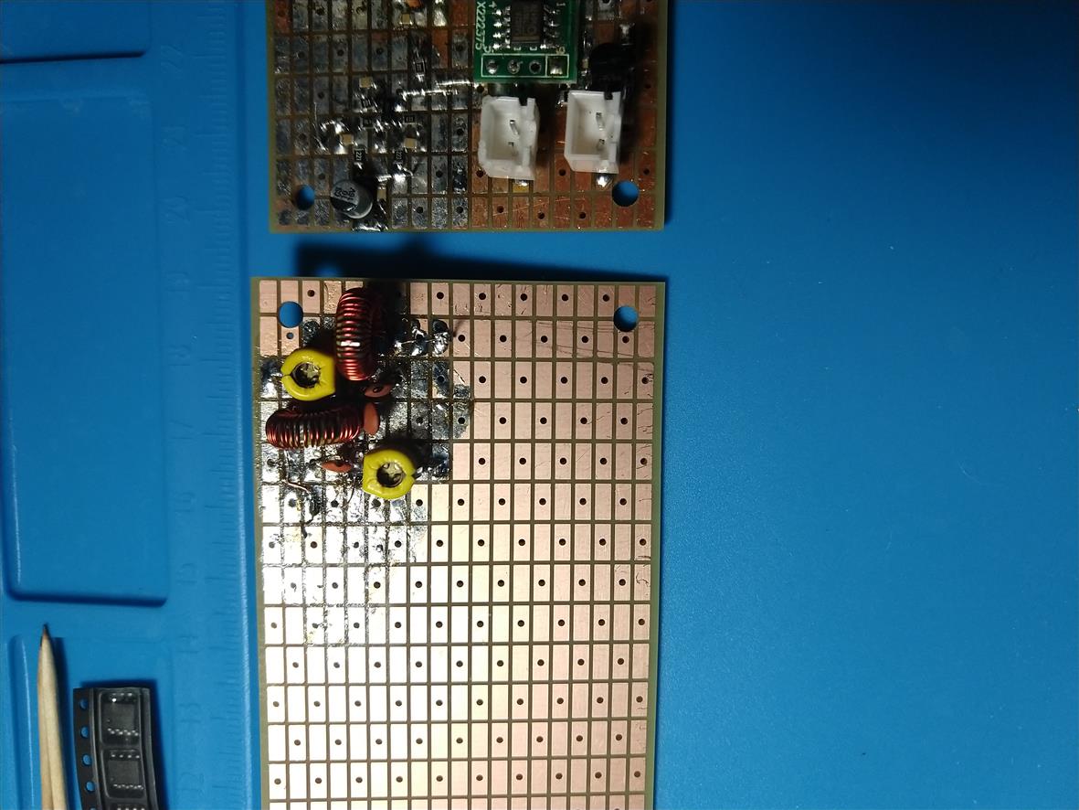

Started the tansmitter board.

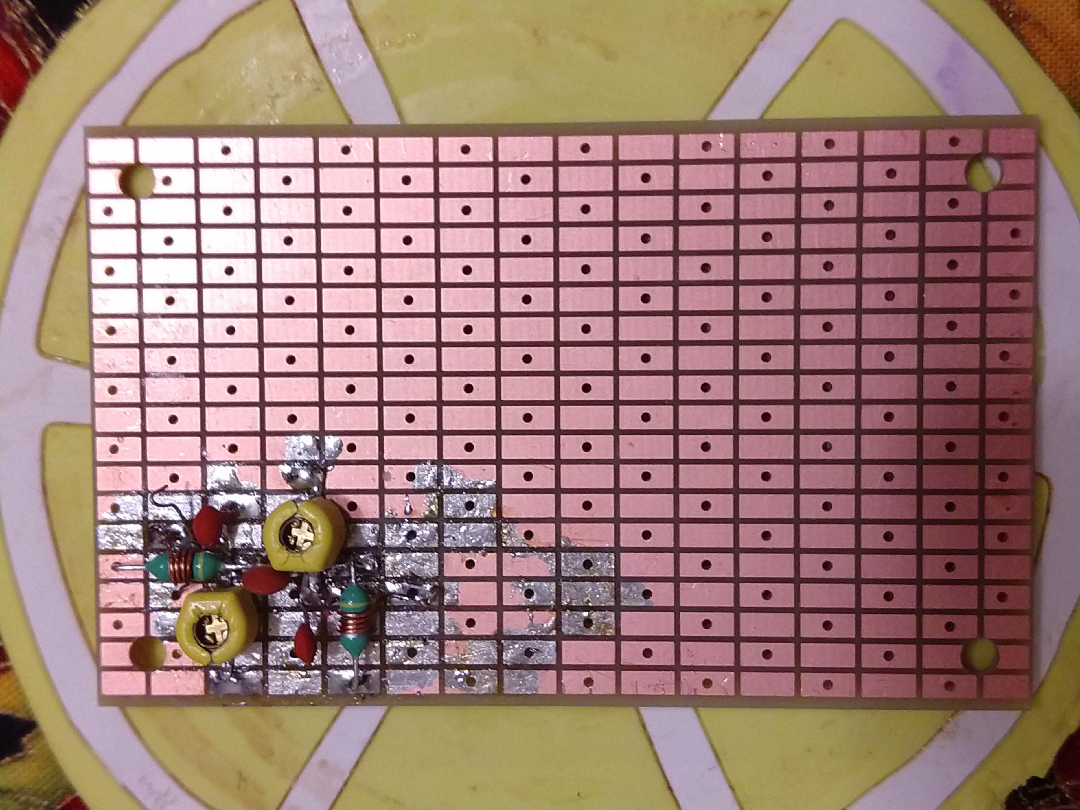

Instead of the IF transformer type coils used in the bandpass filter on the test board, I wanted to use toroids. Unfortunately, the toroids in my travel box were bigger than I wanted to use ( T-50 ), and the magnet wire I had with me was way too small (0.1mm), and the combination of the two was just a disaster. Try to wind the coil tight, and the wire would break. Stick the end in a flame to burn off the enamel, and the wire would melt (!). Tension the wire to hold the coil tight to the board, and it would break.
After a morning of struggling with that, and winding up with a filter with coils so jiggly and mobile that I doubt it would have survived the trip home in my toolbox, much less pounding around in the trunk of a car, I just gave up and completely disaasembled it.
The other inductors I had on hand were some 6 uH ish slug tuned coils, a bit on the large side, 1206 and 0805 smd/smt inductors, and some 1/4 watt size molded inductors. I wanted to use the SMD devices, but I wound up using the molded inductors.
I made a mistake right from the start, but didn't realize it until later, and I still don't completely understand it.
To make it simple, I decided I decided I woud use a link coupling in and out of the filter; I wanted a good signal transfer, so I wound the link the pinched length of the inductor, about four turns. When I tested the first pole, the resonant frequency was way too high - it took about 56 pF of additional padding to bring it down to twenty meters. I wound the second inductor the same way, and got precisely the same result.
The resulting filter does have a bandpass response, but the slopes are shallower than I expected - about -25 dB at 10 MHz, and maybe -20 dB at about 19 MHz. After thinking about it a while, my WAG is that I managed to create a significant parallel inductance on the same core, large enough to significantly lower the inductance and requiring the extra capacity to resonate where I wanted it. I'm aware of Q, won't pretend I understand it, and doubt these were high Q coils to start with, and my parallel inductor probably doesn't help the Q.
That said, it's probably ( barely ) good enough, and on the plus side, is quite compact and very rigid. It won't fail banging around in a car. I might add a third pole and see what, if any, that adds to the skirts.

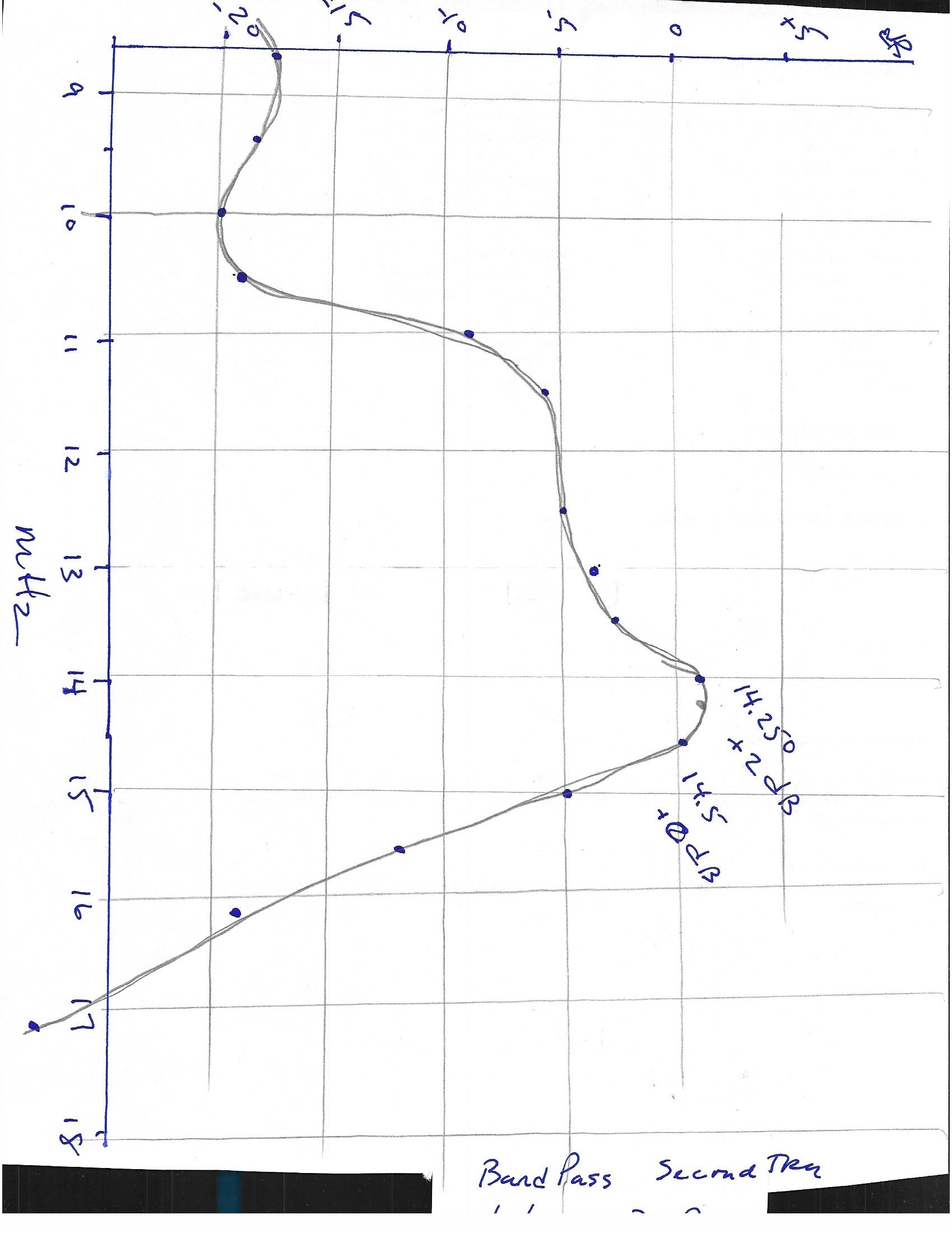

This was bugging me, so, I took it apart and replaced the four turn link coupling with a two turn link coupling, which fixed the odd behavior with the resonant points.
But the bandpass response is still somewhat unsatisfactory. A crude graph of the response is attached.
The high side response looks good, the low side okay, but it has a pretty good bump on the top, right at the resonant point of the poles. The bump looks like it could be a tuning error in the filter poles, but I've played with it some, and so far can't seem to tune it out, although I can probably improve on it a bit, given more time. I'm glad to have the Red Pitaya, but using it for this kind of filter tuning is pretty tedious.
Or, I wonder if this is an issue of coupling between the two filter poles. They're top coupled with a fixed 7 pF ceramic capacitor. I thought about putting a trimer here when I was building it, but really didn't want to sort through three variables tuning it. I can put one there, but would have to rebuild it again.
I replaced the transformers previously made with the molded inductors, with some wound on T-37-6 toroid cores.
The latter are much more efficient - looks like the insertion loss of the whole filter is maybe only a couple of dB, maybe even less than that.
I haven't played much with the filter; I did spend some time looking at just the first tuned circuit, and was somewhat surprised at how selective a single tuned circuit can be when made with a good quality inductor.
