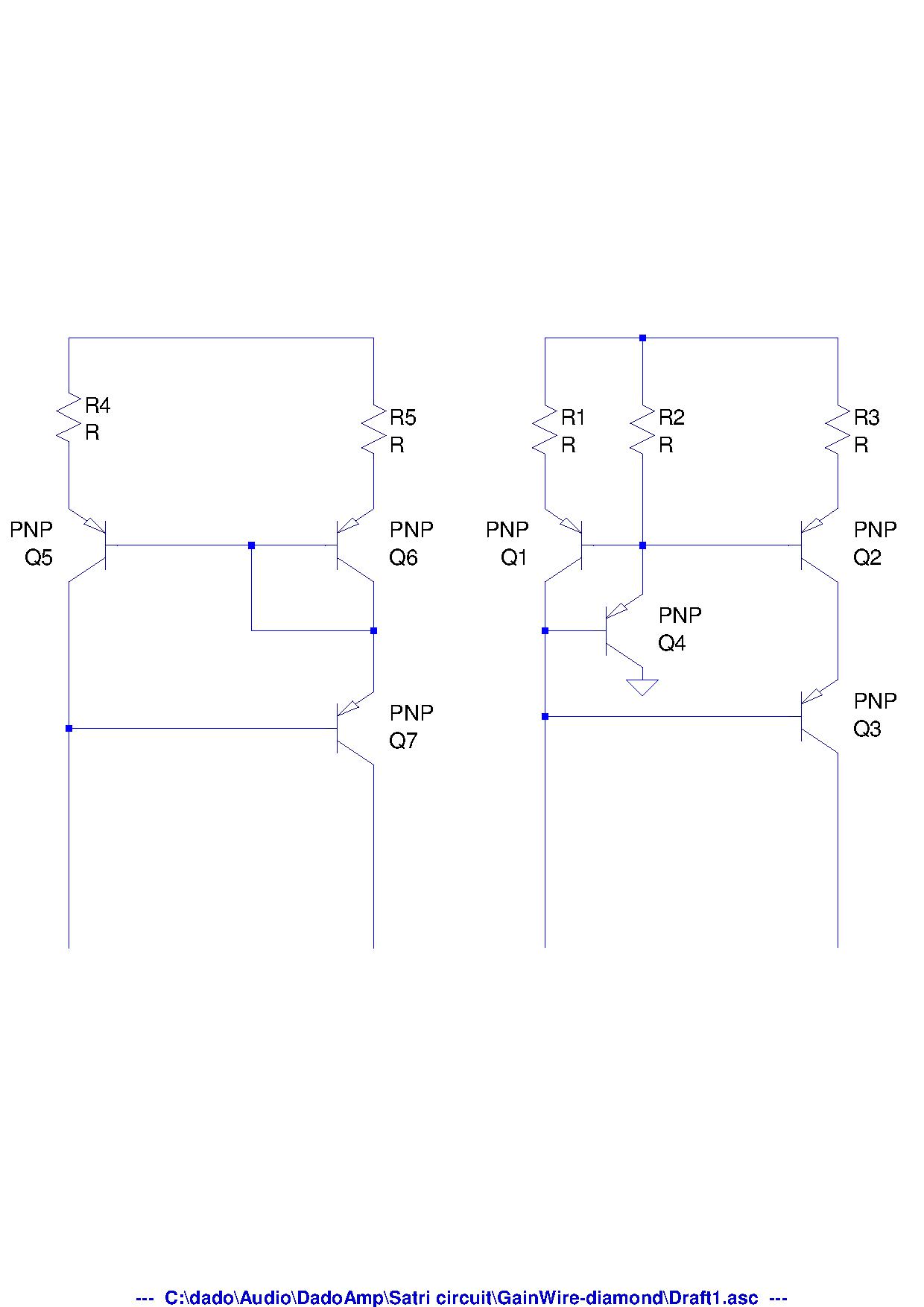

The part of the circuit Im referring to is only the current mirrors. Basically it consists of the EF mirror and the baxandall cascode. This is protected by US and EU patents, held by texas instruments. I cant recall the number but you can google it. I think its named ultra high output impedance mirrors. Part of the reason for the ultra low THD of tpa6120.

I remembered now that I have that OP and I used it some years ago. Data sheet says that it is current feedback amp and there is no internal circuit diagram. I was thinking that I use Baxandall super pair, why do you call it cascode?
BR Damir
In a wilson mirror the third transistor is a cascode, here you have the same setup except the transistor is composed of two parts, the output impedance is bettered by around 8 times (compared to single cascode mirror) that is using the EF part in conjunction.
Its the cats meoww of mirrors.
The most interesting option realy is no feedback around output, but distortion of that buffer is quite high(0.1%?)
I read that valve amplifiers with much higher distortion than that are popular for their good sound. I have a SET which sounds good and I'm sure it's distortion is higher than 0.1%. If you can make the distortion profile 'acceptable' it may sound good despite the lack of feedback. It may not sound as clean and accurate but there are many customers for warm and lively.
First picture is wilson mirror and Q7 is a cascode, right?
Then next picture is a mirror I used (here with no super Baxandall) but there is Q4 connected on other side from a cascode transistor so it's not exactly wilson type. Use of Baxandall super pair should not be protected with patent if used in a current diferent current mirror, I expect. A current mirror I am using, I suppose, is not the same Texas Instruments patented?
By the way Q4 lowered distortion(don't remember how much) in my preamp.
