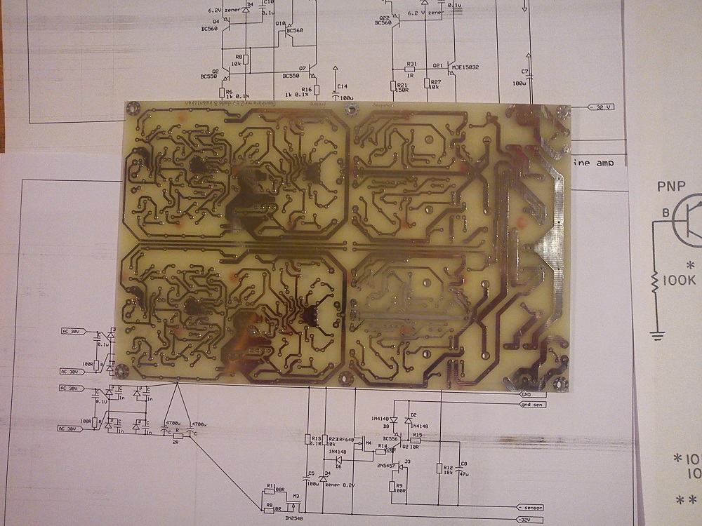

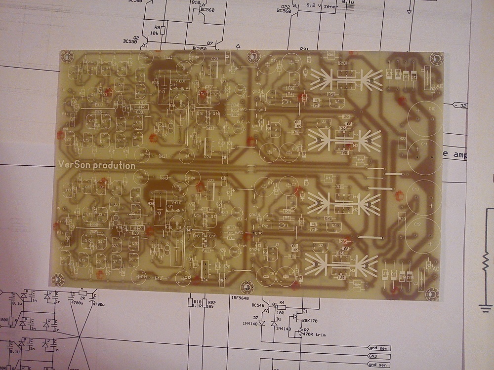

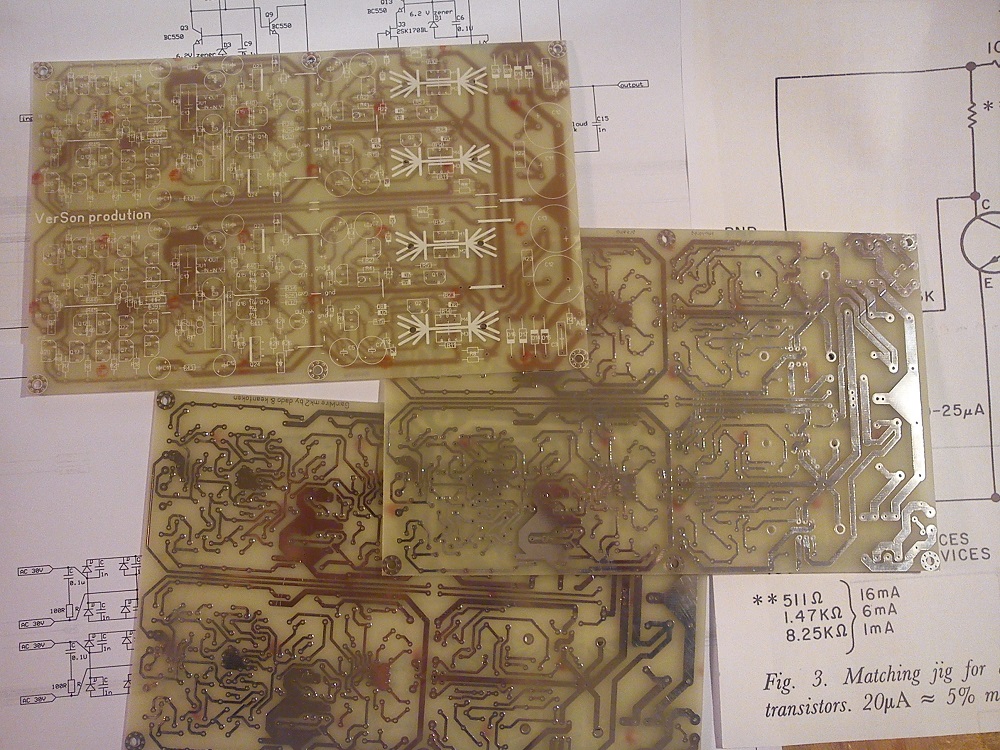

Today I received three boards, now I have to assemble one and test it.

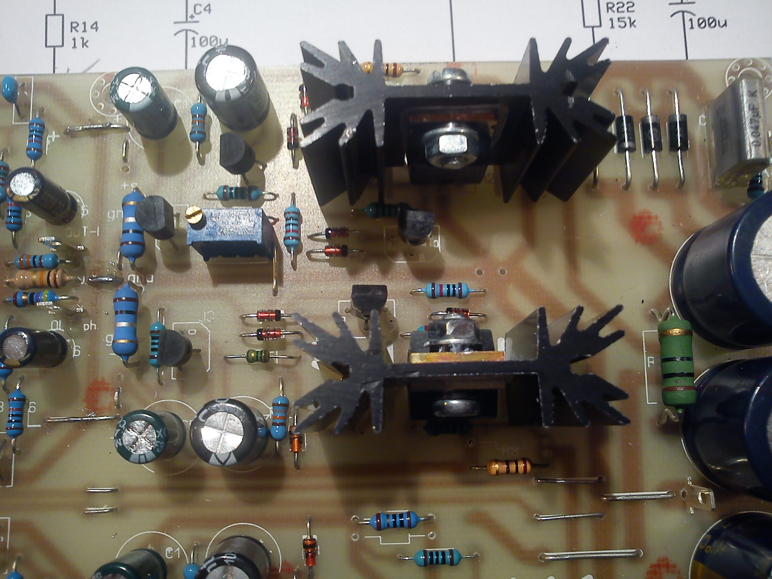

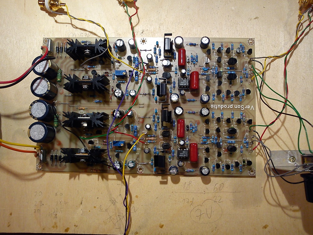

Some progress, slow. I've found layout errors in the shunt regulator part so far. That was easy to correct directly on the board, and one shunt regulator is working.
BR Damir

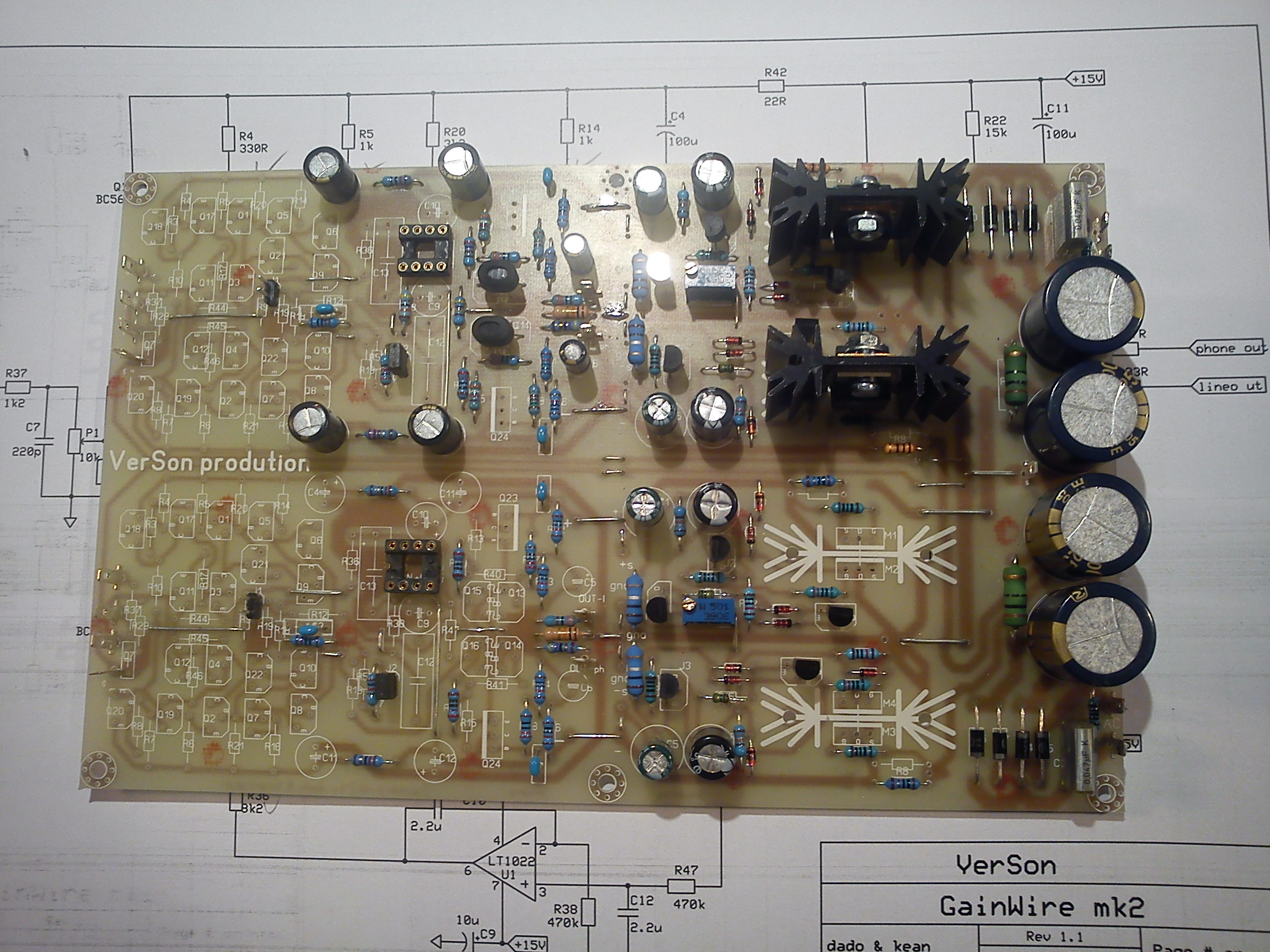

Damir, is this final layout ??
I was looking to see if for the followers of output diamond could be fitted TO220 instead of TO92 in case one wanted to use the circuit as a headphone amp.
Manso, the follower (output buffer) is cascaded with TO220 BJTs (BD139/140, not yet mounted in the photo) and it was designed to be used as line and headphones amp.
BR Damir
Now one channel is working in NGFB and CFA mode. DC servo is working too with some time to settle, maybe some time delay will be needed to connect output(with relay).

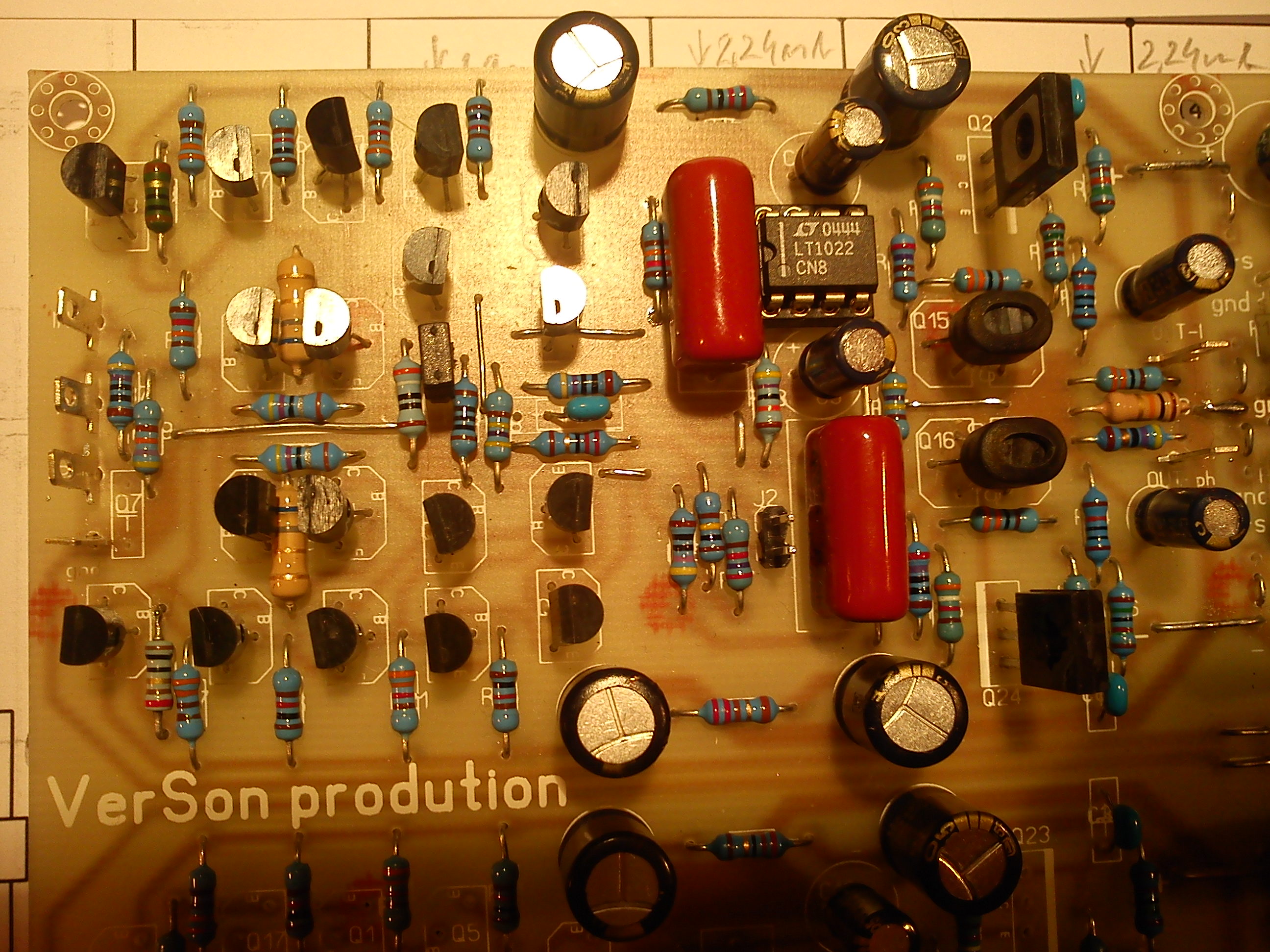

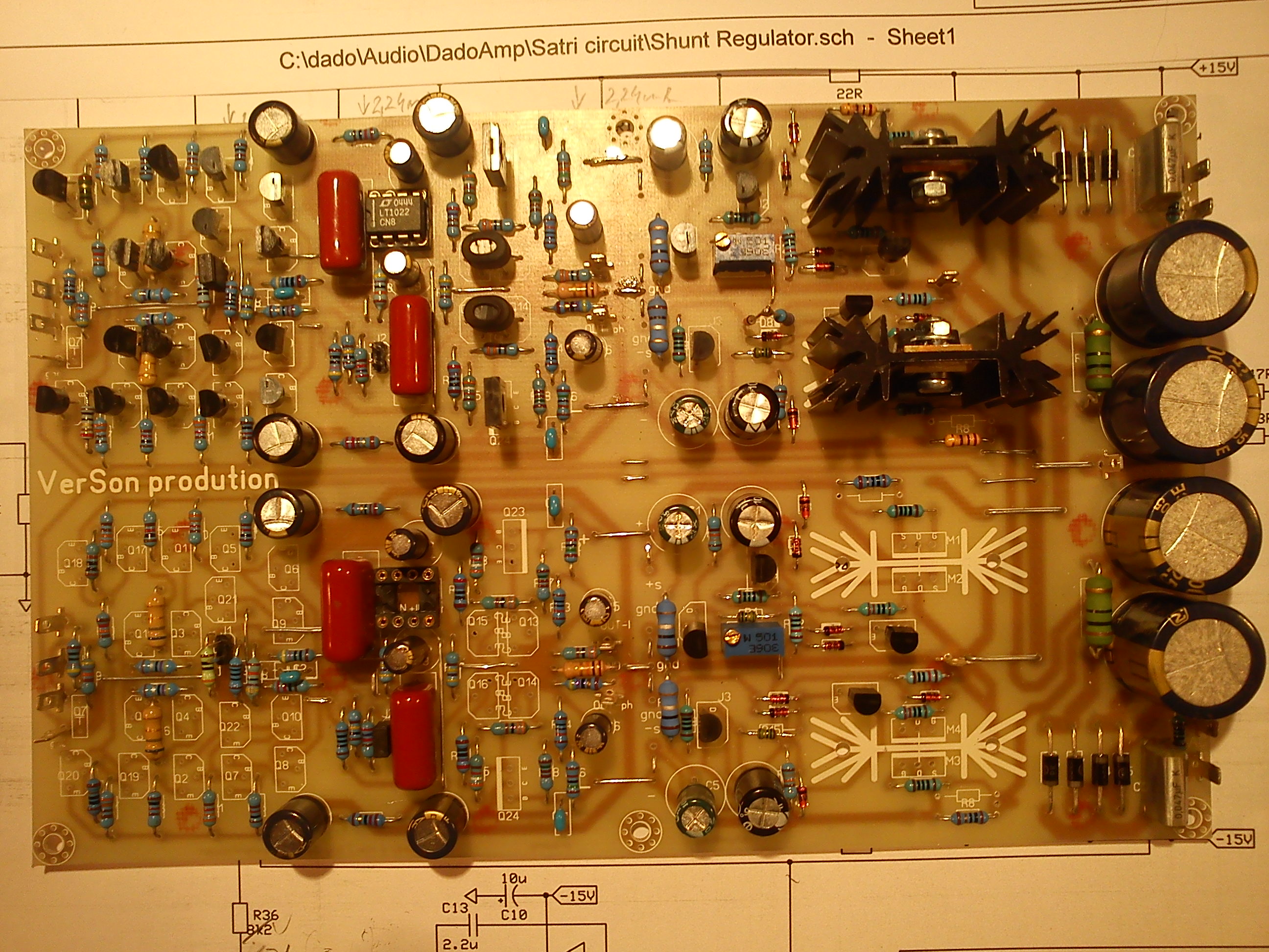

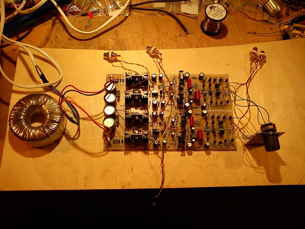

Finally I populated the PCB, and test it with signal generator and oscilloscope. It worked with no visible distortion in both mode, NGFB and CFA.
Now I connected it to DENON DVD 3910 and SENHEISER HD 580 pecision headphones. Beautiful music came out of the headphones. I was listening CD Patricia Barber and some classical music from DVD audio. I was shocked with great dynamics and crystal clear sound, really to my complete satisfaction, I use daily my first GainWire(input JFETs and different output buffer) but this one sounded better, not sure what gives that different gain block(both are current conveyor) or better output buffer. I tried Sony low impedance headphones and it worked equally well.
After some listening trough headphones I connected it to my TT amp and again it played with authority and beautifully. Bass was exceptional, voices very natural, and heights clear.
As a volume control I used Chinese step attenuator with SMT resistors and I think it is quite good, not sure if better (more expensive) attenuator could improve the sound. I was listening in both mode, NGFB and CFA and could not tell what was the preferable setting, probably due to short listening session.
To make complete pre amplifier it needs transformer 30 to 50 VA 2x15 V AC, a volume control and input selector, and a box off cause.
BR Damir
