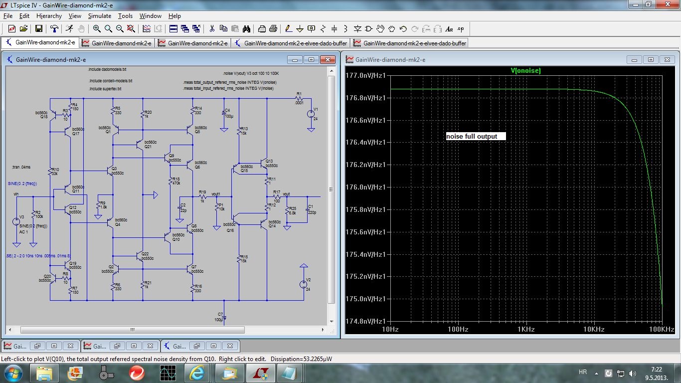

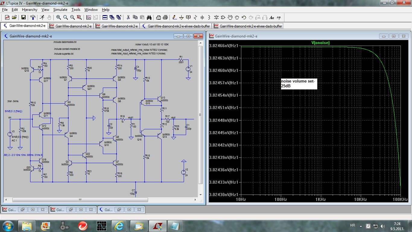

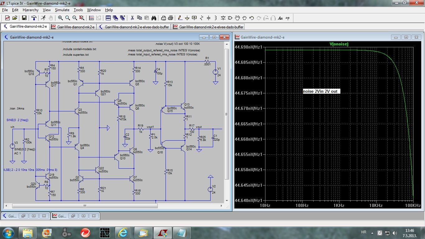

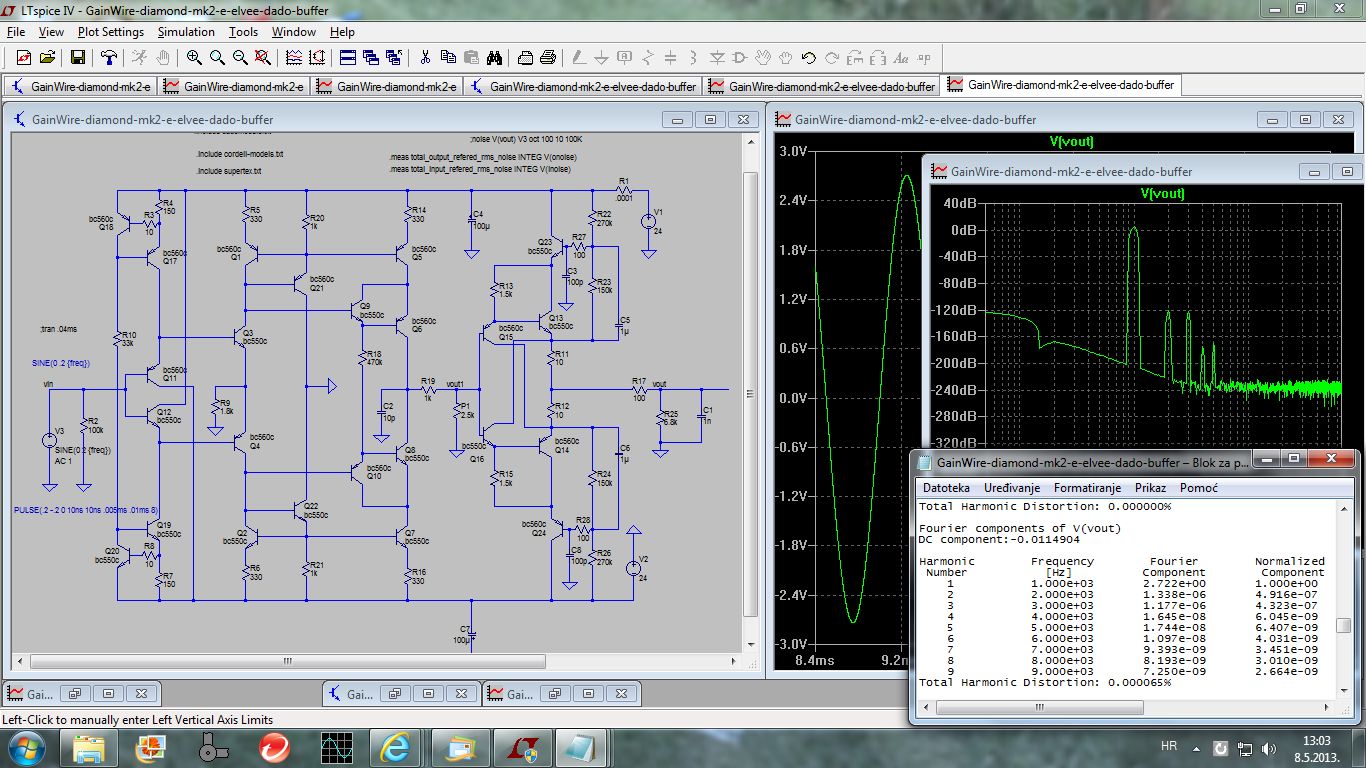

Here is gain simulation with your suggestion and indeed it works, but with a bit higher distortion at 20kHz. Could be that my values are not the best.

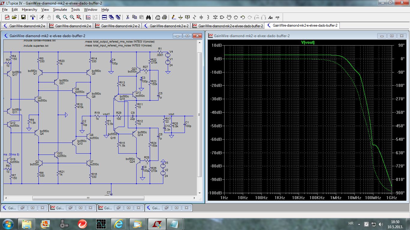

Hi Matthias,
Here is the gain plot without output buffer. First one is without C2 and second with C2.
BR damir
