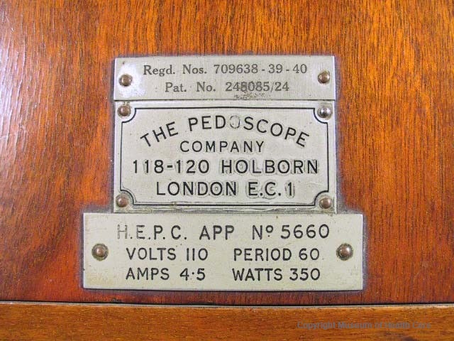

They are now again on 110V - Brexit...Pic ad for GB version of Pedoscope said it was powered by 110V 60 cycles- see below
I thought Britian was 220 v, like rest of Europe? Am I wrong?
Yes, UK is still harmonized with the EU, nominal line voltage is 230V and 50Hz. Note that the UK was never 220V, but was 240V - 250V.Pic ad for GB version of Pedoscope said it was powered by 110V 60 cycles- see below
The picture was possibly an export unit for sale in the U.S. or Canada.

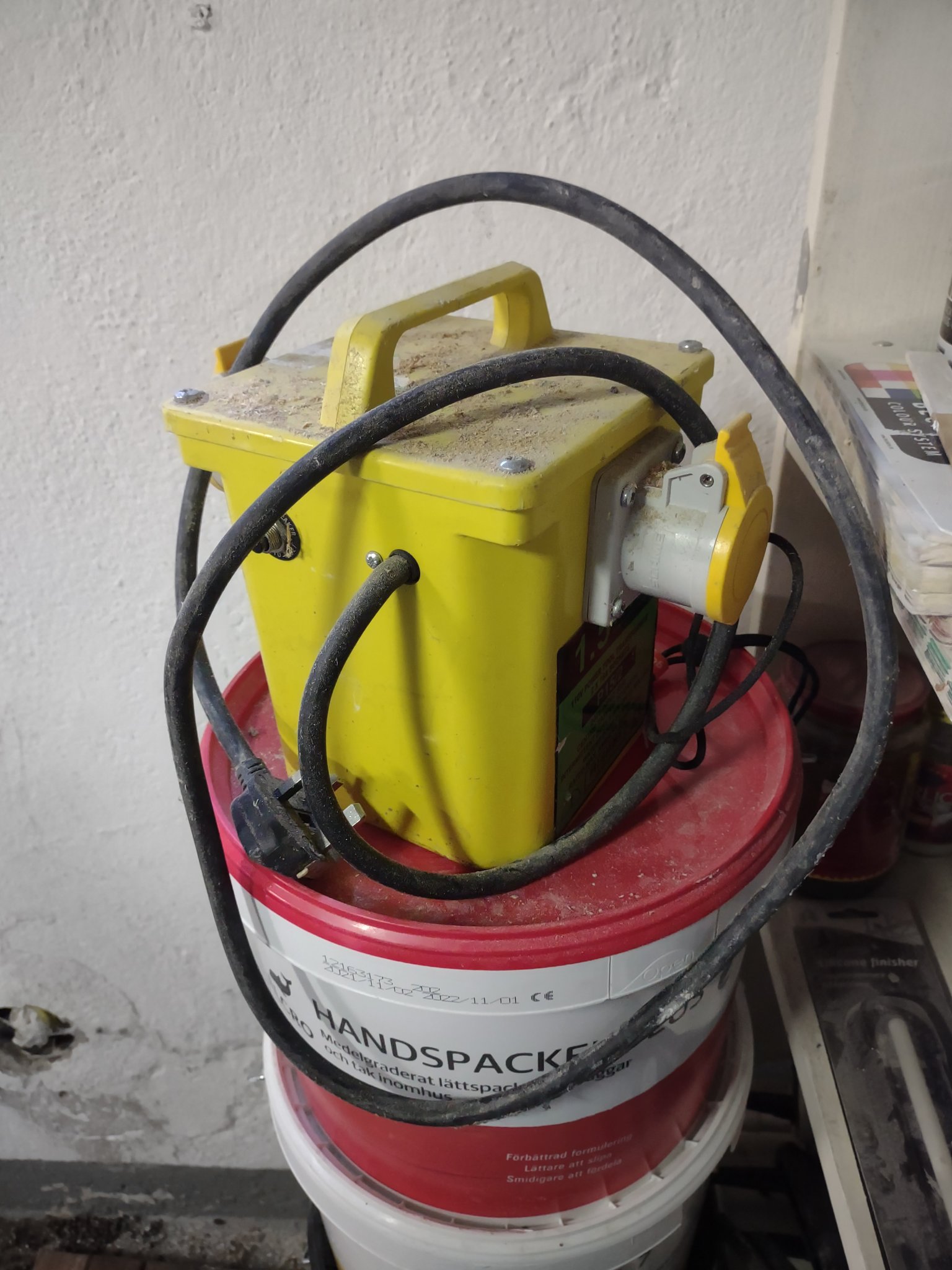

I have heard from friends in Ire, and the UK that 120V hand tools were somewhat common before lithium ion power tools were a thing on construction sites, something about the lower operating voltages being safer - used I guess with isolation or auto-transformers. (not sure)
Interesting. I read Loewy's autobiography years ago and seem to have (in my mind) attributed the Honeywell thermostat to him. It was indeed designed by DreyfussNot by Raymond Loewy but by Henry Dreyfuss. Sorry.
Yes, all appliances used by builders were fitted with universal 3 pin plugs, were designed for 110V, and were used with one of these, which was ubiquitous on building sites until quite recently, I suppose.I have heard from friends in Ire, and the UK that 120V hand tools were somewhat common before lithium ion power tools were a thing on construction sites, something about the lower operating voltages being safer - used I guess with isolation or auto-transformers. (not sure)
Just to keep it weird, that plastic box would not be in code on an American construction site. I guess everybody has their own red lines in the sands of safety. Stuff done in our twenties is terrifying in our seventies, or as Joe Walsh said "It was a lot more fun being 20 in the 70s than being 70 in the 20s".

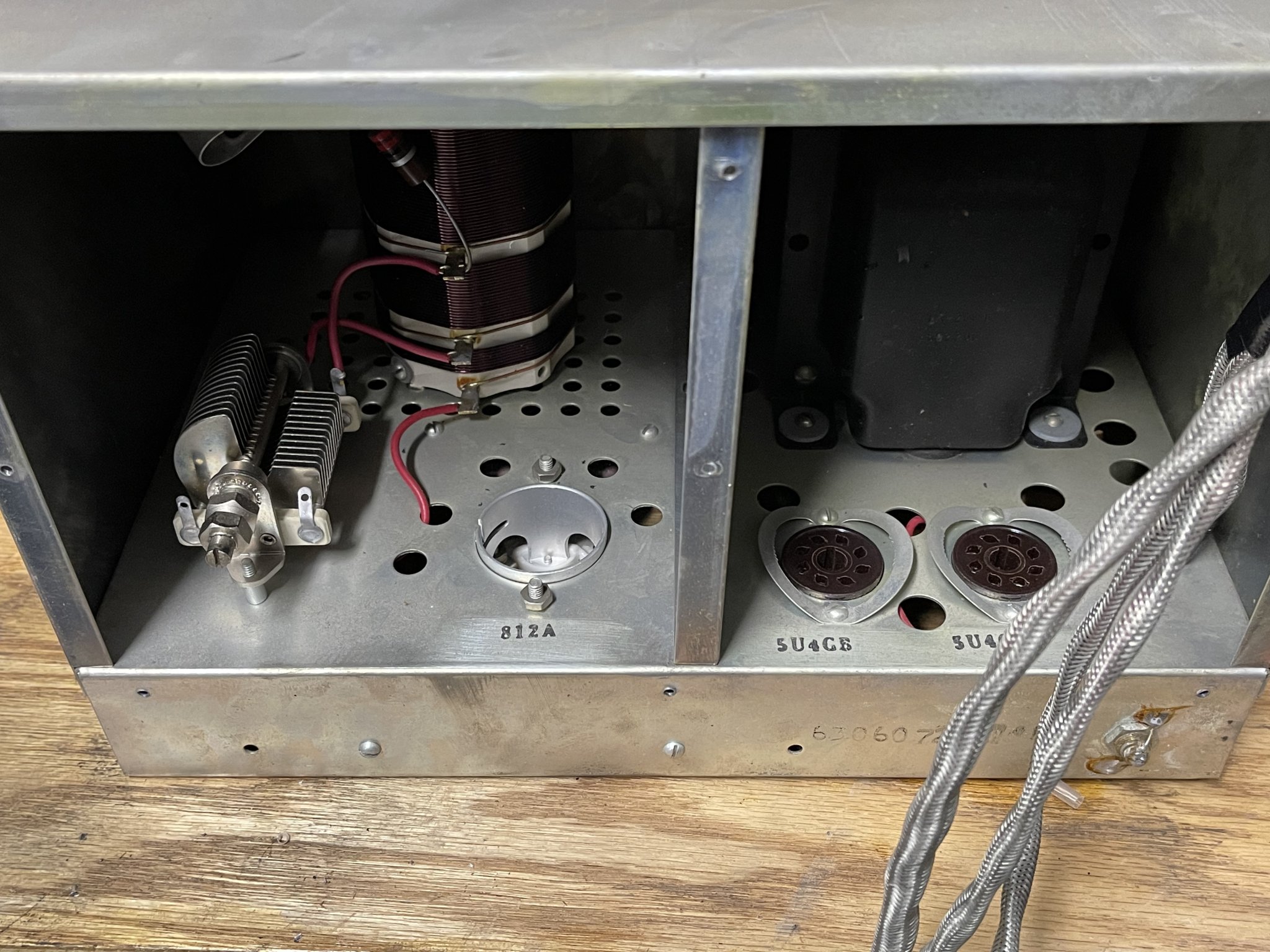

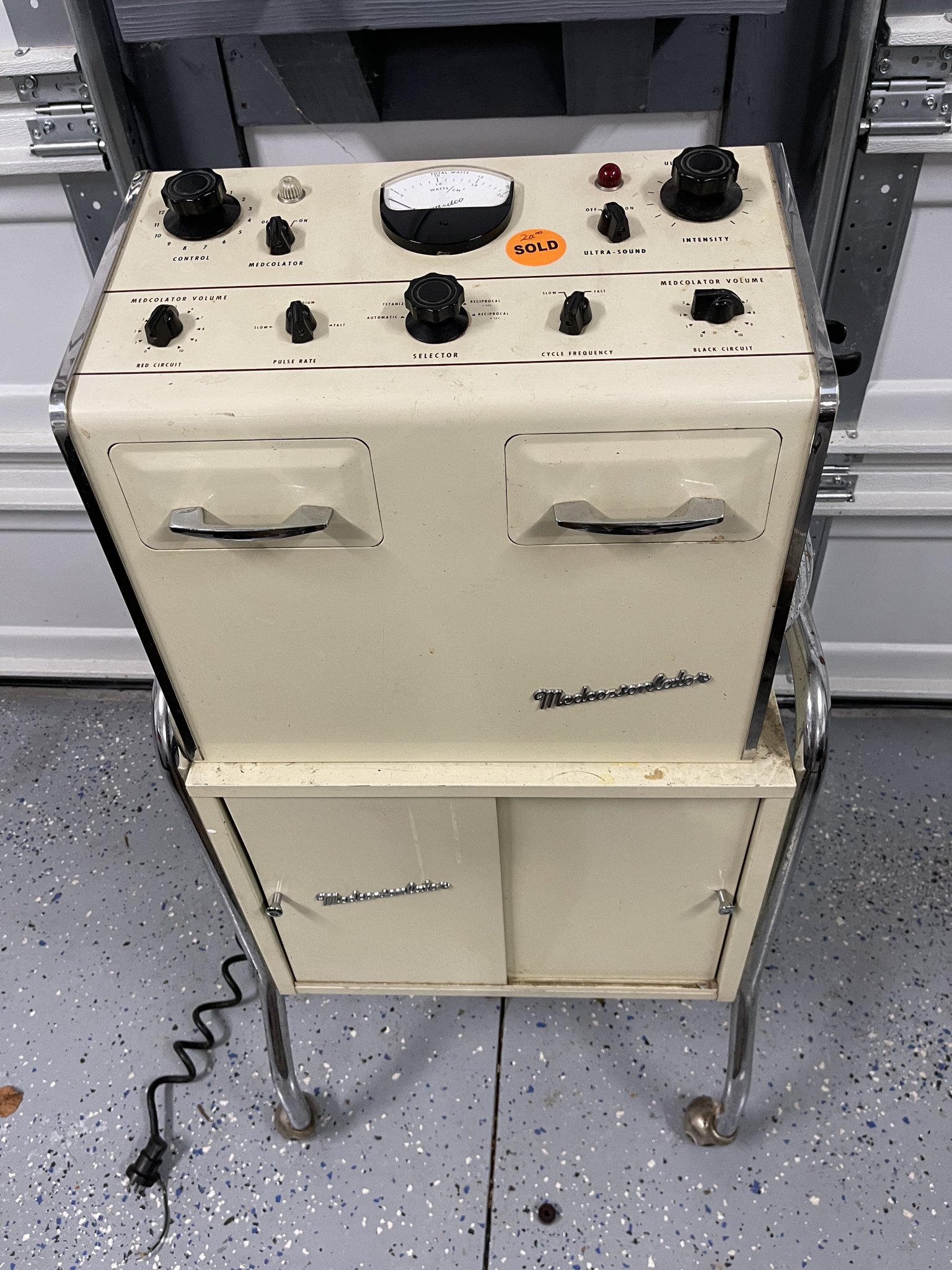

It operated using an 812 transmitting tube oscillating at 1000 HZ. The loads are piezo pads? It was for pain relief.
The power supply had 2 5U4GB's in a voltage doubler configuration. Very weird setup.
Except for the 1000Hz operating frequency it could be a diathermy machine (could it be 1000KHz?).
The Klipsch Museum has a diathermy machine which uses a pair of United Electronics type 311s, probably running on raw AC, but missing its contact pads. Paul's goal was to test it for its ability to dry glue faster, or so the story goes. Didn't work out, in part because it blanked out every radio and television in town, again, as the story goes.

I have all the documentation. I’ll recheck the oscillator frequency. It also had a low voltage supply with a 1619 metal tube doing some kind of duty in there. I have a bunch of the vintage “gel” for the pads free to a good home 😬

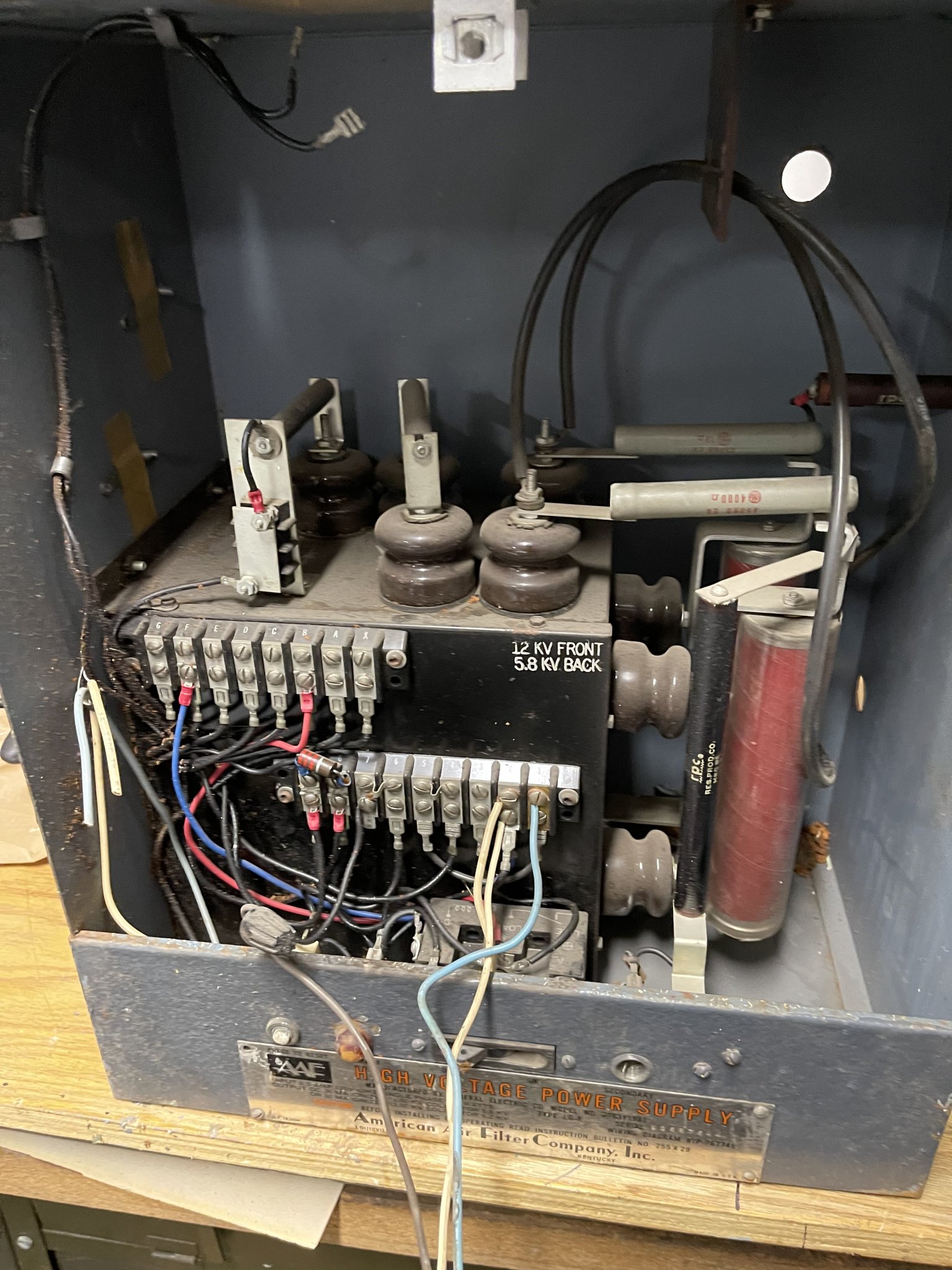

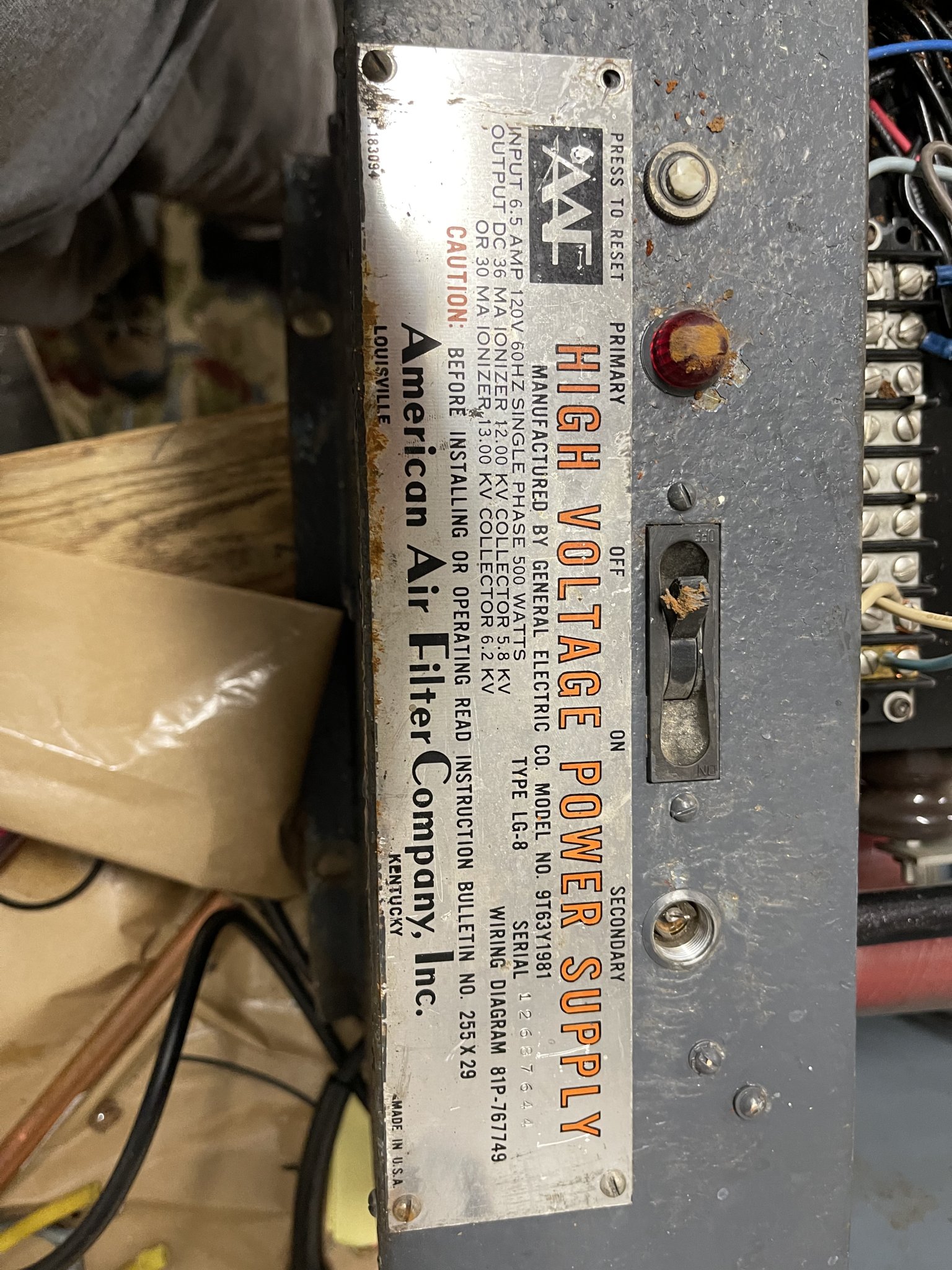

My last oddity was a dumpster retrieval. Was originally part of an electrostatic air filtration system in a very large air handler. Had not been powered up in many years. I have no practical use for it. It scares me just walking by it on the bench. Weighs around 120 lbs just guessing. I may be able to use some of the bits for RF work maybe.
