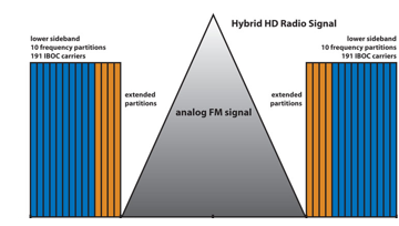

1] The term “HD” in HD Radio does not stand for “high definition” rather it relates to “hybrid digital” technology used in HD Radio.
HD Radio… continued.*
HD Radio IBOC “hybrid digital” technology used today provides the analog FM stream on the same center frequency as before but with IBOC OFDM digital sidebands on either side of the analog broadcast.
Picture 1

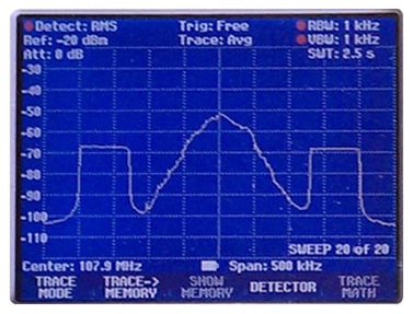

Here is screen capture of a real-world HD Radio FM broadcast:
Picture 2

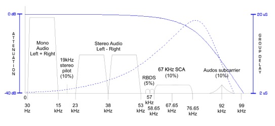

HD Radio Self-noise.
As stated earlier, HD Radio self-noise and increased IBOC power provide for a lively dialog in the industry; read more here and here. Simply put, HD Radio self-noise substantially increases the FM analog stereo noise floor; this is caused primarily by the linear sum and intermodulation of the FM analog FM L+R (sum) L-R (difference) signals and IBOC OFDM sidebands. In most high-quality FM receivers, this means more than a 40 dB increase in stereo noise floor.
In the DaySequerra FM Reference in Wide IF Bandwidth mode this means a substantially decreased SNR: from -75 dB to -25 dB, meaning continuous hiss and white noise on every HD Radio FM station and on most analog FM stations adjacent to an FM HD Radio station.
Back to Basics. Luckily for DaySequerra, the solution to HD Radio self-noise in the 25-year old FM Reference design was fairly straightforward and has almost no side effects: a post-FM demodulation filter designed to remove noise energy starting at 53 KHz and above.
As illustrated below, if the post demodulation filter removes most noise energy above 99 KHz, there will not be any noise energy to translate into the audio band by the FM Reference’s stereo decoder. The challenge here, however, was to preserve the L-R response so that stereo separation was not negatively affected while eliminating the noise above 99 KHz. DaySequerra’s engineers employed a 7th order elliptical filter to maximize the attenuation of noise outside the pass band while minimizing group delay variation.
Picture 3
Recently upgraded FM Reference units have measured SNR of better than -78 dB (3 dB improvement over 25 years ago) and stereo separation of better than 50 dB – equal to pre-upgrade performance.

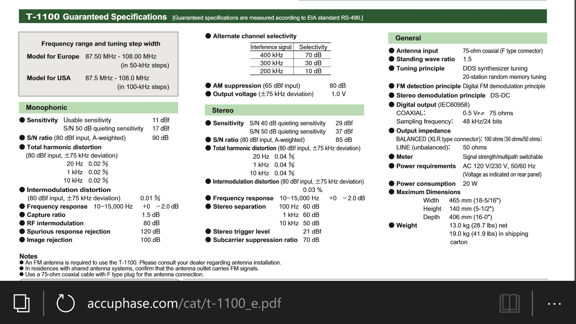

Finally, Accuphase specs and links to Dave Hershberger articles mentioned by David Day:
