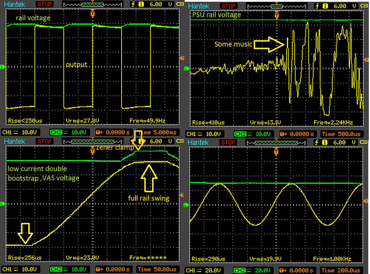

I have tested resistor (high current) and ''zener clamped'' (low current) bootstrap.
The one with zeners have a slightly higher THD at the high amplitudes but it is very efficient and does not need high power resistors (1-2.2kR 0,6W is enough).
Mosfets can swing nearly rail to rail with no problems !!
I think OPS with a few pair of mosfets and double bootstrapped VAS voltage can be a nice killer !! It needs 2 extra zeners, 2 resistors and 2 small 47uF caps.

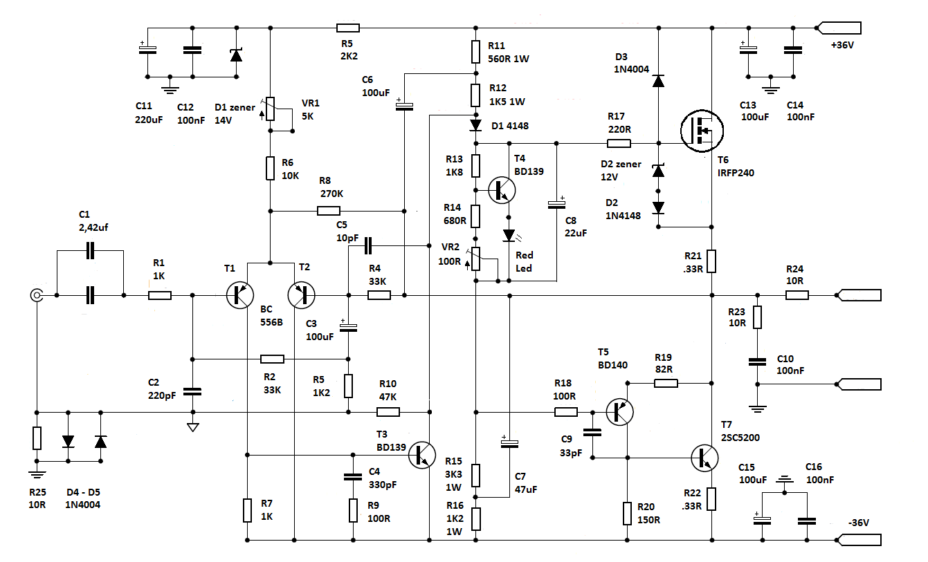

Now, about this double-bootstrap, could it be handy way to maximize output swing with an all-BJT amplifier too ?

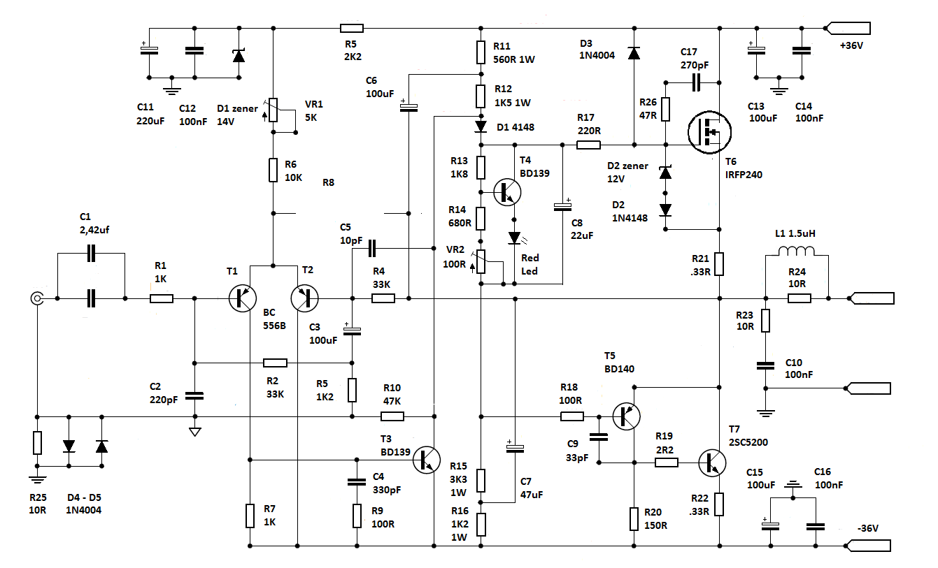

You may be at the point where you need to prototype this and hear the impact of changes because this is the way to fine tune the design.
I try to think of some questions - I like this design,
I would give yourself some provision to tame FET oscillations just in case, an R + C in series strung from gate to drain - i.e. if making a pcb put footprints for these parts but you may not need them. In my TGM7 they were my best friends !
What is the purpose of R24 ? - did you intend to have an output inductor in parallel with it ?
Do you want to have space on the layout for a base-stopper for T7 ?
I wonder how it would sound if you adjusted the topology so that T5 and T7 was a CFP instead ? [i.e. move R22 from emitter of T7 and put in the collector, remove R19 and allow option for a base-stopper on T7]
Perhaps try the sound without R8 (I used this trick once but later discarded it), do you need the zener D1

Hi all.
I need to know what the function does T5, is a buffer or phase splitter? It is to determine the value Rc and Re.
Thanks.
Thanks.
Hi all.
Thanks.
The technical term is common emitter amplifier. The output will be an inverted version of the input signal.

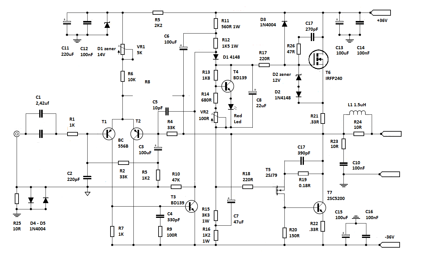

Hi.
T5 is a good idea to be a mosfet?
My inclination would have been to make T5 a bipolar and T7 a mosfet to form a complementary feedback pair and to have given the upper half of the circuit the same treatment.
mjona.
Thanks for your advice. But the idea is just to make the NMOS - BJT quasi output stage. This idea is being developed in the thread "Very simple quasi complimentary MOSFET amplifier" (Ranchu32).
Guillermo,
The best option, in my view, would be to use the nmos on the positive rail and the npn quasi on the negative rail.
Reasons:
1. When you drive the mosfet from the bottom of a bootstrap it is possible to drive the gate just above (no more than about 1V) the positive rail. This brings the source higher towards the positive rail, maximising the efficiency of the output swing.
2. When you drive a quasi device, you have to use a preceding phase inverter to keep the output from the collector in phase with the source output from the upper mosfet. This phase inverter costs some voltage off the negative rail, limiting how close the output can come to the negative rail. If the bias voltage wrt the negative rail is 0.6V, rather than 4V on a mosfet, you pick up some rail efficiency. In fact you lose about 4 volts, almost as good as the bootstrapped n mosfet.
Combining #1 and #2 reasons it is best to use nmos upper and npn quasi lower.
Ciao,
Hugh
Reasons:
Ciao,
Hugh
