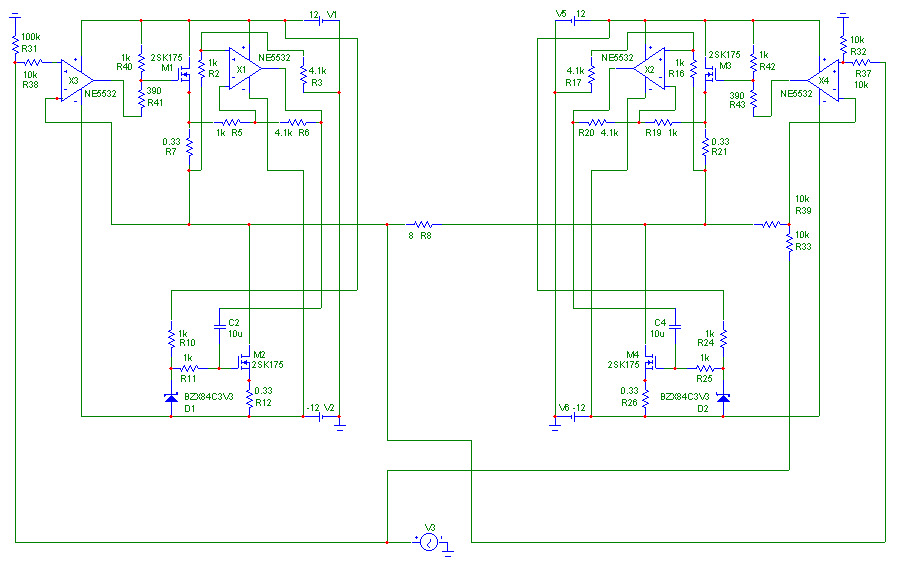

no mercy distortion killer circuit
Nelson,
thanks for your comment, but I would be really happy about your opinion, wether this circuit will work good or not, and why. 🙄
By the way, I tried to X it by 47k feedback from +inputs of op amps to other sides, it slightly decreased the ability to cancel clipping.
For my new vintage spectrum analyzer the smallest detectable signal is -70dB, -75dB with background subtraction.
Is that good enough for amp testing ?
Slightly modifivated schematic:

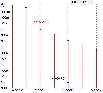

I am using MC7 demo ver. 7.1.6 but it does not matter. The device (2N2222) is part
of small.lib I think. The generator is set for 1k Hz freq. and 5 Volts amplitude, internal res
set to zero. The other quantities are on the schematic.
I run transient analysis on it following the procedure given in message #52 but now I’ll start with
harm(v(1)), that is the generator, and harm (v(4)), the output.
Harm () function
As you can see the distortion components of the generator (v(1)) are negligible ( amplitude <3 pV)
The plot shows a near 5Volt fundamental for v(4) ( 1k Hz component) than we have
2k Hz at 800 uV 3k Hz at near 100uV and so on. Also you can read at 0 Hz a value 14.35 that is
the bias.
So we note, for instance, a 2nd harmonic of 800u/5 *100 = 0.016 %. But the program can make these calculation for us if one use the function ihd ( not thd).

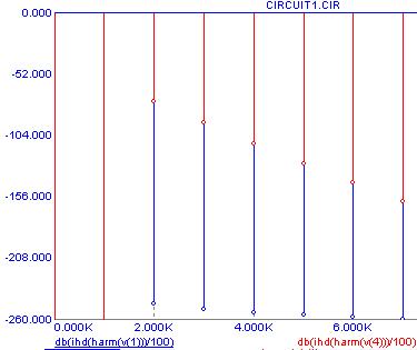

Db(Ihd(Harm ())/100 ) function
remember to divide per 100 before apply db(), that is db(*/100) since ihd() gives percentage values.
This time we have to change the limits of Y-range to 0,-260 and click on right button to unlog the graph. We finish with a top-down graph. The 2nd harmonic of the generator is at –247 db while we found 2nd harm of v(4) at –76db ( that we know is .016% ).

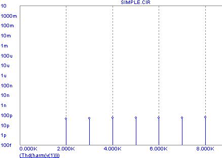

Now we switch from individual harmonic distortion to total harm dist. With the function THD(harm())

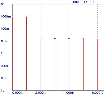

Thd(Harm ()) function
We, again, change the value of Y – range to 10, 1u and click to LOG graph.
In this case we have a series of quasi equal line owing to the small high components.
At 2k we find, as before, 0.016 at 3k 0.0161 that remain constant. This is cumulative distortion relative to the first N harmonics. For N great, in this case for instance 10 (10k) or 50 (50k) we have total harm distorsion.

Here is the result: Distortion across load: 17dB better performance with error amp compared to left amp alone.
I also tried feedback to the other side, not so good in this particular case.
Higher bias on the right side gives better results...
Swapping NE5532 to opa627 changes nothing.
I will try to improve it further.
Bernhard
Note: Adding black to green gives red
Blue is sine source
Red is voltage across load

The X circuit was inspired by Escher's print of the two hands
drawing each other.
Bernhard, I appreciate the efforts you make, but your
designs are too convoluted for me to wrap myself around
them in the limited time I have to play. I don't know whether
they work well or not.
My circuit AI (Continuity) doesn't want to look them either,
for reasons that are beyond human understanding. 😉
