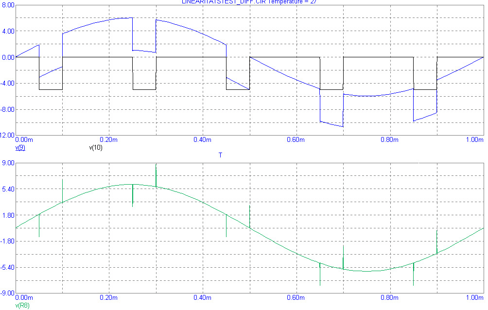

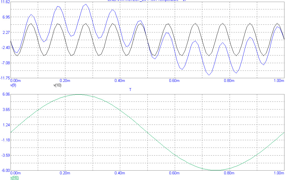

efficiency of this circuit in cancelling distortion
Some calculations:
My calculations say that the distortion of this amp will be zero
Ok, ok... 🙄
I assume that the % distortion of an output stage will not rise or fall with output voltage.
The new circuit has a right side output of 0,25mVpp for 10Vpp left side sine output.
The correction signal is 92dB below the output signal.
So the error part of the output signal of the output stage is -92dB. In the sim world of course.
The distortion part is 0,000025 x output signal.
If the output signal of the right side amp has to be 0,25mV, the distortion part newly introduced will be 0,000025 x 0,25mV = 6,25x10 -9 V
If the error correction is 100% and it should be like that, except of course for the new introduced distortion, the total distortion of the amp will be -184dB.
I do not know if the calculation is right, I am very weak in math, but if both output stages are of the same type, the total distortion -dB of the whole amp will be double.
So because the ideal matched parts in the sim world do not exist in the real world, lets say the real world distortion of one output stage is -60dB, the resulting real world amp distortion will be -120dB.
Conclusion: I believe that the circuit doubles the signal to distortion ratio in dB
P.S. The op amp used is NE5532...

Bernhard,
At least one flaw in your reasoning:
Although the voltage output of your correction amp will be low, the current output (or capability) will be as high as the current output of the main amplifier. So, I think it is a mistake to assume that the distortion of the correction amplifier wil be very low. Let's assume for the moment that the main amplifier is perfect and has no distortion at all. The correction amplifier should then have zero voltage output (since there is nothing to correct) but how capable will that correction amplifier be to keep its output dead quiet while sinking and sourcing the complete load current?
A second source of error is all the noise the correction amplifier will add to the output. OK, this will be small, as it is from the main amplifier, and because the noise of both amplifiers is uncorrelated it will only add partially. But still it will keep you from signal to noise or distortion ratios anywhere near -184dB. But this is just academic. Distortion will be far higher than noise in a power amplifier.
Steven

Hi Bernhard,
It seems to me that you are simulating with Micro-Cap.
Why don’t you make distortion measurements
with thd(harm(v(R8))) or the like?

Hi Federico,
what does that tell ? Why is it so high in the positive halfwave ?
It is without clipping. With clipping, max. is 82m
A SE classA X circuit shows max. 60m and my SE classA X circuit with floating ground driven by A/B amp shows max. 120m.
All during positive halfwave.
Greetings, Bernhard
Greetings, Bernhard

I usually plot a transient analysis before doing anything else. If it doesn't look like a sine wave, no mater how small its THD is, it is NOT a sine wave.
this looks ugly
Want a transient analysys ?
Here it is:
I connected a 5V sine source between left output and load to simulate heavy distortion/modulation of the left output stage.
The sine source is not inside the feedback loop of the output stage.
Black: Error output, blue: left output stage, green: Voltage across load.
5V square,
The gaps of the spikes in the green curve (voltage across load) are 0,63µs.
Seems to work rather good, eye ?
The question for real life is:
Will the distortion of the error amp depend on output voltage or output current ?
Will the distortion of the error amp be smaller than that of the left side ?
How much will distortion be reduced ?
