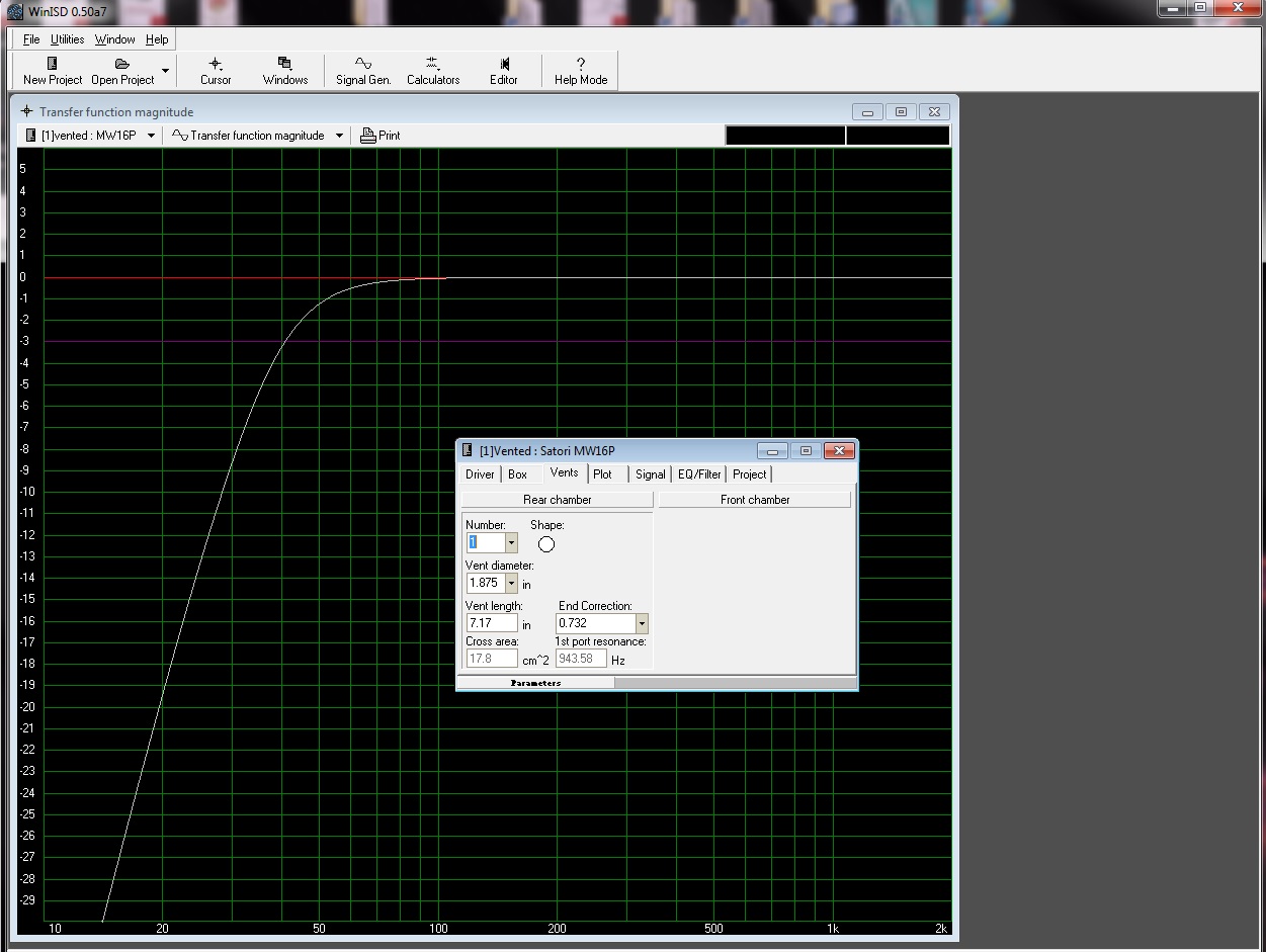

Anybody want to give a SB Satori MW16P-8 a go? I have the .75 cu. ft. PE curved cabinet, 1.875" ID or 2.375" ID port tubes. Just ballpark curves, F3 in the 40's maybe?

0.50a7 will run in Win7/64, but it won't close without going to the task manager. Looks like f3@41-ish Hz.

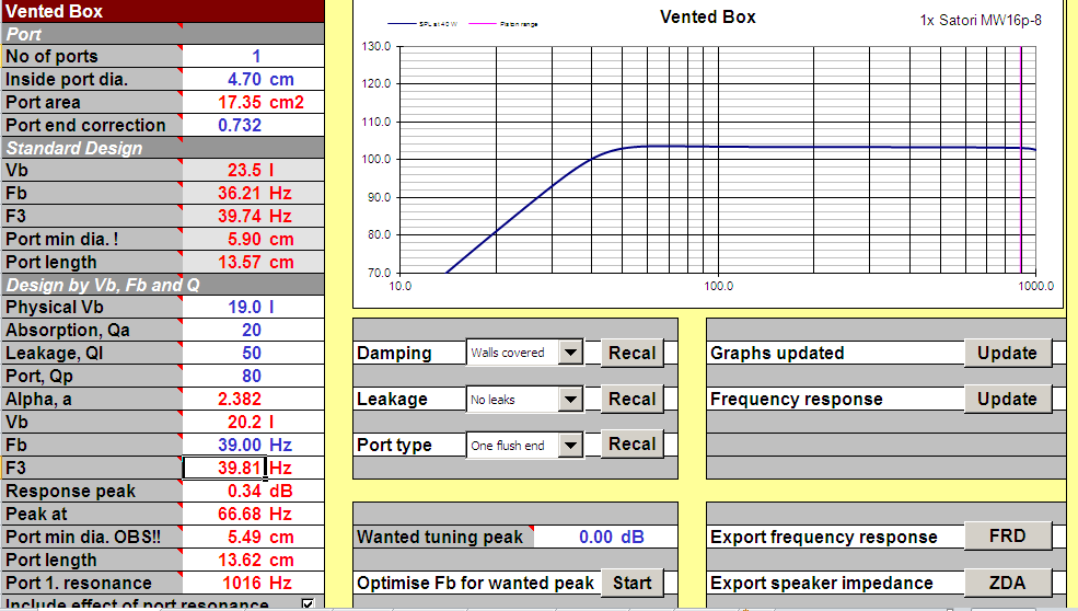

If you have excel you could try unibox it is my preferred modeling program.
Tony.

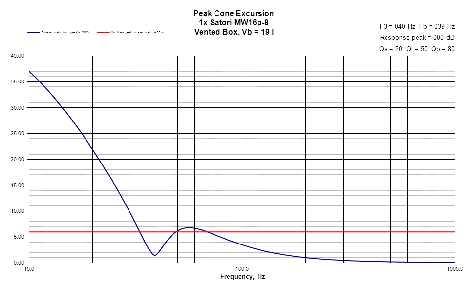

Just modeled in unibox 19L (subtracted a bit speaker crossover etc) and 39Hz tuning with the small port. Doesn't look too bad. Details attached.
The small port will probably give wind noise if pushed though. The tradeoff with the bigger port is a bigger and lower port resonance.
excursion plot shown for 30W.
Tony.
