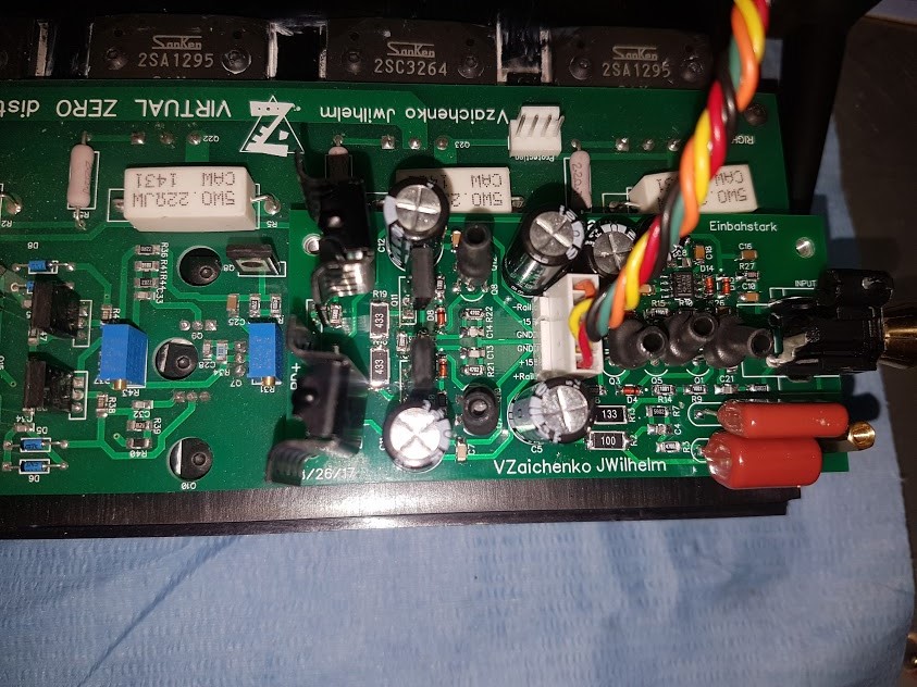

Hmm, are you looking at how the amp is wired vs the recommended use as shown by THAT? Maybe I am dense, please show me if I am not seeing this via a diagram. But according to amp schematic +/- Diff input are connected to Vbe multiplier to handle bias. The +/- sense pins (normally tied to output via 10uF cap) is *not* connected to output but instead are tied together and actually are now the input audio signal. Yes, it goes through a 10K but that's just like an input series resistor (not in feedback path), so where's the feedback? It's the "input" now not connected to the output at all.
Edit: ok, I think I see what you mean now after studying it carefully. The 10k from each out to the -Cin is the feedback?

Right - those two 10K's are the ones.
The gain of each inverting amp is 2x or 6dB. In the fig 2 (post #80) the 10k between Dout- and Din+ in combination with the 5k input resistor appear to set this gain. This may also be why the data sheet says the device should be driven from a low impedance source. Another pair of feedback loops.

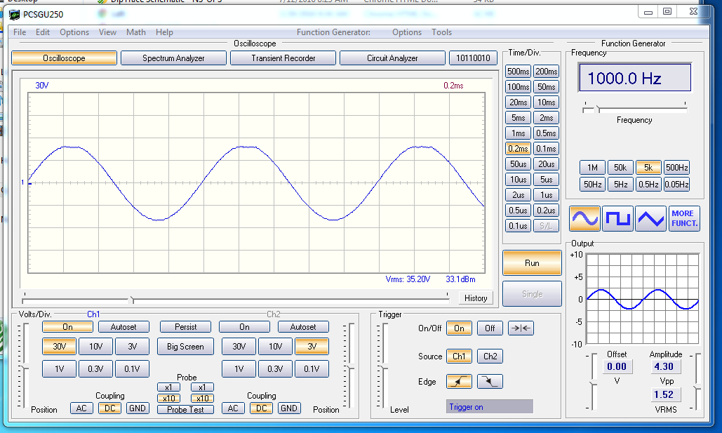

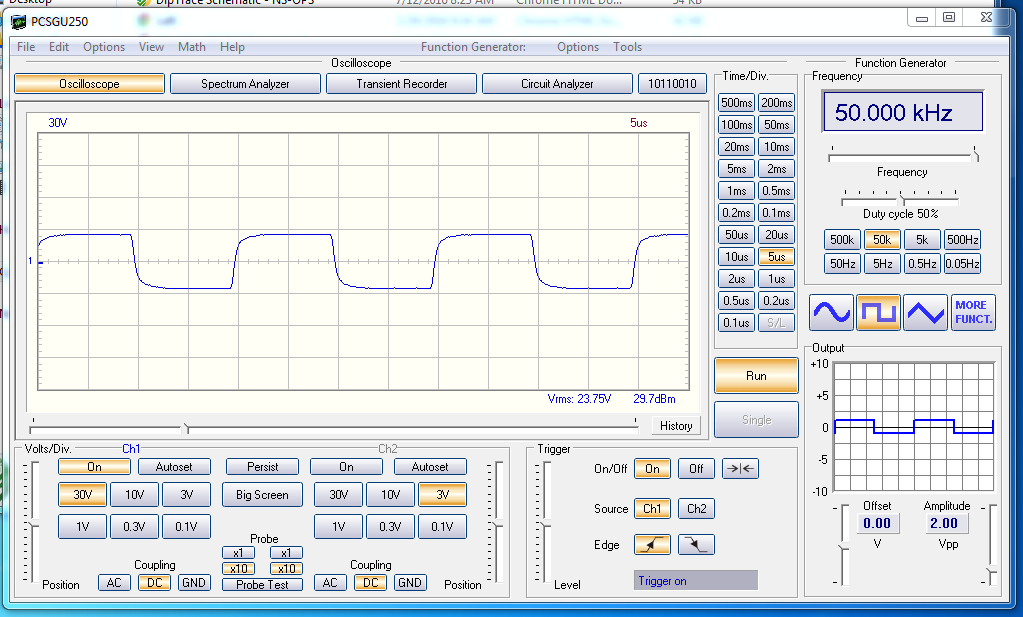

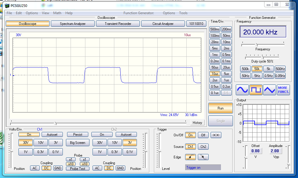

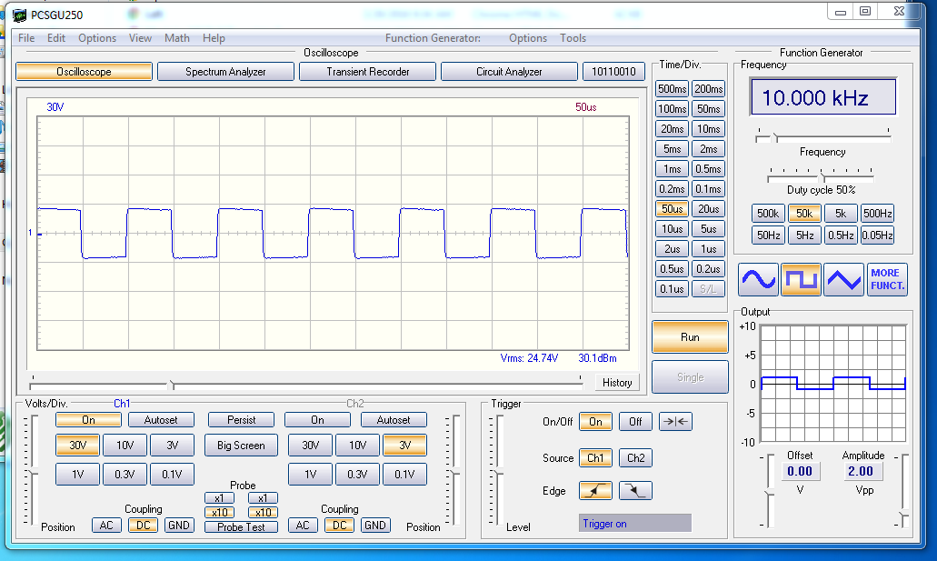

The Einbahnstark input for the NS series amplifiers is running nicely. Here's a test run with +/- 63V supplies. The supply is sagging quite a bit under load leading to 150W RMS output. i'm finding the input is running warmer than I would like so I'm going to retest it at a more civilized voltage.

Valery how is bias is being set on the Einbahnstark.
Why using Laterals as drivers and also the large mosfets load the previous stage badly though increasing the distortion. Can you try using ksa1381 3503s
Laterals as drivers are very good. Mid-power oned - like 2SK216/2SJ79 - may fit even better, however, those are obsolete - rather hard to find.
You would have a "bad VAS loading" problem with the HexFETs here, but laterals are very different - input capacitance is not that high, plus it's linear enough (in terms of the input swing at MOSFET's gate).
ksa1381 c3503 will not give the result good enough because of the driver stage input impedance modulation.
Schematic in post #1 is the front-end only (no OPS showed). The output you see there is a unity gain class A buffer stage for isolating the VAS stage from the OPS input impedance modulation.

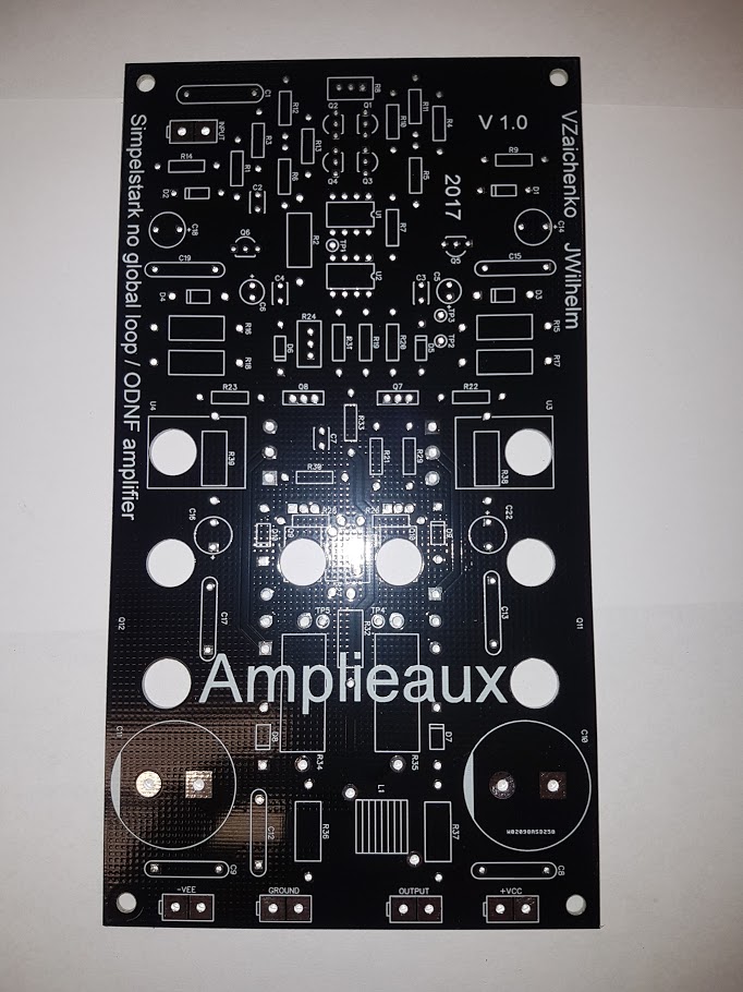

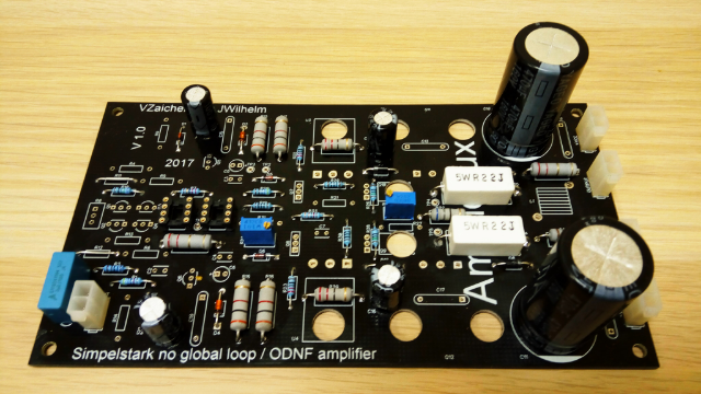

no GNF should sound good now even with lower Output impedance it believe it will sound even better. If you can push the output impedance to another digit down it will be very nice.The first prototype build progress so far 😉
Waiting for some components to arrive.
Looks grat. When you make it work and listen, try to add little feedback around ops, 6-9dB, and listen. To me when was experimenting, adding little feedback around very linear stages, sounds better, no matter if nfb circuit has 0.00X % distortion without feedback.

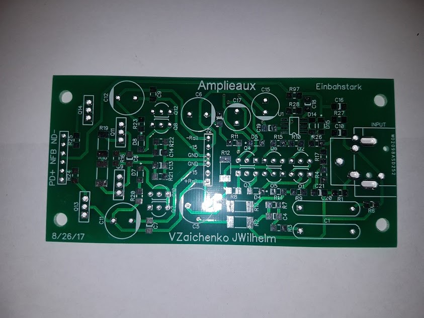

I think that Jeff will sent this new amplifier for test soon.
This is in the package. Valery will send you the latfets for it though, I think my stock is fake.
Fake parts all over the world🙁
