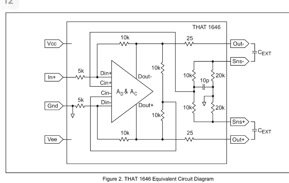

I ran across this rather clever implementation of a headphone amp with a THAT1646 driver. It appears to be zero global feedback.
The usual "inputs" are used to set the bias current. Audio comes in through the common mode inputs.

Hi X,
THAT1646 has got internal common mode feedback, but anyway - a rather clever circuit

I wonder why Wayne Kirkwood called it "open loop Class A"? Reading the data sheet, it indeed shows the differential input has built in feedback. However, that's being used to purely set the bias current on the outputs. The common mode input, I believe does not have internal feedback network - and would normally be connected to the outputs to provide global feedback - but in this case, is used to effect the audio signal drive. The output then drives the output stage and this still does not have feedback into the main input block. Could you take one more look and note how pins are connected relative to equivalent circuit in Fig. 2?
