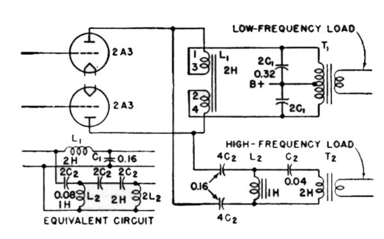

what is shallow XO 6db/oct?
These are 12db/oct for LF and sort of 24db/oct for HF (probably horn unit with compression driver...)
So it is not higher ordrer for LF it is just one element more from 6db/oct
I could not see how this additional passive element producing significantly additional "distortion" as factor in the whole system...
And 24db/oct is good choice for the HF High preassure high db level, to cut out LF part coming into the Horn that can damage the driver.
Yes, 6 dB/oct.
I know that in speaker design most people believe that inductors and capacitors don't introduce sound coloration. But in my experience they do, especially capacitors and iron core inductors. I try to design the whole system to avoid them to the extent practically possible, so a pileup of these elements in a crossover is something I would like to avoid, too.
That is not my situation. I don't use high pressure high dB in a horn. The drivers I described previously have working frequencies of 60-8,000 (mid) and 200-20,000 (high), so can be crossed first order at 1,000 Hz with safety and low distortion.
I understand that Klipsch had no choice with his compression horn-loaded tweeter, but now after 77 years we luckily have better tweeters than that.
