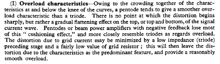

On the plus side, consider improved overlaod characteristics (RDH 4th ed p.563)

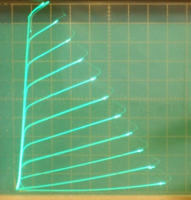

Class A P-P could clear some of that up. Another alternative would be Crazy Drive, pic below. Constant gm but still 1/Sqrt(I) Rp.
A 6V6 would get you 70K to 80K Ohm Rp. Could also use a cascode circuit to get high Rp, could be used with Crazy Drive too ( bottom tube ) for constant gm as well.

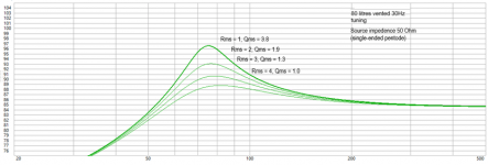

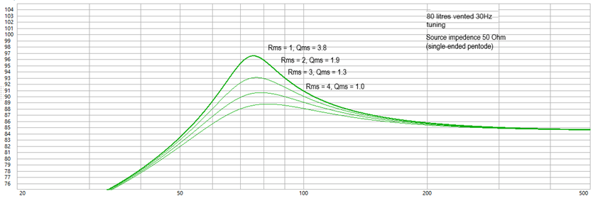

Yes - mechanical damping in the loudspeaker = flattish impedance curve = relatively high Rms = relatively low Qms (less than 2 would be good, can live with Qms=3 as per Pioneer B20FU20-51FW and other such drivers).
Low Qms plus a well-damped sealed enclosure helps control the "bass boom" that is otherwise the characteristic of current driving loudspeakers - the "boom" tends to swamp the audible/measurable advantages of current drive at higher frequencies. The "boom" is modeled below for a vented enclosure to exaggerate the effect and the tendency for lower Qms to reduce the "boom" when driven by an amplifier with an output impedance of 50 Ohm delivering 1 Watt (all other things being equal). The amp and the speaker can be designed to work together - synergistically as they say. 🙂

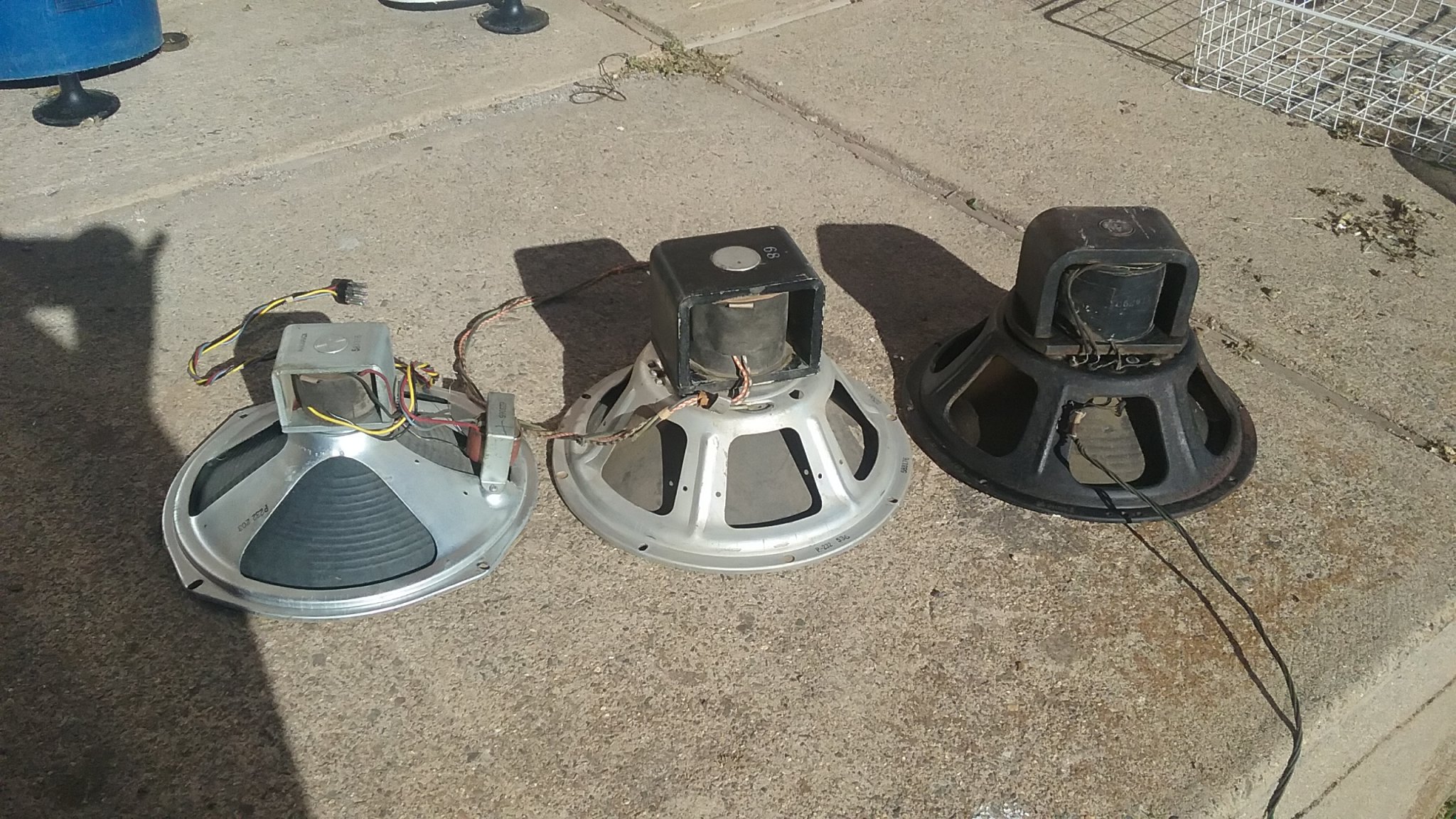

I have to dwell on speakers for current drive at some length. I don' know - it may be inappropriate here, but if I post it on the Speaker forum, it will be sure ignored. But right speaker is paramount for the current drive issue. So, moderators, please forgive me.
Let us play a little game. Here are 3 field coil magnet drivers from the era before boxed speaker's and NFB. They are all 12", rated 5 to 20 W, same nominal impedance, have lightweight cones, and about same sensitivity. The black one has 1.5" diameter voice coil; the two others 1". You are building a "fullranger" speaker to match 5 W amplifier with low DF. Which one would you choose and why?

I've read the bigger voice coil diameter has more "control" but I assume that's pushing against a high DF amp. So I'll choose the center one, because it's got the beefier field coil.
I wonder, in the old consoles these came from, when played loudly; did the field coil make more magnetization, due to more current running through it - assuming of course it sits in series with the B+, in between two caps?
