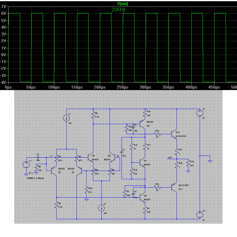

Try this one!
THD 1.19% at 1KHz, +20dB, Av of just below 50, zero global feedback, no compensation, stable. It clips early on the negative half cycle around -29V due to the heavy VAS degeneration.
You must be referring to R7 is a shunt VAS.
This circuit still uses the feedback output of the VAS. Is actually, the output stage is outside the feedback, therefore low damping factor.

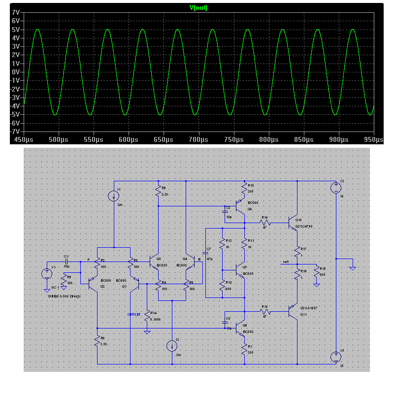

I made more two simulations.
Fig 1
inverting amplifier (no differentiator)
DC component:-0.000769105
Harmonic Frequency Fourier Normalized Phase Normalized
Number [Hz] Component Component [degree] Phase [deg]
1 2.000e+04 4.999e+00 1.000e+00 178.46° 0.00°
2 4.000e+04 3.241e-05 6.483e-06 178.43° -0.03°
3 6.000e+04 4.251e-06 8.504e-07 -81.49° -259.94°
4 8.000e+04 6.206e-07 1.242e-07 -10.77° -189.22°
5 1.000e+05 1.184e-07 2.368e-08 98.46° -80.00°
6 1.200e+05 1.873e-08 3.746e-09 172.05° -6.41°
7 1.400e+05 1.127e-08 2.255e-09 -172.90° -351.36°
8 1.600e+05 8.393e-10 1.679e-10 71.31° -107.15°
9 1.800e+05 1.450e-08 2.900e-09 -18.17° -196.63°
Total Harmonic Distortion: 0.000654%

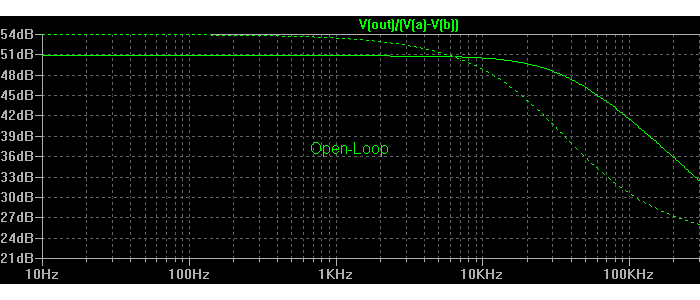

Fig 2 Decreased feedback (30dB loop Gain)
1 2.000e+04 5.328e+00 1.000e+00 -0.97° 0.00°
2 4.000e+04 7.191e-05 1.350e-05 157.17° 158.14°
3 6.000e+04 5.347e-06 1.004e-06 88.94° 89.91°
4 8.000e+04 2.274e-08 4.268e-09 139.44° 140.41°
5 1.000e+05 3.089e-08 5.797e-09 -159.97° -159.00°
6 1.200e+05 3.596e-08 6.750e-09 -178.90° -177.93°
7 1.400e+05 1.248e-08 2.342e-09 -133.81° -132.84°
8 1.600e+05 2.191e-08 4.113e-09 -171.43° -170.46°
9 1.800e+05 3.392e-08 6.367e-09 165.98° 166.94°
Total Harmonic Distortion: 0.001353%

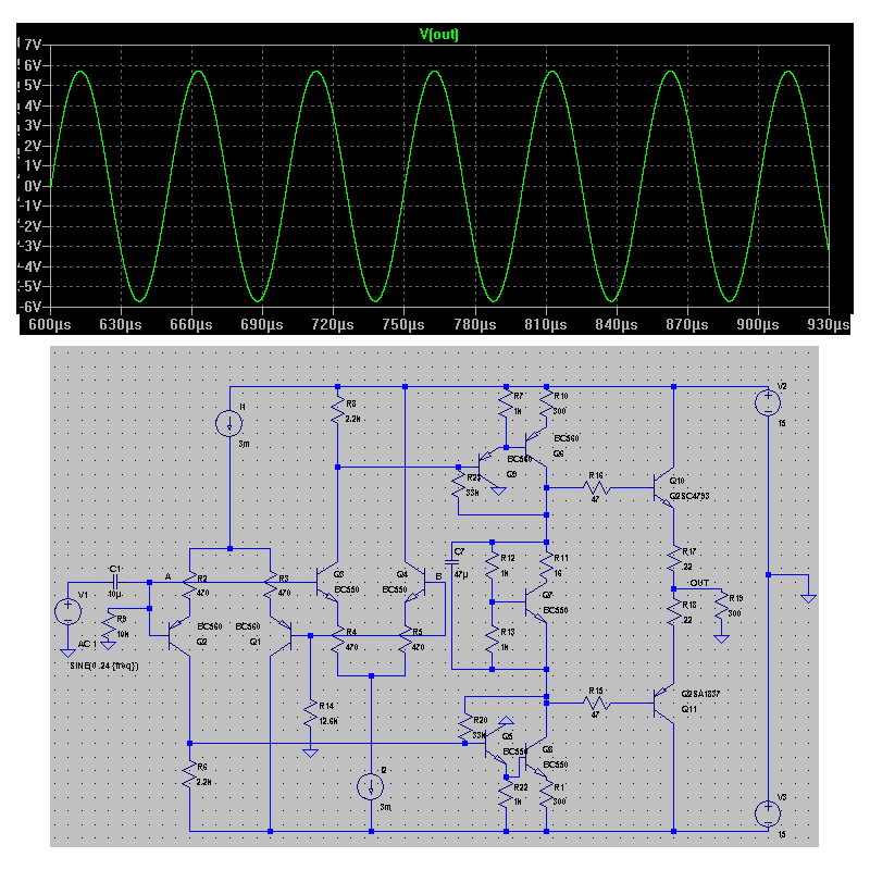

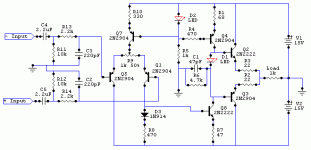

Hi all
With no global feedback, the VAS should have well defined current gain and load impedance. Something like the attached circuit could be good.
Features:
Balanced or unbalanced input
Class A output to about +-20mA
Reasonable thermal stability and PSRR
Good HF stability
Zero global or multistage feedback
No electrolytics
Voltage gain: about 40
Zin: about 10K
Zout: <50R
LF rolloff: about 7Hz
HF rolloffs: about 300KHz @ input, 600KHz @ VAS
Distortion: ???
The transistors shown are just random jellybeans, not recommended devices.
FWIW here's what my sim thinks:
100mV RMS in @ 1Khz => 3.5V RMS out
2'nd harmonic about 0.2%
3'rd harmonic about 0.01%
all others 0.001% or lower
100mV RMS in @ 100Khz => 3.0V RMS out
2'nd harmonic about 0.5%
3'rd harmonic about 0.1%
all others 0.002% or lower
Hmm... not a bad start, distortion needs some work though.
It's something to play with, anyway. 🙂
Cheers - Godfrey

No feedeback amp
I did a double pair symmetric only testing (not optimized)
Gain 64dB
DC component:-0.00727194
1 2.000e+04 5.053e+00 1.000e+00 -49.51° 0.00°
2 4.000e+04 1.656e-03 3.277e-04 -100.76° -51.24°
3 6.000e+04 3.906e-03 7.730e-04 -136.31° -86.80°
4 8.000e+04 2.788e-05 5.518e-06 94.76° 144.27°
5 1.000e+05 5.288e-05 1.046e-05 -59.20° -9.68°
6 1.200e+05 9.266e-07 1.834e-07 165.85° 215.36°
7 1.400e+05 1.053e-06 2.085e-07 18.09° 67.60°
8 1.600e+05 4.502e-08 8.909e-09 -150.68° -101.16°
9 1.800e+05 5.009e-08 9.913e-09 125.68° 175.19°
Total Harmonic Distortion: 0.083965%

You have sure that this circuit works without feedback?
I think that is a discrete opamp
Yes, try it! 🙂
The voltage gain stage has low current gain, about 10, same as your last circuit, but the transconductance of the input stage is much lower.
Also: the gain is low because the voltage gain stage drives a low load impedance (R6 in my circuit). Opamps always try to get high gain by making the load impedance as high as possible.
R6 keeps the gain down and also makes it easier to set the DC offset.
Cheers - Godfrey

Yes, try it! 🙂
Cheers - Godfrey
But the topology simple differential pair, you need to compensate the DC of the VAS NPN, that makes such compensation is the transistor PNP in input pair.
Where is connecting the inverting input?
Small optimizations
Gain 28.8dB
THD 20 KHz 4V RMS
DC component:-0.0029007
1 2.000e+04 5.527e+00 1.000e+00 -3.45° 0.00°
2 4.000e+04 8.850e-04 1.601e-04 81.51° 84.96°
3 6.000e+04 1.375e-03 2.489e-04 53.49° 56.94°
4 8.000e+04 3.024e-05 5.471e-06 -29.22° -25.77°
5 1.000e+05 5.409e-05 9.786e-06 -125.78° -122.33°
6 1.200e+05 2.587e-06 4.680e-07 138.08° 141.53°
7 1.400e+05 2.941e-06 5.321e-07 39.90° 43.35°
8 1.600e+05 1.912e-07 3.459e-08 -58.83° -55.38°
9 1.800e+05 1.892e-07 3.423e-08 -154.67° -151.22°
Total Harmonic Distortion: 0.029613%

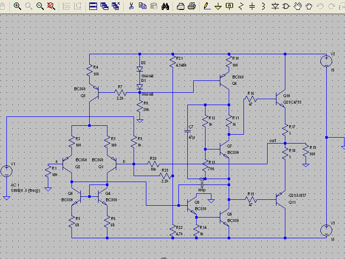

Square Wave no symmetric

Small optimizations
Nice!
Now you have feedback around the VAS to control the gain and DC offset.

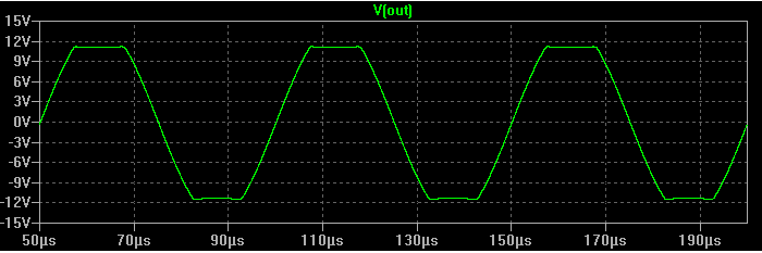

If you use a sine wave and make it slowly bigger, bigger, bigger then you can see what happens.
I think it will start to look like this picture.
After that, I don't know...

Is that there is an asymmetry with a difference of 1V. But was due to removal of the capacitor I was confused, clipping is symmetry.
BTW
Post your simulation, I still do not understand what you did...

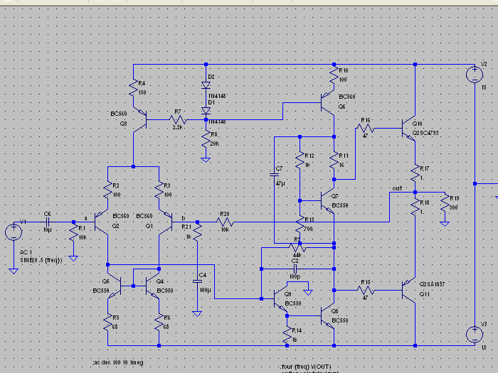

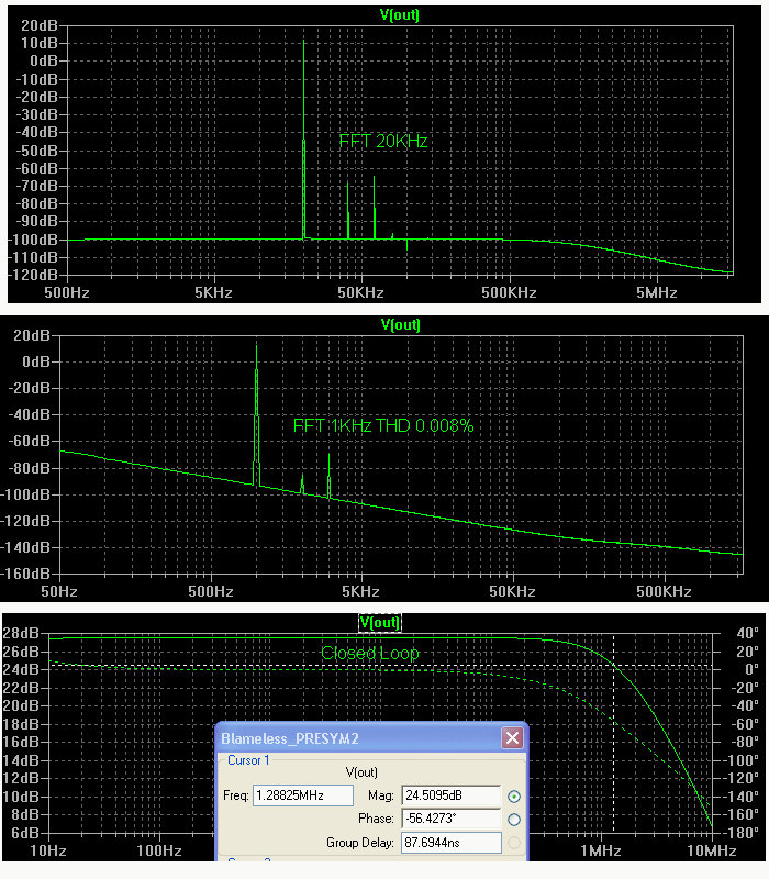

More optimizations, the circuit does not use compensating
DC component:-0.00196752
1 2.000e+04 5.711e+00 1.000e+00 -1.05° 0.00°
2 4.000e+04 5.181e-04 9.072e-05 -13.49° -12.44°
3 6.000e+04 8.590e-04 1.504e-04 52.23° 53.28°
4 8.000e+04 1.036e-05 1.813e-06 159.00° 160.05°
5 1.000e+05 2.154e-05 3.772e-06 -103.14° -102.08°
6 1.200e+05 1.067e-07 1.868e-08 -60.17° -59.12°
7 1.400e+05 8.676e-07 1.519e-07 74.28° 75.33°
8 1.600e+05 3.846e-09 6.734e-10 59.67° 60.73°
9 1.800e+05 4.385e-08 7.677e-09 -107.56° -106.51°
Total Harmonic Distortion: 0.017569%
