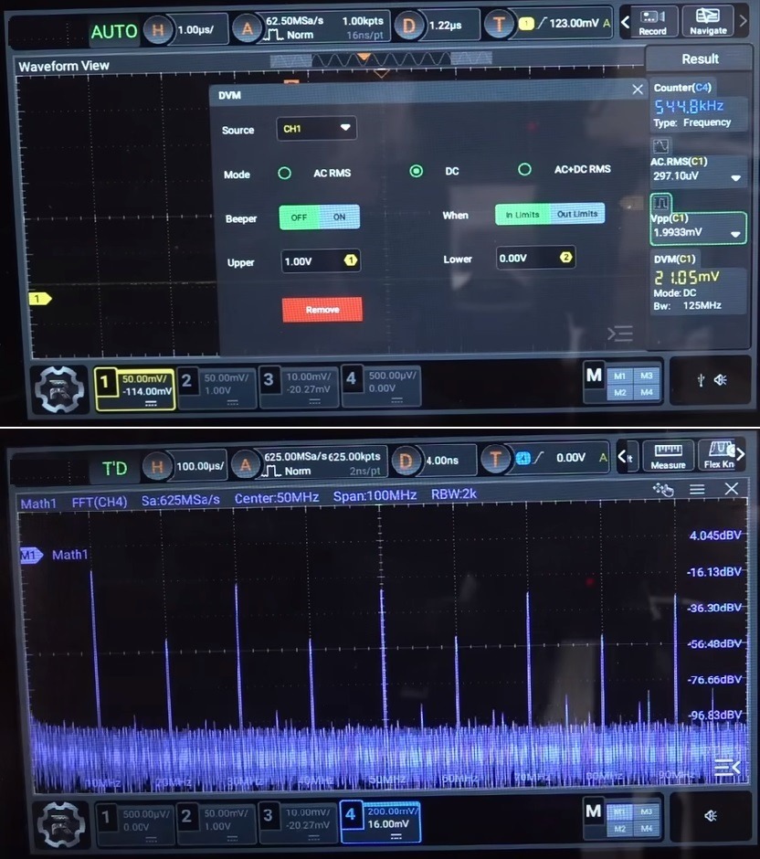

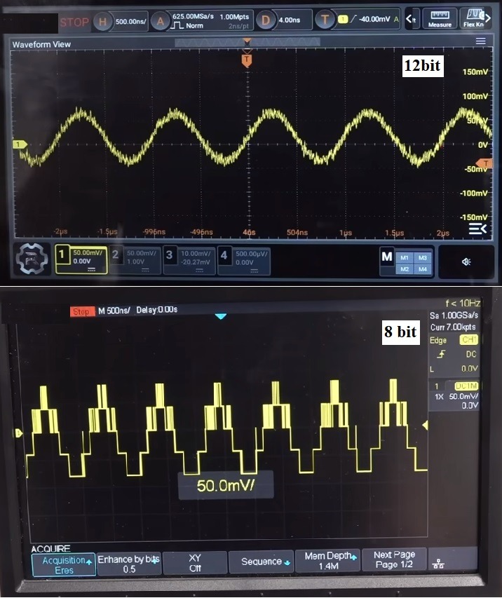

All such manufacturers are true to their spec sheets (specs is a legal binding).
What drives down prices is progress in technology (integration).
Speaking of which, a 100MHz 4ch oscilloscope can be had for 400 USD.
Today with a 12 bit vertical resolution.
This increase in V resolution turns the accompanying functions of a DSO into useful instruments (not just imitations of an instrument)
