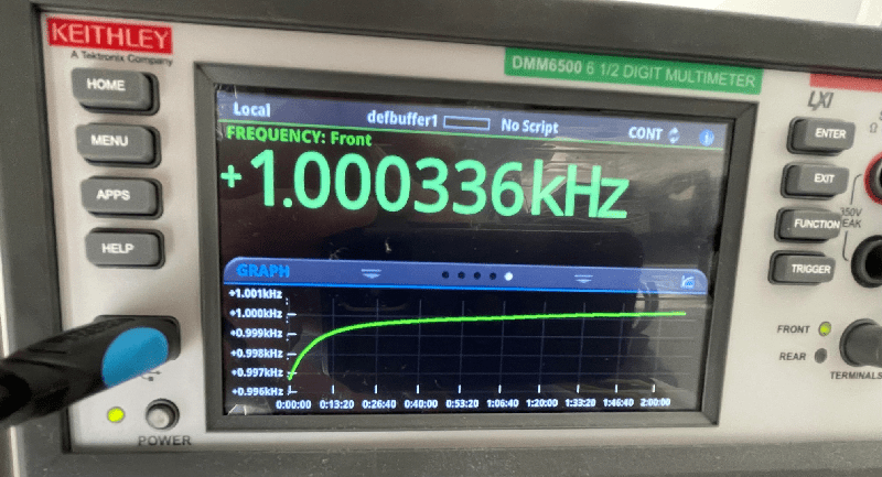

One example: Victor's LDO - frequency change in time (2h) - measured directly by DMM6500 (no PC needed).
