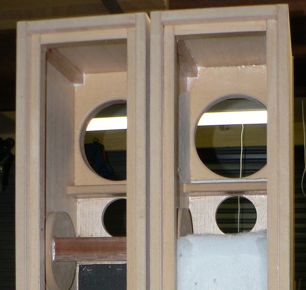

It's been mentioned by others before, that shelf brace arrangement can be a problem. I'm not fussed on the grouping especially directly above the port. If you remove shelf braces you can add cross bracing and corner cleats to sort out panel resonances.

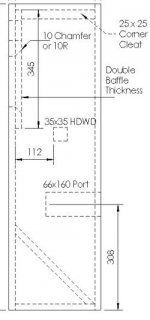

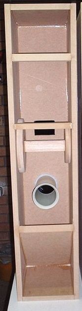

I'm not saying to do what I have in the pic, but I've found this arrangement good in tall slender boxes. The hardwood cross brace attaches to driver cut outs to help with side panel resonances and the lower angled section forms a tapered section to help with box pipe resonances. You can add more cross bracing to suit taller boxes. The baffle has braces above and below the mid woofer as shown by the cross pieces. The pic is before corner cleats are added. This complete arrangement allows damping to hang like a curtain in the middle of the box (not blocking airflow to the port) which is a good method for vented designs and is more effective than damping applied to walls (ref Ralph Waters, Vance Dickason). Further damping is used on the top and in the tapered section.
Another thing to check is the rear of the woofer cut out being chamfered to assist in air flow as well as the entry to the port has a minimum of 75mm clearance to the back of the box and any damping.

Thank you all for the advice, especially rabbitz. Might you happen to have a 3/4 picture view of the bracing? Somehow my mind cannot visualize how the bracing arrangement looks like.
It will be quite a challenge to modify the current bracing, because they are all glued in place and it will be a real pain to get them out. I will definitely take those ideas into consideration for my next project!

Thank you for the detailed drawings, rabbitz! It is extremely helpful, i've saved the pictures for my future projects

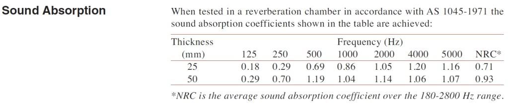

I'm using this particular rockwool type
The sound absorption data is as follows:
The back wall is lined with 2" roxul rockwool, side walls lined with 1" and top 2". There is no stuffing at all. I understand fiberglass wool is generally more effective at killing frequencies than acoustic foam/fill, so i don't know if i'm using too much. While googling around i found other people who reported that fiberglass wool killed off the sound too much so maybe i'm in a similar situation?
At the same time, i don't see how i can minimize the lining even more. Maybe reduce the back lining to 1"? But then i'm worried about not attenuating the backwaves enough.
I did change the lining thickness quite a lot but it didn't seem to make much of a difference, this being the bare minimum i thought was necessary. I guess i could continue tweaking the amount of stuffing but if it's a BSC problem then i guess i should be changing that instead?

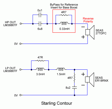

You may want to try 3mH parallel with 47 ohms (10-20 watts). I'm using this in my Seas ER18 to get some mid-bass kick.
The other components are all for contouring. There's no crossover. My speakers are active bi-amped with 18dB/oct electronic crossover.

It all depends on what you're after. For some, there's nothing wrong with tone controls and equalizers but I don't use them because they degrade the sound. Take electronic crossovers. It took me many, many years to develop one that I can live with. Right now, it's incorporated in my Synergy Bi-amp Kit. My crossover is transparent, invisible. I can't hear it. I compared it with my Starling passive crossover and I could hear the passive one. There's this very slight veil in the music.
