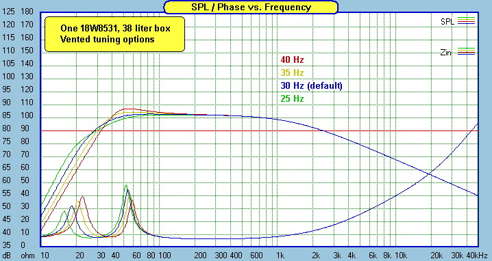

According to the vent tuning options, the port needs to be modified to 3" from the default of 4.75". But i see no way to do that if both flared ends need to be used. If i use only one flared end, then the length will be 2.9" with the connecting ring. Will the lack of a flared end on the inside affect anything?
No biggie as you have flared on the outside which should slow the velocity enough on exit. Just give it a try and see what you think with the higher Fb.

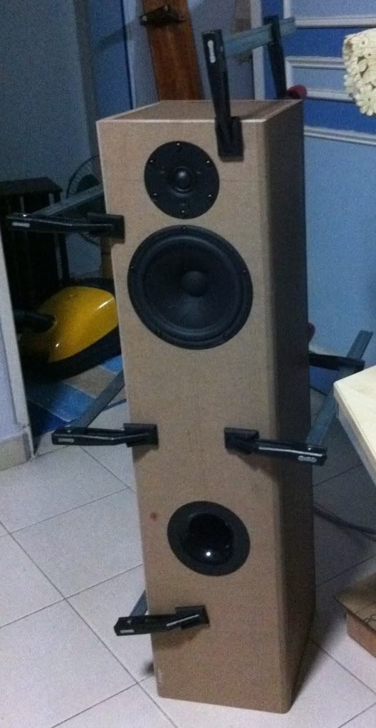

It's been mentioned by others before, that shelf brace arrangement can be a problem. I'm not fussed on the grouping especially directly above the port. If you remove shelf braces you can add cross bracing and corner cleats to sort out panel resonances.
I'm not saying to do what I have in the pic, but I've found this arrangement good in tall slender boxes. The hardwood cross brace attaches to driver cut outs to help with side panel resonances and the lower angled section forms a tapered section to help with box pipe resonances. You can add more cross bracing to suit taller boxes. The baffle has braces above and below the mid woofer as shown by the cross pieces. The pic is before corner cleats are added. This complete arrangement allows damping to hang like a curtain in the middle of the box (not blocking airflow to the port) which is a good method for vented designs and is more effective than damping applied to walls (ref Ralph Waters, Vance Dickason). Further damping is used on the top and in the tapered section.
Another thing to check is the rear of the woofer cut out being chamfered to assist in air flow as well as the entry to the port has a minimum of 75mm clearance to the back of the box and any damping.
Thank you all for the advice, especially rabbitz. Might you happen to have a 3/4 picture view of the bracing? Somehow my mind cannot visualize how the bracing arrangement looks like.
It will be quite a challenge to modify the current bracing, because they are all glued in place and it will be a real pain to get them out. I will definitely take those ideas into consideration for my next project!
These pics may help. Both are different speakers to the previous pic.
Thank you for the detailed drawings, rabbitz! It is extremely helpful, i've saved the pictures for my future projects

Couple of quick updates:
I modified the port tuning higher to 35 Hz. The bass is really tight now and full now, no complains at all.
The only 'problem' left now is i'm not 100% satisfied with how drum toms sound and in general, rock songs lack some body, for lack of a better word. There's definitely much stronger (< 80 Hz) with the new speakers, but i suspect i'm lacking that midbass punch.
So.. i'm wondering if it's because of the reduced BSC (2.0 mH) i went with that was recommended for my near field usage, throwing off the tonal balance and making the speakers a bit too forward and mid-centric.
