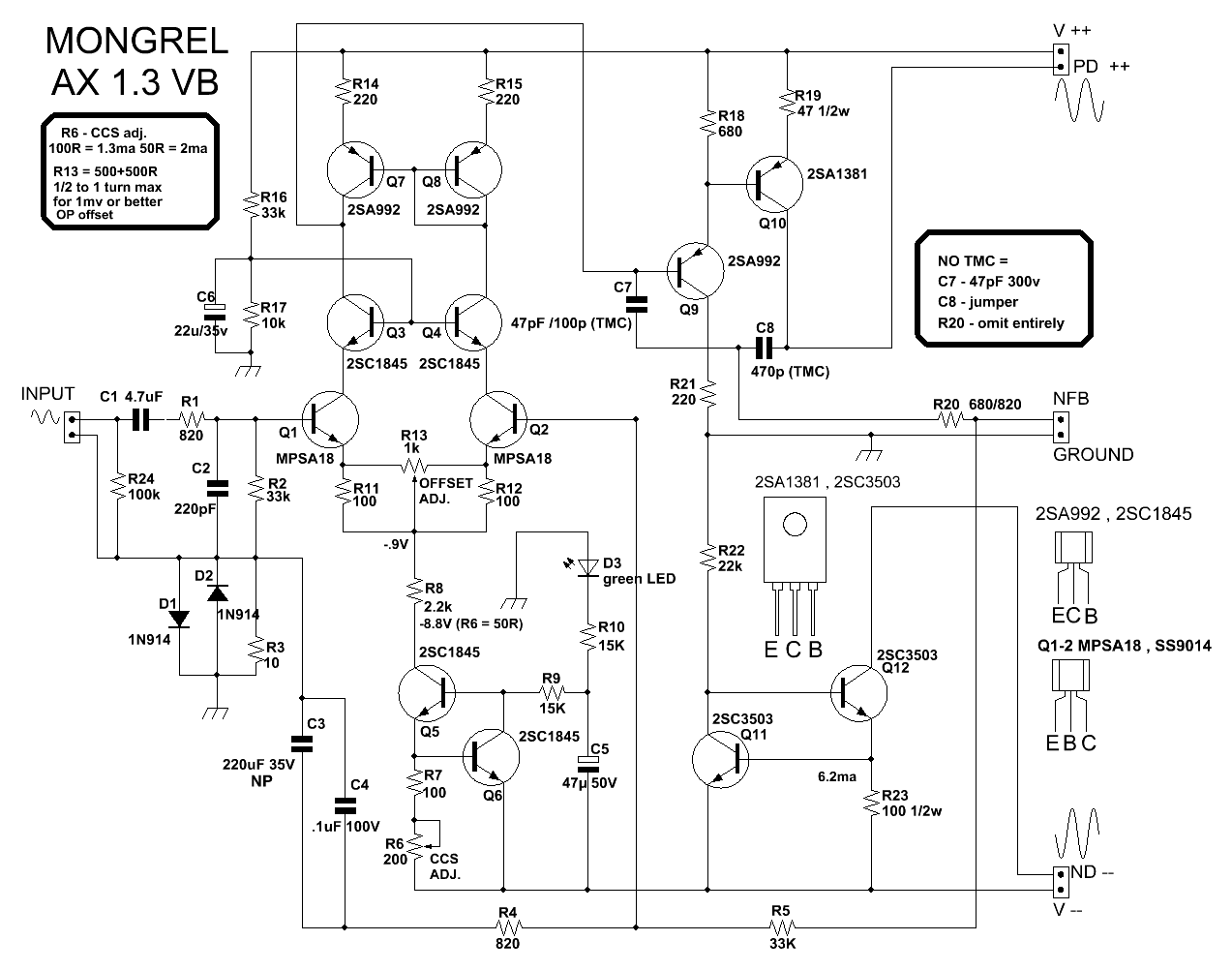

Reading and participating in that thread , there were PCB layout "bugs" discussed. One was in the vbe. Some builders DID experience oscillation (it's in the thread).
I used larger gatestoppers and ferrite beads on the MOSFETS in my attempt to make a simple Nmos 200. It worked well , but lacked the sound quality for a full range amplifier.
The amplifier in general is of sound design , but not refined. What I mean is : no beta enhancement on the VAS , the Vbe wiper could fail and fry the amp , very basic current sources with less than optimum rail conditioning. (plus- no gate protection , ferrite beads for safety , per device OP decoupling - all V mosfet specific)
Just as an example of before and after (pix 1 and 2) I started with quasi's nmos 200 and ended with mine 2 years later. 🙂
PS , V mosfets will oscillate in the 30-50mhz range , much higher than a cheap CRO will "see" , the beads and larger gatestoppers will negate this. My opinion is that V mosfets are "more ideal" for switching and PS's , not linear audio. I use BJT and Lfets exclusively !

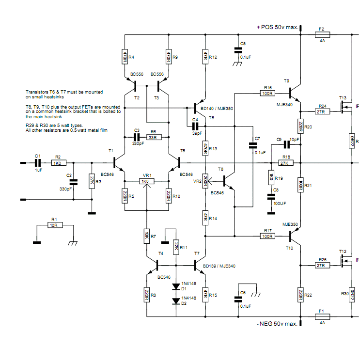

Hello Quasi.
Thank's that you responded to my problem!
I checked and rechecked all the tracks on PCB and all components. The only difference to the original I made is that I changed T1 and T5 (2sc1845) to 2sc2240, becouse I couldn't get them and instead of 200 ohm (VR2) I instaled the 220 Ohm.
All 100nF capacitors are poly type.
I checked for the contacts of semiconductors to the main heat sink and there is no contact. T6, 7, 9 and 10 have also no contact with the small common heat sink.
T8 is mounted right way (as pictured on the layout).
As everything seems to be ok, I connected the amp to the PSU with 100ohm resistors in place. When I turn the trimm pot VR2 fully clockwise I get about 12V across the 100 Ohm resistor in positive rail. But as I do this, the small common heat sink gets extremely hot and the voltage (current) across 100 ohm resistor is rising untill the temperature settles. I can set the biass only in last 1/3 as I turn the VR2. This is strange to me and I asume, something must be wrong here but I can't find out what. The main heat sink remains cold!
I haven't grounded either main or small heat sink.
When I first connected the amp the long ground wire link vas underneath the PCB. I thought this might be a problem and I moved the link to the top side. This didn't solved the problem.

Your scope is awfully dirty and dusty😛😉
Do you have a 100-220pF capacitor between B and E on VAS ? If not, try it, it might help.
100pF between B and C of the drivers might also help.
What is the current running through r20 ? can you measure about 18 mV as specified in the schematics ? Look at the voltage across r20, while quiescent, using a scope, are there oscillations ?
I set the quiescent current to the max- I get reading of 12,45V across the 100 Ohm resistor in positive rail-->24mA per FET pair. Then in measured voltage across the resistor R20. I get 3,45V-->15mA.
So this is OK.

I measured the voltage drop across the resistor R20. It gives me reading of 3,45V. So the resistor is 220 Ohm--> 3,45V/220Ohm=15,68mA.
The oscilation appears at about 3MHz with amplitude of about 55mV p-p.
VAS or voltage amplification stage is the reansistor whose collector connects to the bias transistors collector and the upper driver transistors base.
The oscillations are the reason for heat, because the VAS must work as hell. I wonder why the great heatsink not hot as well. This isn't a good sign. 🙁

I decoupled the diff-amp as you told me to. No change in in oscilation when I did that. In output I get the same oscilation as in R20 (about 3MHz and about 70mV p-p). I can trimm the DC ofset with VR1 to almost 0mV and it stays there.
I'll give it a try and put 150pF ceramic capacitor between B and E of T6.
🙂 very nice
nice too...so far
That should help, but it is verv much.
Often make C8 problems, when it isn't correct tuned, then it does the opposite that it should.
Try to remove it and measure.
If I remove the C8 (10pF) the oscilation frequency lowers to 50Hz (pure sine wave can be seen!) and amlitude gets to approx. 160mV p-p

But again to the oscillation C3 with 330p seems to be to small, I would take 2200p. C3/R9 reduce the open-loop bandwidth.
Interesting!!
When I changed the C3 (330pF) to 2,2nF all I can se on the scope is straight 0V line in the middle of the crt screen! No sign of any oscilation! I probed the input pin and input ground pin, R20, R25 and output- an all pins there is straight line! I tried to touch the input pin when I probed the output pin and it responded to the touch. As I removed finger, the output went back to 0V straight line.
Now im tempted to connect the speaker, but I'm afraid something would go wrong! Any chance to connect the speaker the way I don't blow the amp!?

do not connect a speaker, instead connect a resistive dummy load.
Short the input temporarily, while you take measurements.
When you have all the voltage measurements and from there all the current flows you can post details on a schematic.
Then the fault finding experts on the Forum can try to trace what fault is causing this oscillation problem. Once that is sorted then you can progress to finding the optimum stability compensation, before you even think about attaching a speaker.
