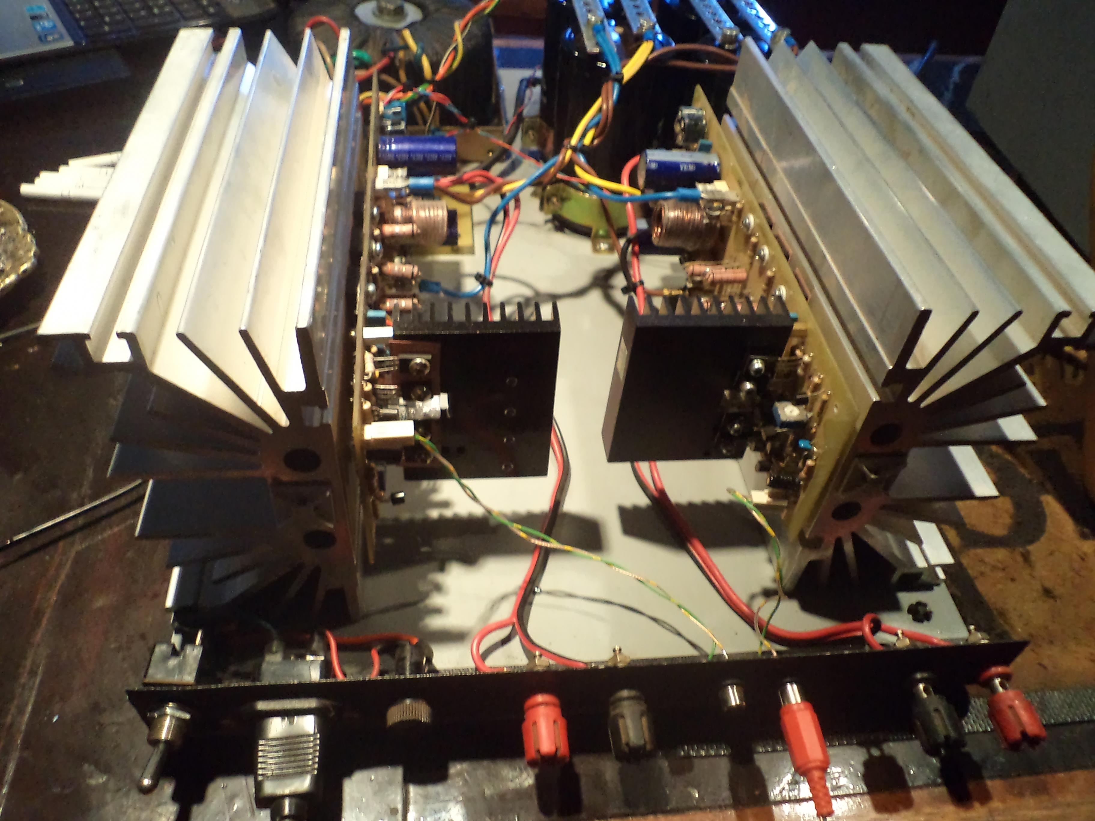

My tester device reports gate capacitance as 7nF. Very high, specs read 4nF (IRFP 260).
I tried gate stoppers up to 240 Ohms, mosfet oscillation went down from 2.5 MHz to 2 MHz.
Small Zobel (100 Ohm + 47pF from G to D) on every mosfet didn't make any difference.
Only upper mosfets were oscillating, bottom ones were ok.
Now I'm trying another board without output devices, and I see smaller/different oscillation from VAS.
Will try to get rid of this first, and then try single pair of mosfets...
Just wanted a confirmation from somebody who actually built mk2 version, that this amp is fixable.
Is it oscillating on the whole signal or just one phase ?
If its on the lower phase then the 220pf on T11 CB should fix it.
The problem is there is gain on the lower driver but none on the upper driver.
I have designed a few quasi's and come across these problem before.
Oscillations on upper mosfets (2.5 Mhz kind-of-sinus wave) gates were happening at all times,
even without input signal.
With signal, say with 1kHz sinus, I would see thicker (4 times thicker than normal) 1kHz sinus
on the output.
I built 4 amps nmos200 (with 1 pair, so I guess it should be called nmos100 without any issues, ever. I searched this forum, and couldn't find even one confirmed build of mk2 version.

All my parts are from mouser, no substitutes - all exactly like in quasi's schematic (mk2).
Output devices are irfp260, rails (for now) 60V.
Comp. caps are C0G.
In the other Quasi designs IRFP450 is used as output devices and now when I look at the Nmos350mk2 there is no recommended output device in the schematic.
Is it not possible that Nmos350mk2 is meant to use IRFP450 like the other designs? If you compare IRFP450 and IRFP260 the latter has twice the input capacitance and more than twice as high transconductance two things that will make stability harder to achieve.

I noticed this, but:
1) my nmos200s with irfp260s and the same gate stoppers and compensation worked fine
2) I have a bucket of irfp260s to use up
3) mk2 oscillates (VAS) even without output devices connected
So far it seems that no one actually successfully built mk2..
This is dead long time ago but since i am giving a go to a NMOS 350 here is one thing to start with
Having your drivers at 18 ma that will dissipate X watt times 2 in a common heatsink with another stage Vas at 12 ma times 2 that will also produce <X watt times 2
will actually mean that no matter how big is the heat sink ( which in our case is not that big due to pcb design ) bias will take some time to stabilize and in all cases the higher temp of the drivers will eventually stabilize to some temp and bring also VAS stages in the same temp ..... That is thermal run away any way you slice it
in my first attempt at 71+71 rails yes with a small heat sink and the amp biased at about 30 ma per transistor i had almost 65 degrees on the small heat sink at no signal conditions ,,,,Now no way an 340- or 350 can operate properly at this temp
I removed the drivers an locate them else were and temp dropped to 35 degrees down and bias setting become much easier to set and more stable regardless room temp or amp hot or cold ...
ok that is one issue solved .... but i think that there will be many more details to look at ....It seems to me that the circuit is not refined
