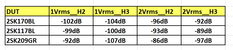

Feel free to use this image, it might be easier to interpret than unformatted ascii text.
_
Hi. 2sk209gr is interesting part.It has about 10dB more H2 but has less H3 than 2sk170bl.Maybe it sounds better than 2sk170 because of more H2 adds warmth to sound and H3 is lower so sound may be nicer? Anyone compared them and could tell about sound? I have reel of 3000pcs of 2sk209gr.Did not have a spare time to play with them yet but i want to try them a lot.

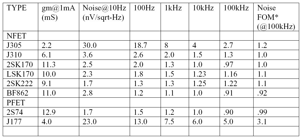

While there are continuous discussions about JFET noise and what can we use to replace K170 etc.
It is perhaps useful to post a table published by Scott some time ago.
And the surprise winner is not the popular K170 or BF862.
Patrick

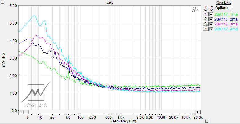

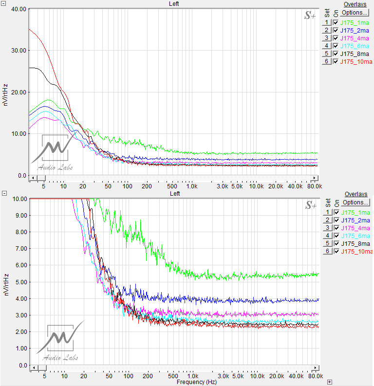

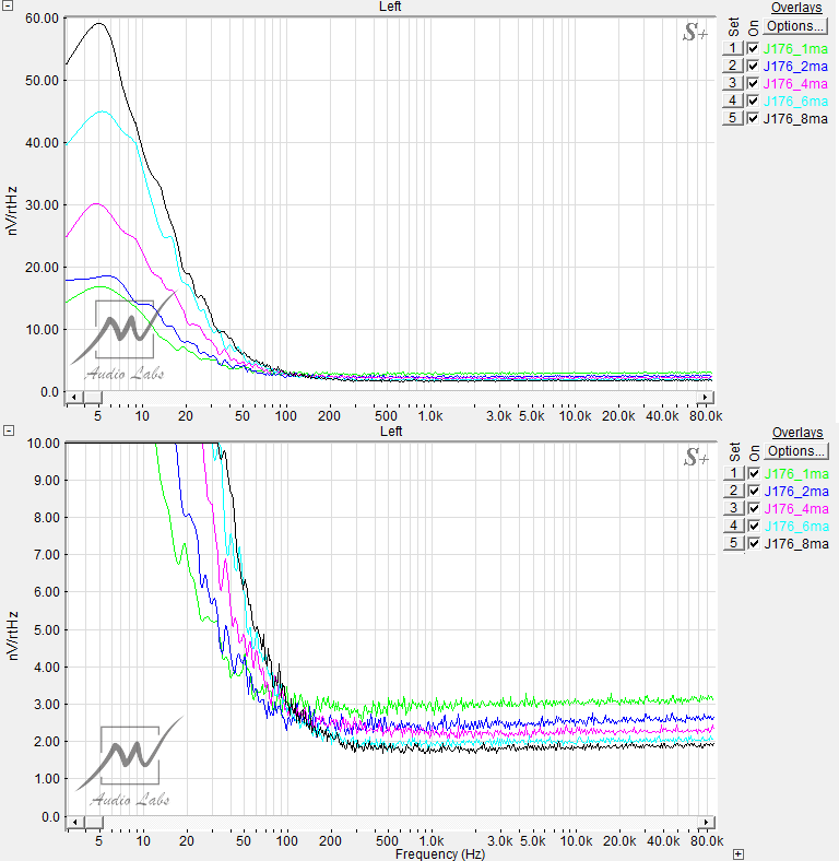

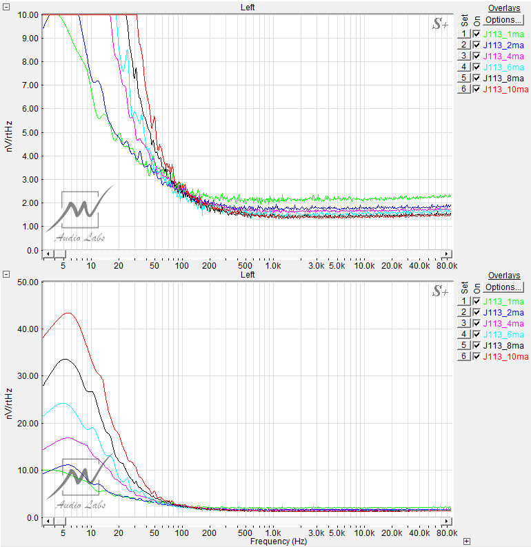

I have always wondered how the much-talked-about J113 performs in terms of noise.
Just found this wonderful website which has all the information one likes to have :
https://www.mvaudiolabs.com/diy/modern-jfet-noise-measurements/
I leave you to draw your own conclusions.
For me, no surprises with 2SK170 and 2SK117 ( = 2SK209 SMD ).
So I reafirms what I woulld use for source followers / buffers in applications like active crossovers.
And the J175 / 176 are actually better than I thought.
Patrick
