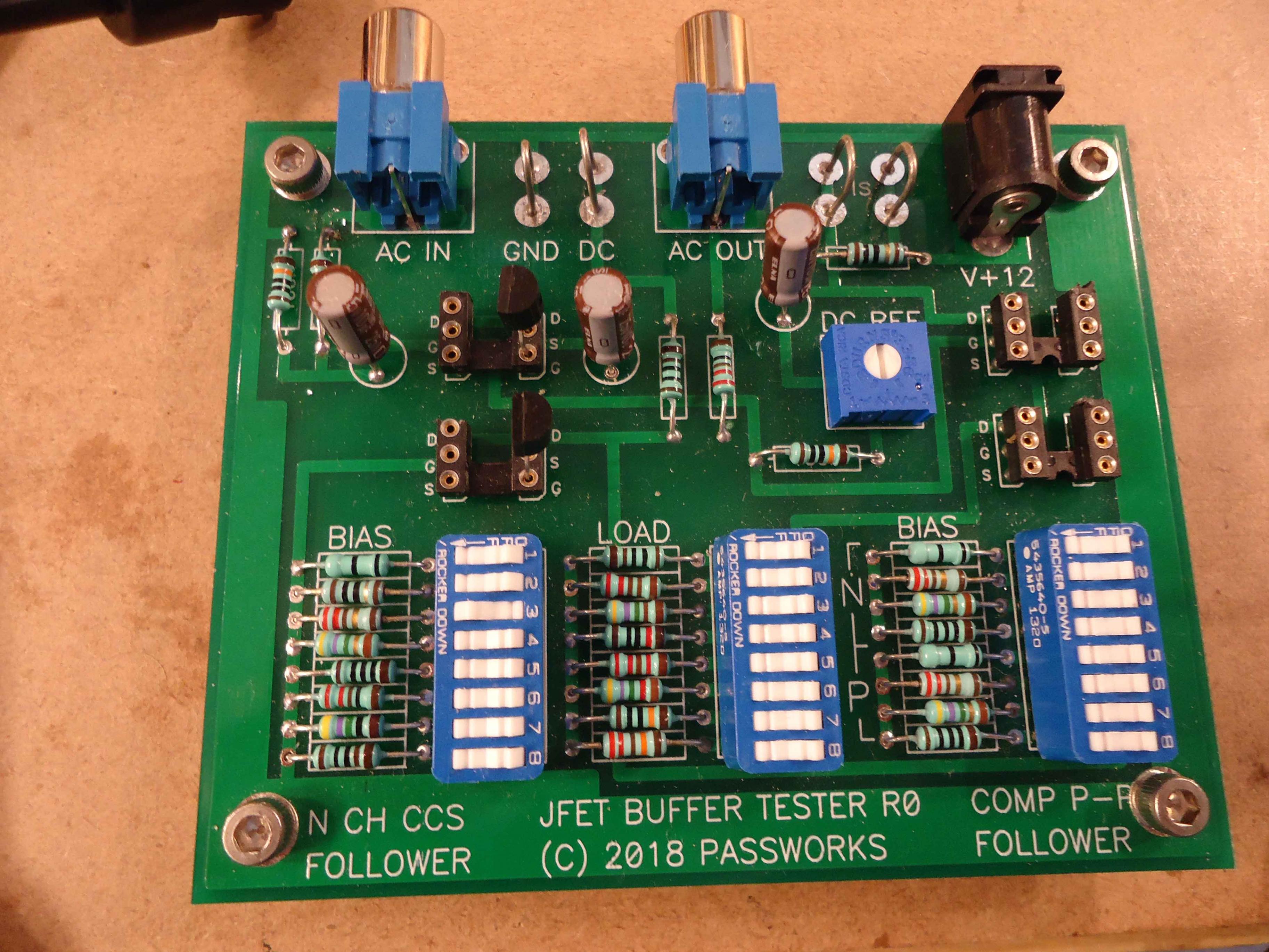

When I started getting serious about replacing the Toshibas as followers
I did pc art for a jig that used two Jfets and had variable resistance for
the Source of each and also the load. This allows you to search for the
sweet spot without a lot of effort. After I did this one I have figured out
some improvements...

Before connecting audio analyzer, has anyone tried picking a higher IDSS J113 and dialing back both the Drain current and gm with a source resistor?
Seems that if we can adjust the J113 and J176 Drain currents and gm’s closer to matching we could get better distortion performance.
Anyone tried?
Thanks DT
Yes, of course. But now you can see why the Toshiba's are prized....
You would want to try J112's, J113's, J175's and J176 with different
Idss figures, different Source resistors, different loads, different supplies.
I pulled up some notes indicating that if you juggle these you can get some
0.00X% distortion numbers at 1V into as low as 1.5 Kohm.
That said, it's better and easier with matched J113's where one is the
follower and the other one is a CCS.
:cheers:

Hello All,
There for a minute I failed to recall where I learned to dial in the sweet spot. I clicked on PassDiy and it all came rushing back at me. Back when, I rushed out and purchased a used AP2522 audio analyzer. You can adjust the power supply voltage plus adjust the multi-turn variable resistors up a little or down a little while you watch the Harmonics waltz in or out on your computer monitor.
We are talking simple buffers with matched n channel pairs maybe later get fancy and try complementary push pull n p pairs.
This is not so much about finding the perfect replacement JFET as developing the methods to select from the JFETs that you have dusty on the shelf. It is much easier to match n channel pairs than complementary push-pull n p parts.
I have some K170, K246, 2N5457, PF5102 and a butt load of J113 to test.
Thanks DT
