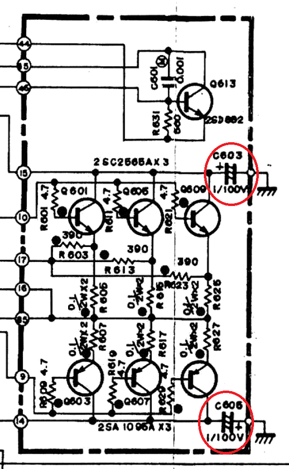

I do have a question, I've attached a pic of the power amp schematic. What would the purpose of the circled 1uf/100v cap between the collector and ground there? Filtering to ground?

Yes, commonly called decoupling or bypass caps, fitted locally to ensure a low impedance path.
Since all the electrolytics are original as you found, you know what comes next.....😉 Have fun and you don't need to buy the most wonderful brand high priced caps. Just any working caps will be better than what you have but pick a reputable manufacturer like Panasonic, Nichicon, Rubycon, United Chemicon, Elna. Epcos etc. and select popular audio grades with a decent working life of more than 2000 hours. Note that size is now just a fraction of those from 35 years ago.

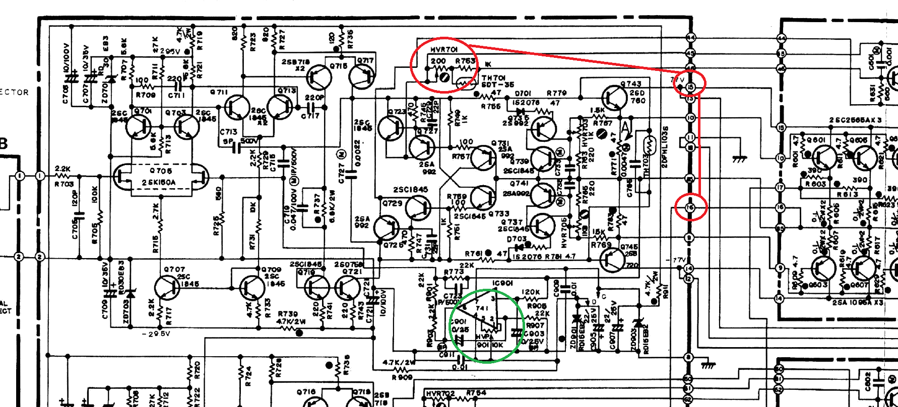

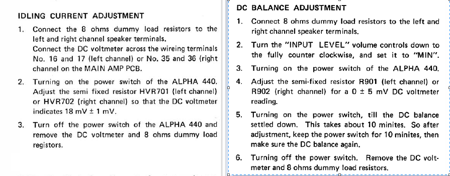

I've attached the procedure for the Alpha 440 and a snipit of the power amp section with potentiometers highlighted.
The OpAmp (IC901) is an NEC uPC741C and I understand that this OpAmp provides a variable bias, and if I understand the 440 manual properly at low power draw the amp operates in a Class A, and when the power requirement is at a higher point the amp switches to Class AB (B) as the manual describes it.
The more I look at the circuit, this opamp could be the root cause, or the feedback to it is unstable on startup.

IC901 looks to the DC servo, tries to keep the output at 0VDC no matter what. That won't or shouldn't affect the idle current if it's working correctly.
Craig
ah, I see. I was reading it as a 'Balance" is also a bias center. I found it ironic that the 10 min warm up time depicted in the manual was also about the amount of time I need the unit powered up that clears up the issue I'm having.
