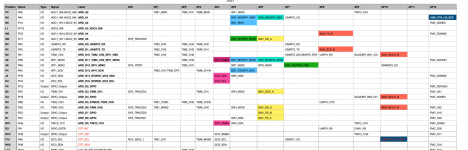

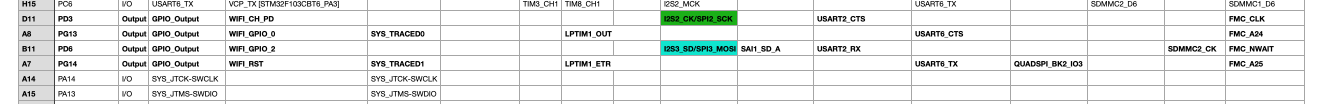

I've also been playing with the pin configurations on the STM32 discovery board to ensure I could have a connection out through the Arduino pin connections. This can be done (after dumping the alternative pin configurations from the STMCube IDE to cross check).
I can see why others have moved away from the board to use their own. Although a nice starting point, board presents a restriction due to the additional devices present but for now the 17 layer board will be the fastest way to get this working. I suspect that with less components, that a 4-6 layer board could be made. This guy (
