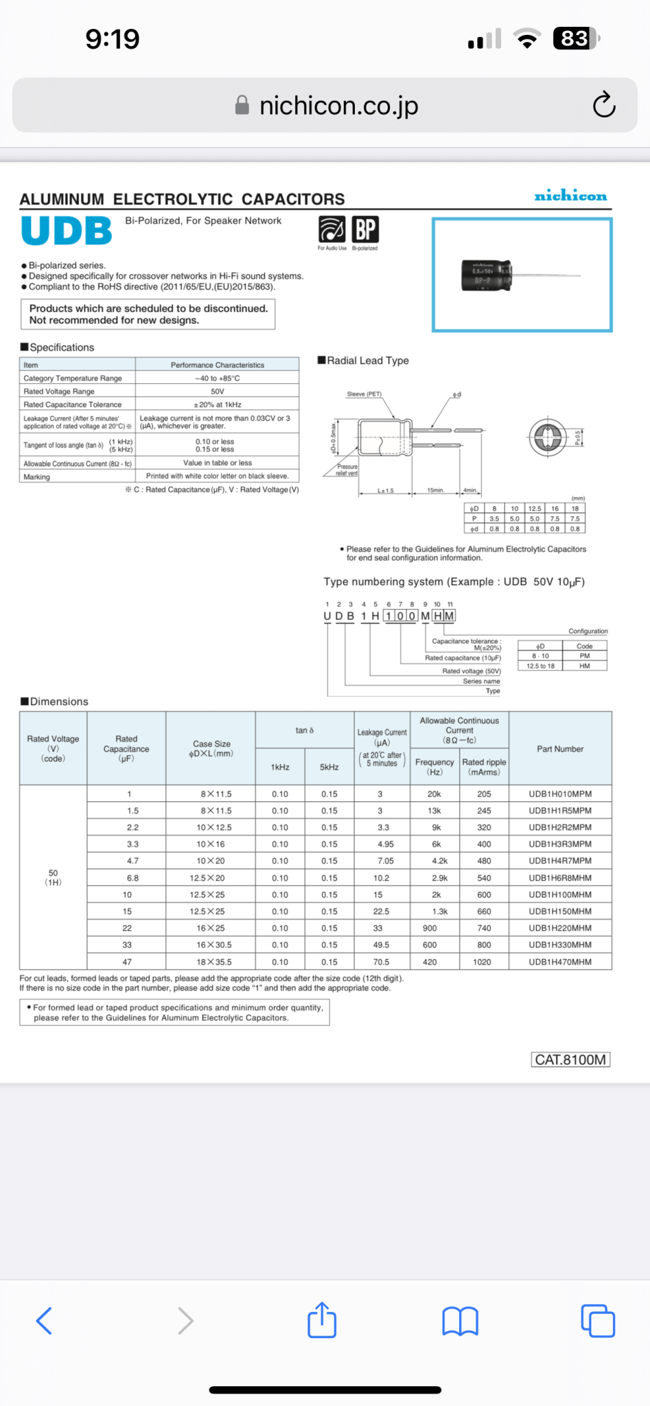

The first thing you did was to look for the capacitors on eBay…..
Not on mouser.com or digikey.com or Newark.com or other Nichicon authorized retailers.
Just because Nichicon is a Japanese brand, that doesn’t mean the caps will be made in Japan.
Take a look at the data sheet for the correct name

The initial issue with the UDB range is that they're only +-20% tolerance and both leads come out of their bottom surface, not from each end as would most xover caps have.

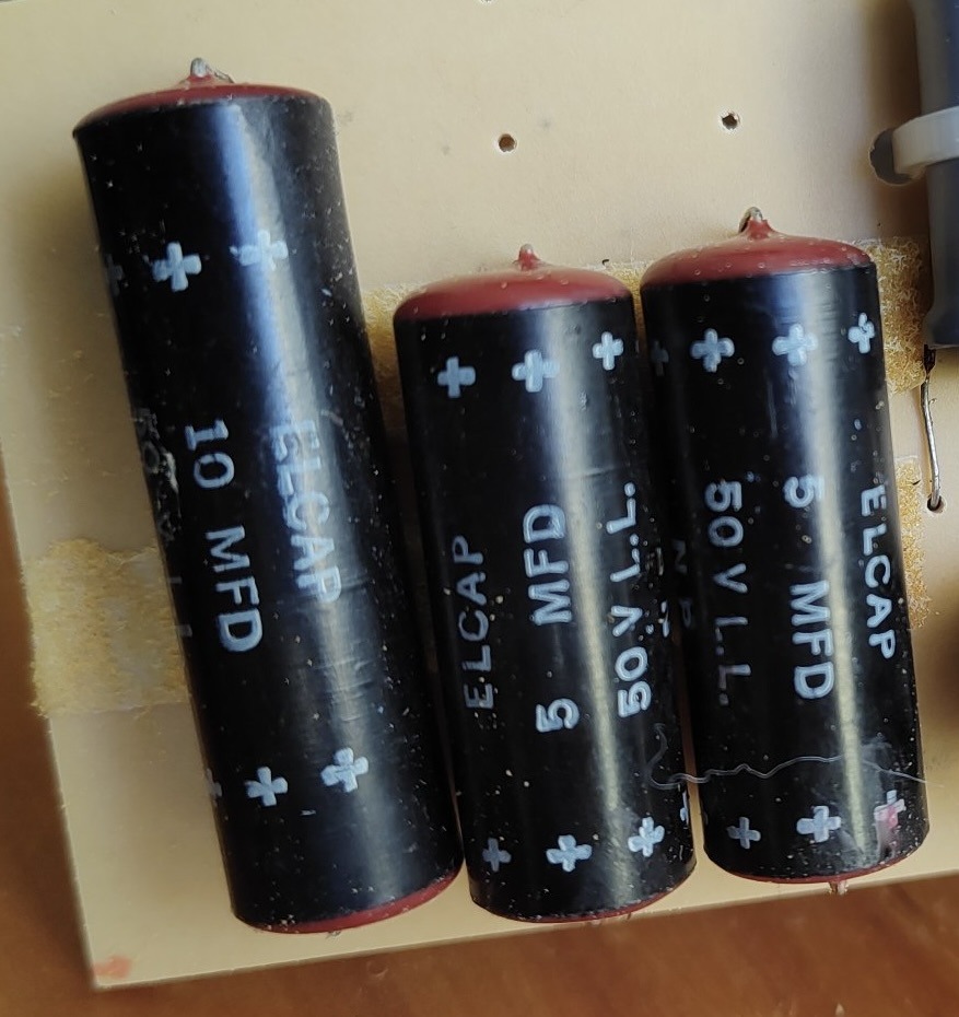

These are described as "radial" capacitors. Those you would prefer are described as "axial" capacitors.
I've had a good look around the OZ suppliers and axial bipolar electrolytic caps appear thin on the ground - apart from 4.7 uF ones from Jaycar.
https://www.jaycar.com.au/4-7uf-100v-electrolytic-crossover-capacitor/p/RY6904
I found that JayCar also have the 10uf version.
https://www.jaycar.com.au/10uf-100v...Text=uF 100V Electrolytic Crossover Capacitor
JayCar cap at +-10% vs Dubelier cap at +-20%, would you say JayCars offerings are atleast similar if not better due to tighter tolerances?
So, the two capacitance values you require are obtainable from Jaycar?
These will be perfect replacements for the ancient ELCAP capacitors in your vintage speakers (see attachment).
