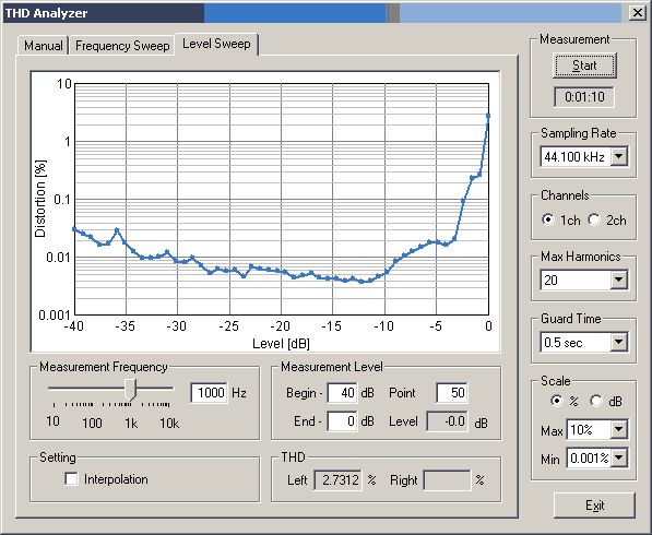

PS2: "IRFZ48V 100V 36A .021ohm 42nC/41nC" hmm, rather irf540z By the way, 540z could be successfully used in the class D too, of course it isn't the best choice though. This is THD/Power sweep of amp 400kHz ir_driver+irf540z +/-36VDC, loop gain are ~36db, 4oHm loaded:
