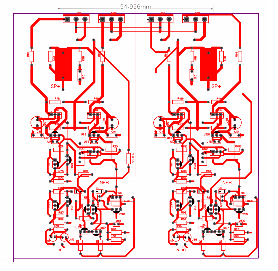

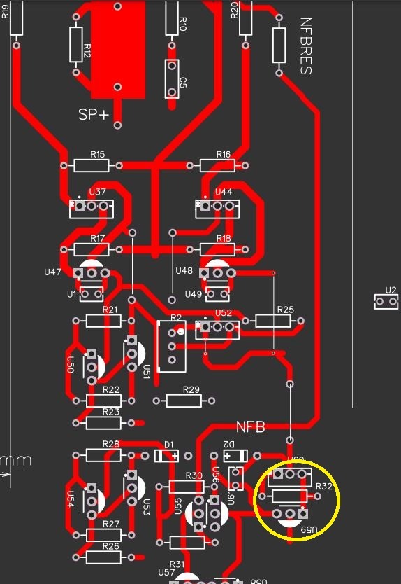

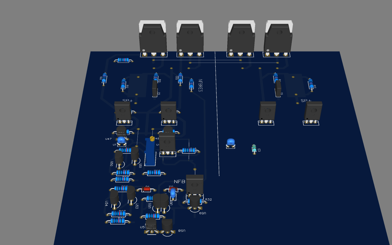

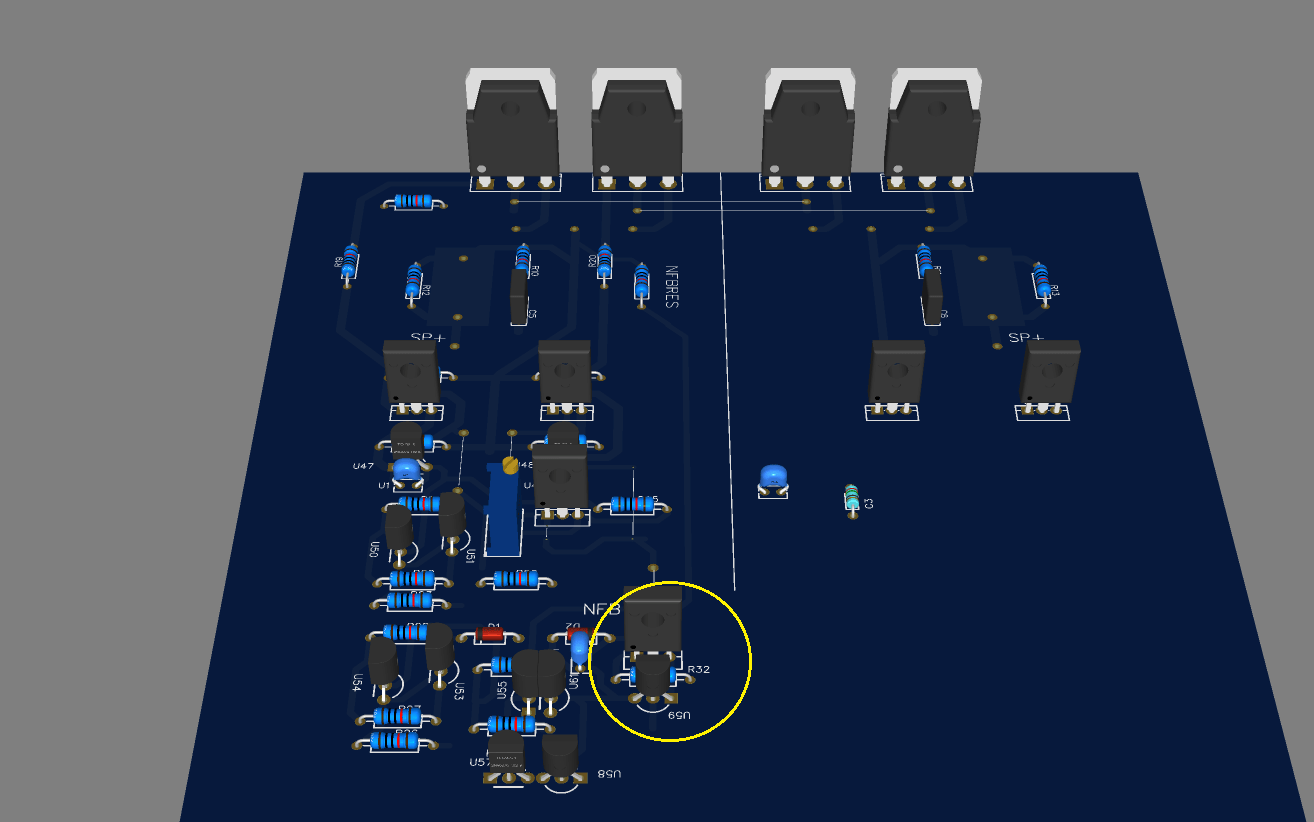

NFB Trace on PCB?

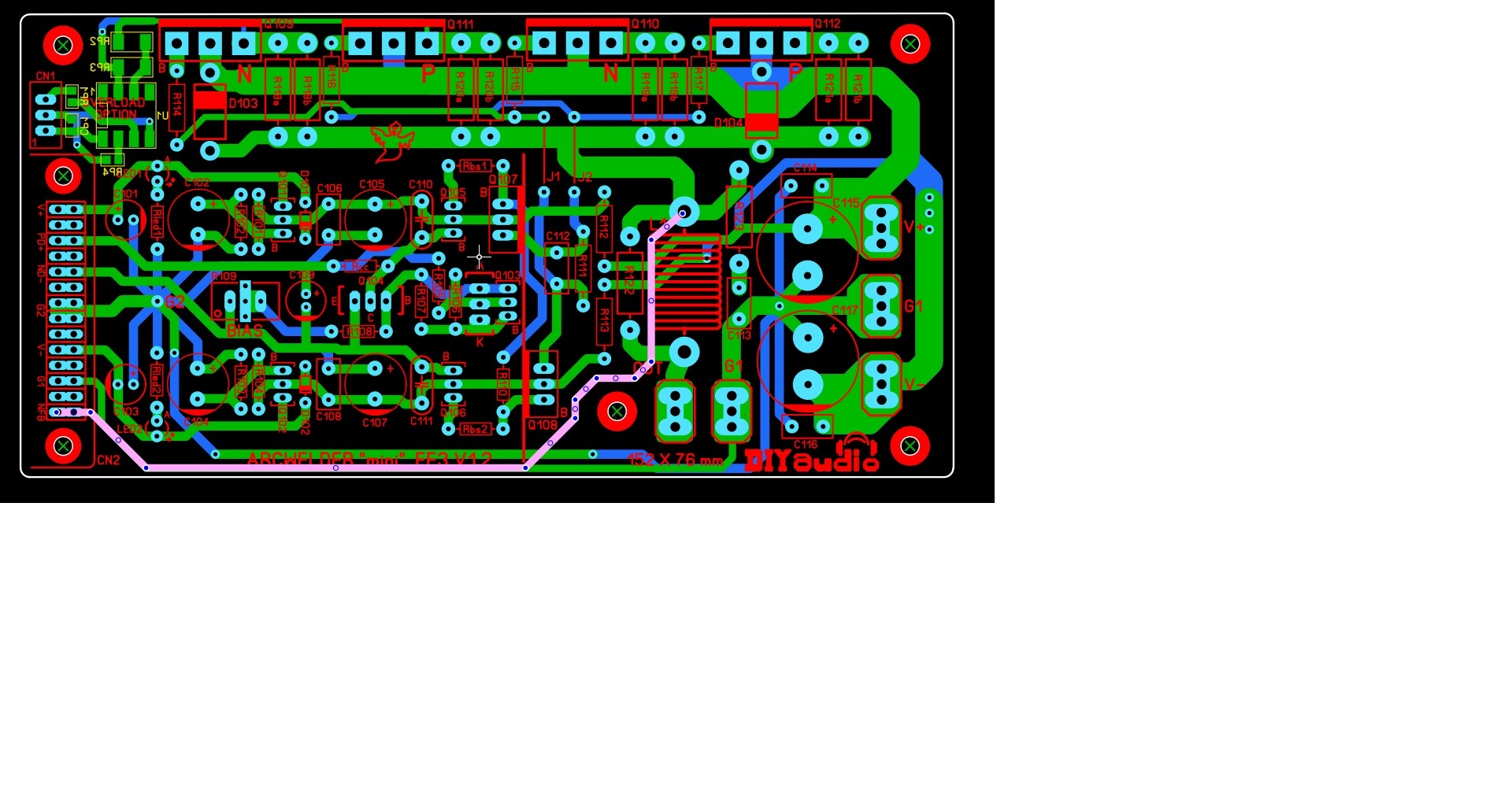

You must keep the loop area of the feedback network and the input side of the LTP to a minimum. To do this, run the 0V to the front end in parallel with the feedback resistor network. Keep the front end inside side compact and loop areas between the signal hot and the 0 V as small as possible. If your board is double sided you can run the ground track to the front end under the feedback resistor.
Input stage NFB is like the example (below-pink trace).... Signal ground reference should be the speaker terminal's main star point G1-speaker.
This is the final solution to get the Wolverine <1ppm/20Khz. Looping the NFB around the rails increased it to 20ppm+.
If you are just shooting for <.02-.05% "normal" distortion , you can be MUCH sloppier !
Edit ... supply grounds (G2-below) go directly to main filter cap star point.
OS
Reactions: Bonsai

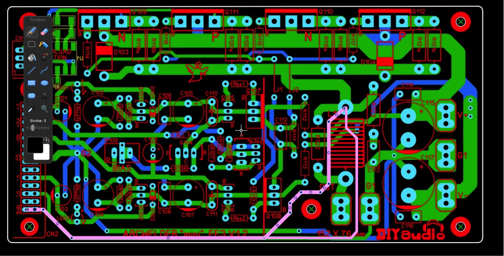

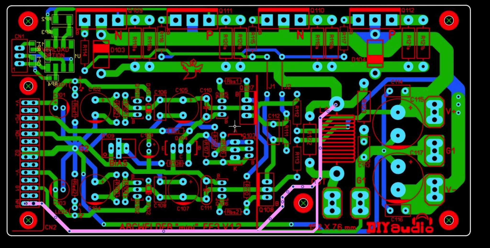

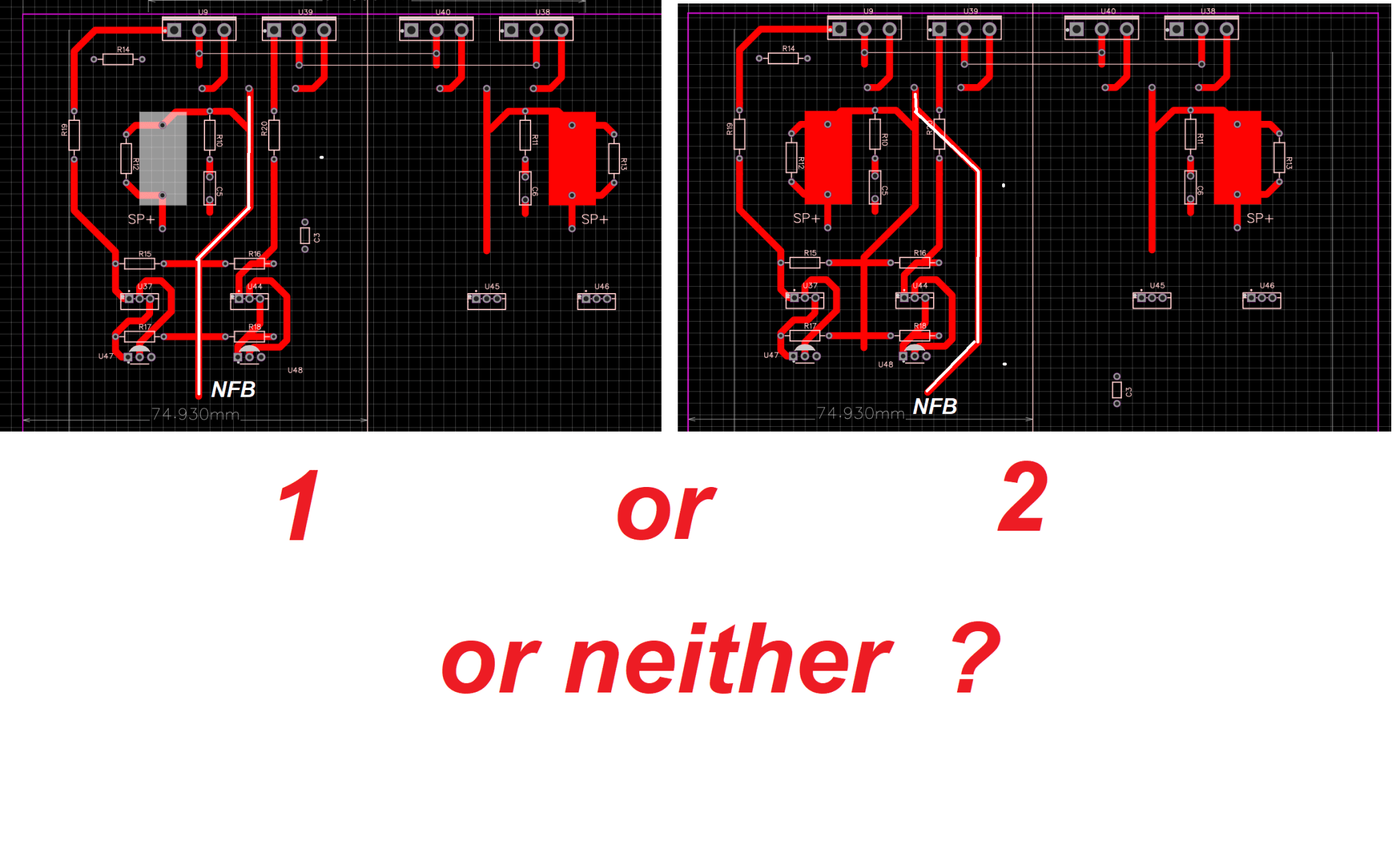

1 or 2 ? Would have to see the whole layout first. Consider that NFB is a full amplitude signal and could affect input stage traces.
On earlier "slewmaster" OP designs , I would place the 22-27K feedback resistor near the emitter resistors and run a lower level NFB
signal across sensitive input stage circuitry with a wire. A CFA amp might incur some inductive coupling.
I wonder if fishing the feedback out through the output spades would be even better. The difference is probably academic as you're already at the dBGF level.
Tom
High level NFB trace is the same phase before or after the inductor... would not matter. NFB trace close to the "dirty rail" decoupling was the only
setup that made the 30+ PPM difference (on the Wolverine). Another big improvement was to streamline the loop area(s) of the rail feeds.
Having the rails on opposite ends of the PCB (like most kits) sucks.... Stopped doing that with the post "Badger" 15 years ago.
Yes , double sided PCB's let you emulate "twisted pair" wiring right to the OP devices.
OS
  • Thank You
Reactions: xXBrunoXx
Not what I meant. I meant this:
With the modified routing you get a bit more coupling to the ground trace that runs along the bottom of the board. Like I said, it's probably only of academic interest as you're already at the dBGF level with the distortion. That's dB relative to one imperial gnat fart. 🙂
OS
Nice tight loop 👍
