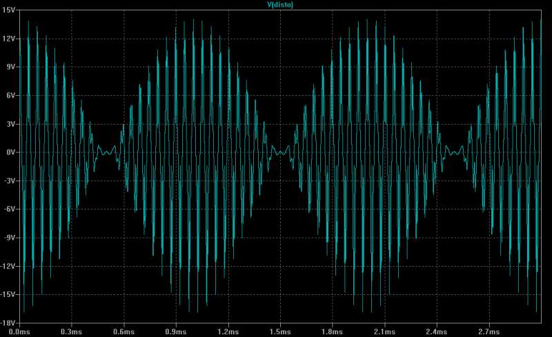

Below we have a CCIR (19k & 20kHz) 80Vpp in 8 ohms trace of a simulated amp.
Just by this trace, this amp could be classified as a decent one (all other parameters, such as freq response, stability, etc are good).

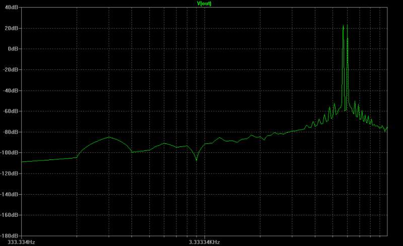

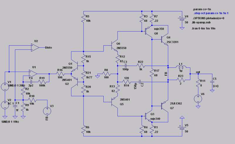

What are NFB parameters for both of these amps? How many db of NFB lets say at 20khz? or what are actual differences between these amps? some sort of schematic illustrating differences between two of these would be intresting.
mzzj
Both have about the same NFB factor - between 55 and 60 dB at 20K (so they are of the high NFB type)

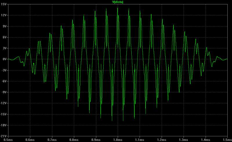

Both amps have the same input, output voltages.
The distortion traces scale have been multiplied by 1000 just to make it easier to compare.
The distorted waveshape is larger just because OL distortion is higher, but full of spikes, this being the main point here.

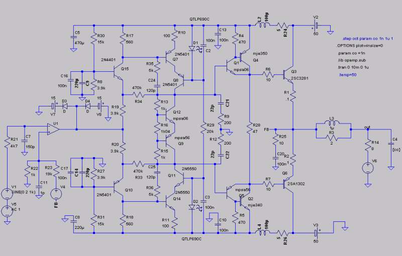

Here's the circuit of the 'bad' amp (the generators are used for the many simulations I've done - loop gain, FR, input disto, output disto, stabilty).

Mr Evil said:
Bad, no doubt about it. You can prove it easily: Measure distortion with PSU attached, then measure again without power... all distortion gone!
Right. That's why in the 'good' amp I've taken precautions to keep PSRR better than 100dB (the inductors in the power lines, for example) over the whole audio range.
But PS effects were not taken in account in the above distortion traces.
