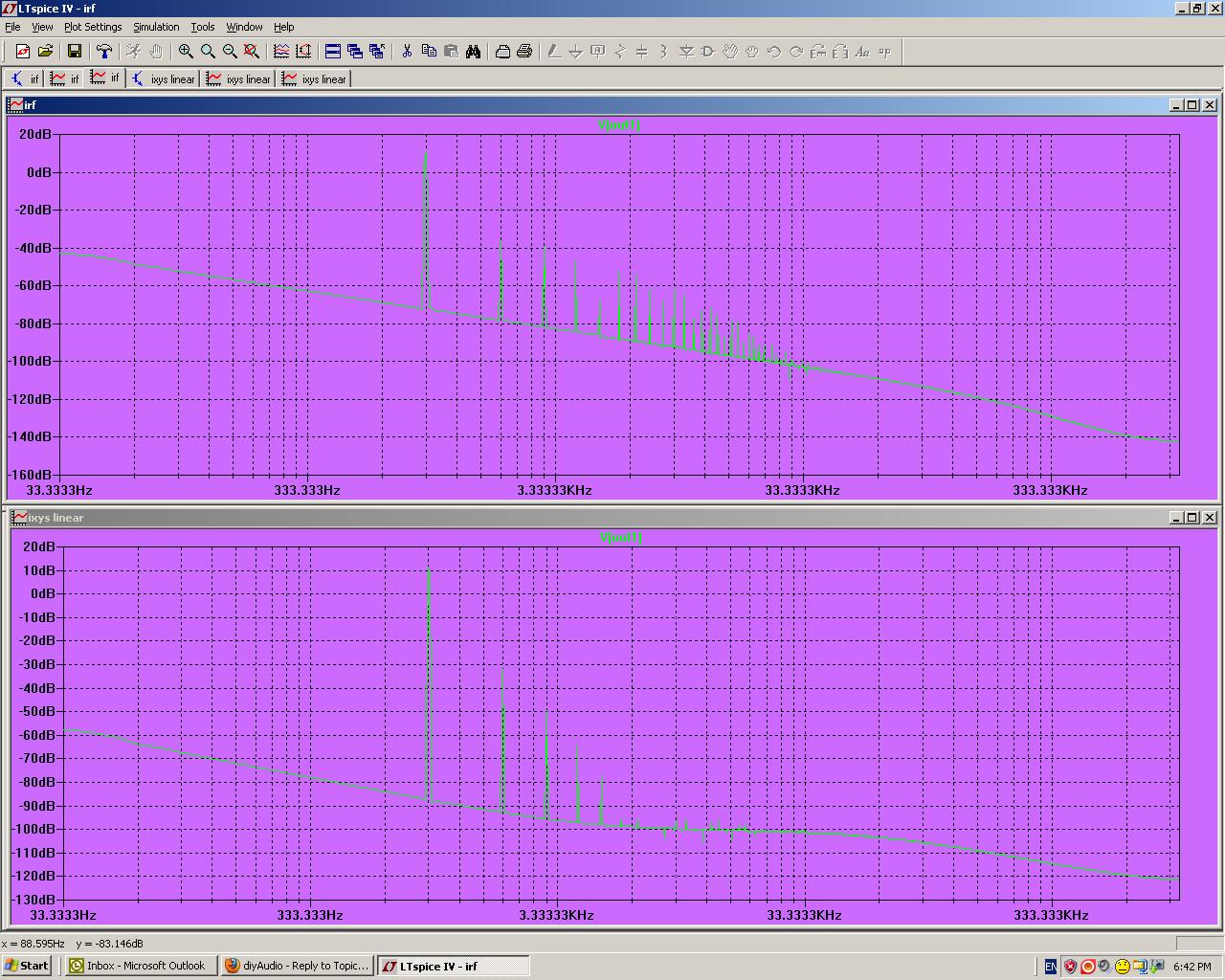

The curiosity got the better of me.
Here is a zen circuit using IRFP240 and IXYS linear device
Top of the screen is IRFP240
Bottom of screen is IXYS Linear Mosfet (Enhancement Mode)

Realistically, the winner will be the one with the lowest
distortion in a simple circuit.
:cool:
I'm going hedge my bet then, if it's not a power JFET, it's a MOSFET that looks and behaves like a JFET :D
hmmmm, now I'm even more curious.
If it's not a simple case of swapping in and out different devices then we must have different devices wearing different hats. A power JFET below and something different for the current load ?
Or an attempt to go a step further than your 'sweet spot' article, combining two devices with different characteristics to achieve a 'super sweet spot' perhaps ?

It's not generally a case of simply dropping new devices into
a given circuit, although that is often an indicator.
The "sweet spot" is always looked for, but I have never seen
a "super sweet spot". While conceptually possible, it is
unlikely, as once you get second harmonic cancellation all
the low hanging fruit are gone.
:cool:
