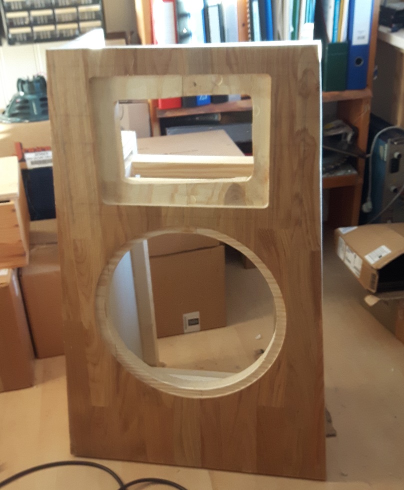

I have also found BB hard to get a hold on. My last project (open baffle) I made materials from a combo of particle board and 15mm armored drywall/plasterboard. The armored drywall boards have fiberglass strands in it and is markedly stronger than regular drywall. It also has better sound dampening and is used where sound reduction thru the wall is one of the design goals.
The biggest issue was how to glue the drywall to the particle board, and I ended up using strips of sikaflex. I used parallel strips of sikaflex every inch or so, hoping to allow air to reach all the way into the middle of the boards.
Sikaflex is not cheap, and the armored drywall is 5x regular, but it all ended up cheaper than BB and the result is pretty good. The finish was paint on side and back, and the front got some oiled oak floor panel on it.
here from after glue has dried. The sides and back are now marine yellow and the front is oiled (darker). The square cut out is so I can experiment with different drivers and positions. Using a 15 bass driver and have some Wild Burros on the way. At the moment I have some 6" Fostex. xo at ca 200Hz first order. Not finished...
edit. As you might see they are u-frame. almost 100cm high and ca 60cm wide, the u extending ca 25-30cm on both sides. The front tilts backward ca 5degrees.
