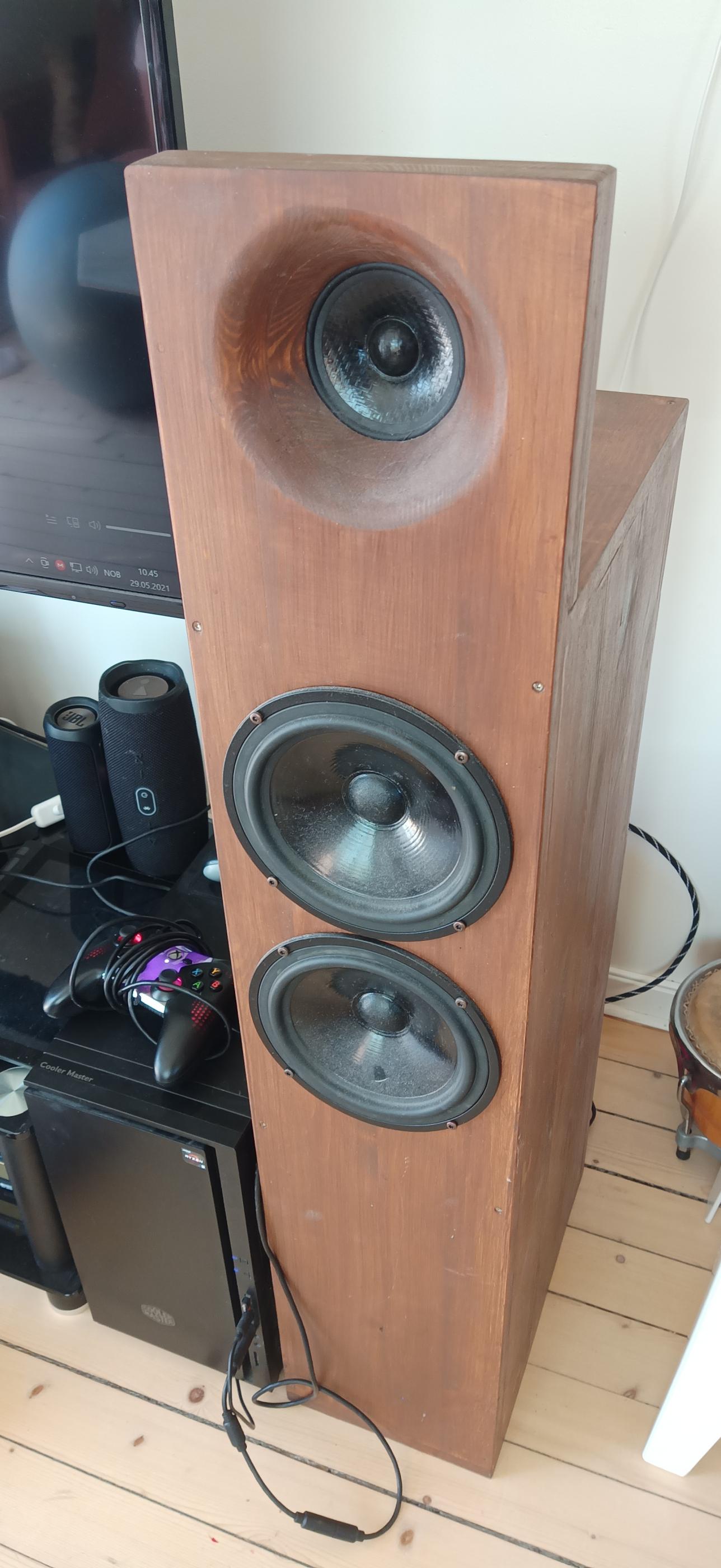

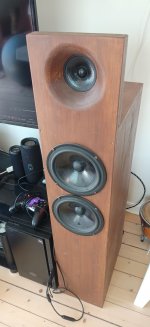

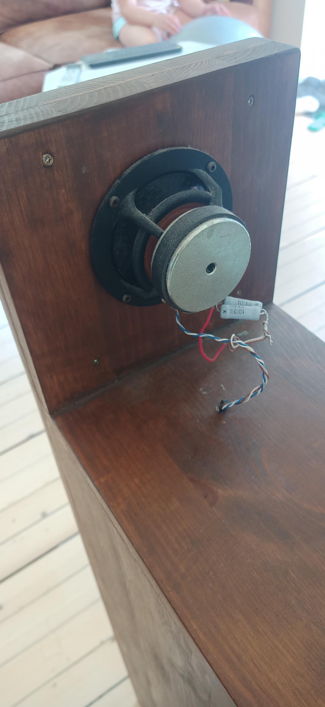

Our living room speakers are made out of pine boards. Seem to be holding up nicely after several years of abuse.
It was a "how much can I dumd it down?" type of build, 1st order 700hz filter, Seas FU10RB and double 6,5" closed.
Sounds great.
Almost anything is possible to use if you just "do it right".
FYI 2x2cm square spruce sticks are usually more than adequate for bracing even quite large boxes, very stiff and light.

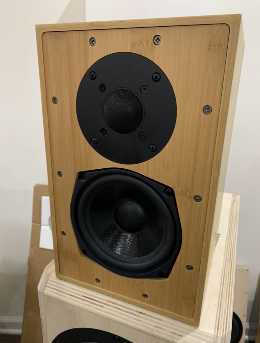

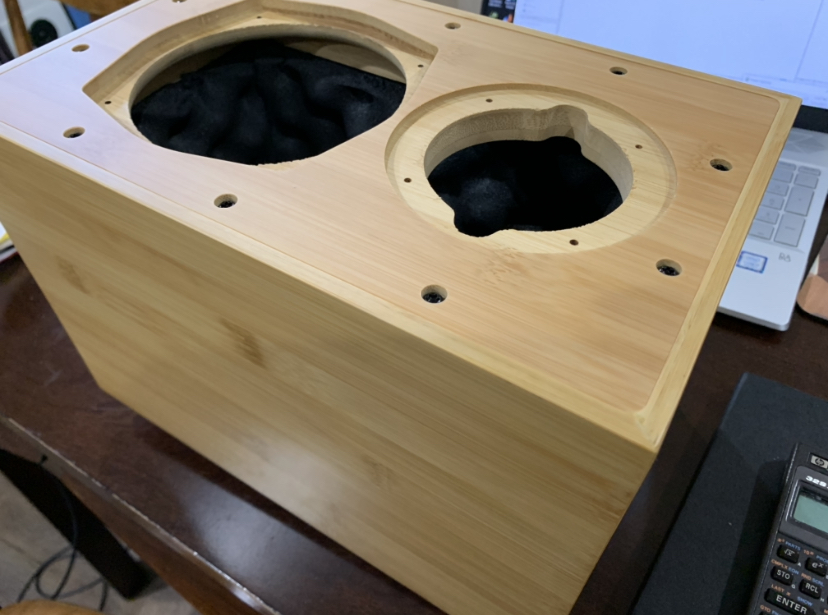

Thanks for all of the great suggestions, everyone! I really like the look of the bamboo ply, that's pretty sweet.
KaffiMann - those look like nice speakers!
I also remember reading a few articles about using apply ply - I had forgotten about this material.
Given the feedback and what I can get locally, I'm thinking I'll aim for the 9-ply lauan for now.
