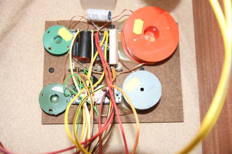

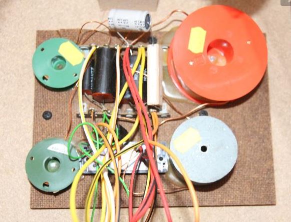

Ok here is the picture of the 1 remaining crossover inside the speaker but please note...
I am NOT looking to turn the speakers back to their original state, I want to upgrade all the speakers and crossovers to make them a better speaker.

Well, if you're dragging your feet over this possible restoration of a decent looking design, I'm out. I'd need to know those capacitor and resistor values anyway. And there's markings on the coils.Ok here is the picture of the 1 remaining crossover inside the speaker but please note...
http://i118.photobucket.com/albums/o100/ddd_099/IMG_5053_zps8ab0d9ad.jpg
It's second order bass, 4 element mid and second order tweeter. All quite standard.
but if I was to swap the woofers mids and tweeters out for better ones then this crossover wouldn't be any good anyway so whats the point in making another😕

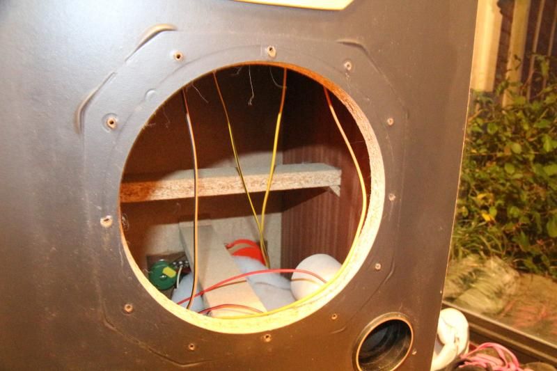

It would be interesting if you were to post a couple of photos of the insides of one of the cabinets - how are they braced?

Hahah if I ever get these finished I can!! let me try to get some pics up of the insides, give me half hour!
Ok here ya go!
These are the only 2 braces in the speaker.
I honestly thought it would be a case of throwing in some replacement 8'' woofers, tweets and mids, add a xover and bobs ya uncle... Guess not!!
