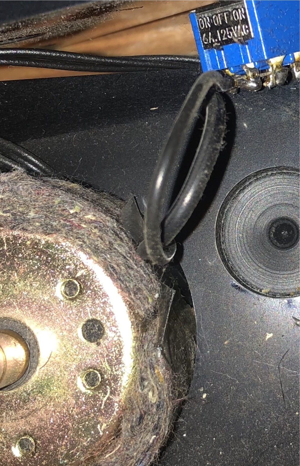

I wasn't sure I'd get responses, so I avoided attaching too many pictures. I've attached a cropped image of the motor spinning the platter. FWIW

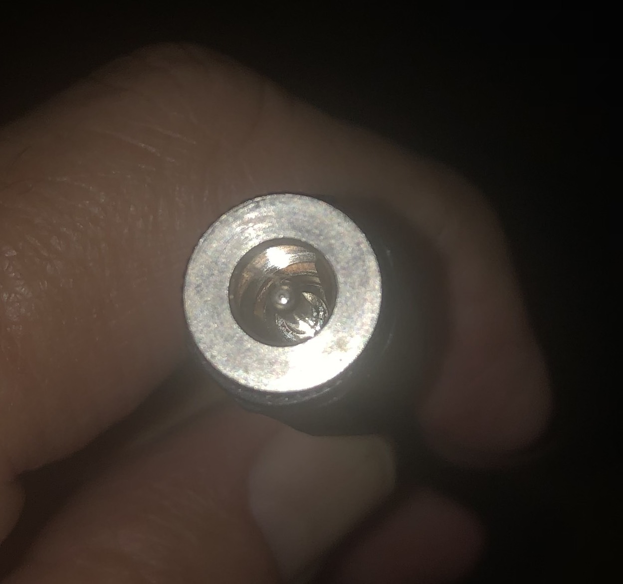

There is a heat shrunk cable (#) wire exiting the SMPS. It terminates at a barrel connector. There are no pins inside or out at that end.
I've partially pried open the SMPS case. The # cable is soldered to a circuit board inside the SMPS case.
If there are jumpers or pins (same thing?) inside the case they're not visible to me.

... if the the motor is 6A at 125VAC...
That is the rating of the switch, not the motor. Essentially the switch is suitable for any voltage up to a maximum of 125V and can switch a current up to a maximum of 6A at that voltage. It may have another rating on the other side, e.g. 250V 3A. In this case it will be switching low voltage from the supply.
In the photo the switch appears to be connecting one of two different wires from the controller, with a centre off and with a third (common) wire going direct to the motor. I guess that is 33 1/3 - Off - 45

Is that a picture of the plug that connects the power supply to the turntable? If so, there are only two connections, the pin and the outer shell. That means only one of the three voltages from the Hughes SMPS is being used. Connect a meter to the inner and outer connections of the plug and you can read the voltage. According to Amazon Audio's website, the SMPS supplied is capable of ten times the current that the turntable actually needs. Those two pieces of information are all that's needed to specify a new supply design.
