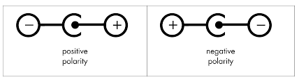

I may be opening a can of worms here, but wanted feedback. The Hughes SMPS, if it's delivering 5V, is doing so with 1.65A, according to the case. Before starting this thread, I had measured 5.28VDC at the SMPS pin. I tried connecting an Uptone Audio UltraCap 1.2. Uptone states it delivers 5, 7, 9 and 12VDC. At 5V it only delivers 1.1A. The UltraCap did not spin my platter. I did not try 7, 9 or 12V on the table for concern that might wreak havoc. Is the apparent difference in amperage a reason the UltraCap did not operate in place of the Hughes SMPS?

The voltage for a good supply doesn't change with load (current draw). If the Amazon Audio statement that the turntable only 'needs' 1/10 of the power available, then that applies to the current available, not the voltage, so they are implying the motor uses 0.165A or 165mA. It is likely that the startup current exceeds that, however a decent 1A regulated supply should be more than adequate. It is the quality of the run-time voltage and current that will impact (if at all) on the quality of torque output from the motor.
If the UltraCap supply did not run the turntable it is most likely you connected it with the wrong polarity.
A DC plug can be wired two ways; the center pin positive (+) and the shell negative (-), or the center pin (-) and the shell (+).
There is no 'correct' or 'standard' wiring, although I think (+) pin is more common. You can determine the polarity if you have a multimeter an check to see if the Amazon Audio (Hughes) power supply is wired the same way as the UltraCap one. If the UltraCap supply has different polarity, then it won't run the turntable and may damage it.
An SMPS supply can be either current limited or shut off when the current limit is exceeded.
A motor draws a higher current on start up as it is not spinning and creating a back emf.
The instantaneous current is only limited by the DC resistance of the motor.
A current limited supply will start a motor and limit the maximum current that can be drawn.
A supply that cuts off when the current is exceeded will not start a motor that exceeds the trip current.
However, in this case, the current will likely be set by the motor controller circuit.
The motor control circuit will influence how the motor behaves. The SMPS supply not at all.
