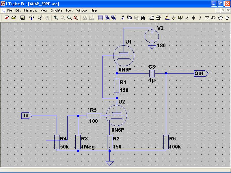

Here is a Cathode Follower shematic from Lukasz , i think he is using 6N6P too !
Should i follow the same values for RG -R1 -RK ?
Sadly there is no info about Caps values , i guess they must be the same as SRPP....

Your CD player is OK, the problem is your mod, all the ways conduct to more distortion and noise, but please, don't use a cathode follower, make an attenuator before the Lampizator, if you don't desist of the mod.
A good cathode follower is very tricky to design properly, and all of them sounds ugly for my taste.
Edit: Seems to me that your amp has a line input, 200 mV sensitivity, then you must use the direct input in order to not overload it.

If you insist with the mod, SRPP is THE way to go.

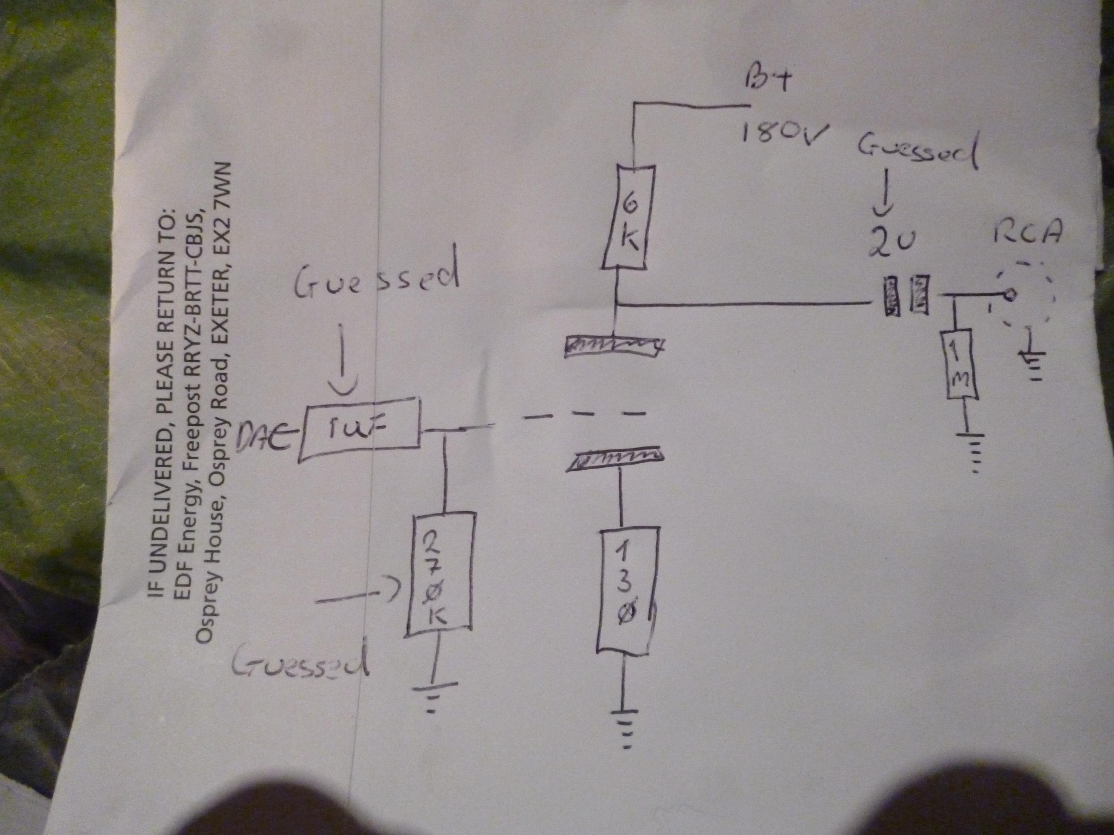

setting aside all opinions of which valve stage is right. Would these values for a sinple cathode follower work to give Stef a buffer
I have no computer skills to do it as a diagram, given up with the load line and Morgan Jones!!!
Stef you have 180volts power supply
I think you are to cut that in half ie 90volts
I look on the 6n6p datasheet and on the first graph of Ia=f(Ua) I take 15ma because of the 90volts and the -2volts of the DAC
SO
the Anode resistor is 90v/0.015A=6000 ohms=6Kohms
its power should be 6000*0.015*0.015=1.35 so at least 2w
Cathode bias resistor is grid voltage/current ie 2/.015=133 ohms so 130 ohms for easiness
its power should be 133*.015*0.015=0.03 so 0.25 (1/4) watt
the grid resistor to ground , I am guessing is 270K
the output cap resistor is 100k to 1M
input cap is about 1uf
output cap is about 2.2uf (I have no idea how they work it out)

Dear Alan , the power suply values are wrong, mine is actually 140v .
And i think 15mA would be too much , what about something like this to prolonge Tubes life:
Power suply voltage to Anode 140v , so there is a 70v drop out. 6N6P I=10mA Ug -4v
Ra 70v/10mA. =7K Ohm for Anode
Rk. 4v/10mA.= 400 Ohm for cathode

I chose 15ma because they say its the valve's sweet spot. Plus when I looked at the curves on the datasheet it worked well with the graph.
Your dac gives 2v not 4v
the grid resistor and output resistor are values I see often used. I have no idea how to calculate them. Morgan Jones may as well of written his book in Mandarin as far as I am concerned. I have no time to do an electronics degree. So I only can experiment. I was hoping someone with proper knowledge would say yeah or nay.. Also I am not sure if the load of the amplifier it is connected to plays some role in the figures...Blind leading the blind here I think.
