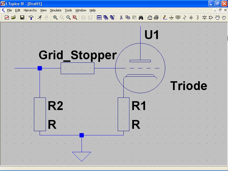

Here is the circuit , with the current values im using right now.

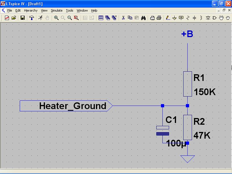

So this way i got 6.3v on each tube heaters 🙂 -- Dc on the Anode suply is about 140-150v , and the anode of second tube half is exaclty 1/2 of Anode supply votage , so everything is measuring Ok this far...
And here is a little different shematic (with other values , not the ones im using in my player-circuit) if some of you can't read the handmade drawins below.
This is a CAD circuit , so its much easier to read. Note on the resistor in between the output Capacitor and the Rca....some discution has been made about this , about including that resistor to prevent major bangs as the cap discharges..
Could that be the reason of the high Noise and Distortion? Or is it just a safety measure? How much is large enough and how much is "too much" in values ?
Going back to the main issue here is where i "may think" the problem arises:
1- High distortion due to an improper value of a resistor , for example R2 270Ohm too large? But i think this only aplies to I type DAC , am i wrong?
2-The fact of not using "metal film" resistor for R1 and R2 ?
3- HF Noise due to lack of filtering after DAC ? Then try to add a RCR filter
4- SRPP signal is very strong and is overloading the Amplifier inputs ? I don't think this is a problem because both signals (stock and tube) have an identical level (to my ears). But if this is the problem , may change to a Cathode Follower topolgy with 1:1 amplification?
4- Something going wrong when i soldered the Dac Vout legs to the input capacitor of the tubes? (Of course i didnt solder directly to the legs , i soldered to the next resistors on the pcb leads after the Dac legs.)
I may also discard this because the amp is playing music so the signal stealing might be Ok .

Left and Right tube are connected to the heaters in series of 12.6volts dc! just like Lukazs said , these voltages get adjusted by a 5W 1Ohm resistor from heater rectifier Plus to the second Capacitor Plus (heater output)So this way i got 6.3v on each tube heaters 🙂 -- Dc on the Anode suply is about 140-150v , and the anode of second tube half is exaclty 1/2 of Anode supply votage , so everything is measuring Ok this far...

I never had any success with the heaters in series. They showed different operating voltages and the voltages drifted all over the place. Too close to 7volts for my liking. I used a lm317 . I use one per heater.

Its hard to tell on your diagram,, but are you using 270 "R ohms" as a grid stopper resistor??If you are it should be 270"Kohms"
R1 should be 200 to 300R ohms according to Lukasz
Yes , i made a mistake with R2 , it should be 270"Kohms"
I was distracted when buying the components , my bad.
That's the reason of thin on bass, try at least a 100K or higher resistor in the output for "discharge resistor".
Hum surely comes from your long cables that connect the valves, they pick hum from AC fields, your PSU is a poor design, you can reduce ripple with more filtering, and heater supply ground must be elevated to +B/4, try a voltage divider, say 150K in series with 47K paralleled with 100 µF.
6N6P is a high transconductance valve, maybe you must use a grid stopper (100 Ω to 300 Ω) on the bottom triode in order to avoid HF oscillations.
popilin could you explain " and heater supply ground must be elevated to +B/4, " so I can understand
In SRPP topology, top triode cathode is at about +B/2, bottom triode cathode is at about 0V, so in order to not exceed Vkf, heater supply ground (or its positive) must be elevated to +B/4
I am going to try this! My heater runs to earth. Its going to be a while before I do it so I cant answer by trial my next question. Is this why I hear music play when I run the valve with just the heaters running and NO anode voltage?
Just double checking: you have the negative pin of the 100uf cap on heater ground?
By "grid stopper" do you mean R1 on the bottom triode ? If thats the case , im using 150Ω
No, between 270K input resistor and the grid of the bottom triode.
