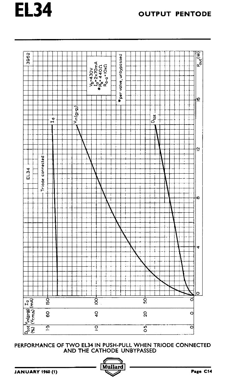

The EL34 example that 45 gives is in the Mullard datasheet (attached). I'm sure it sounds great but perhaps specifically chosen as an application that is not good with mains toroids ;). Although two series connected will do 8k at ~10 watts and 30Hz so getting close.

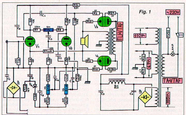

The original schematics is by B. Aloia. This was sold mainly as kit and was called VTA the First. Nothing fancy, just a well designed and well performing amplifier. It used Chinese EL34's.
I can get the 1% THD at 15W without the original overall 3 dB feedback. The signal tube is a 12AX7 (2x channel with triodes in parallel).
