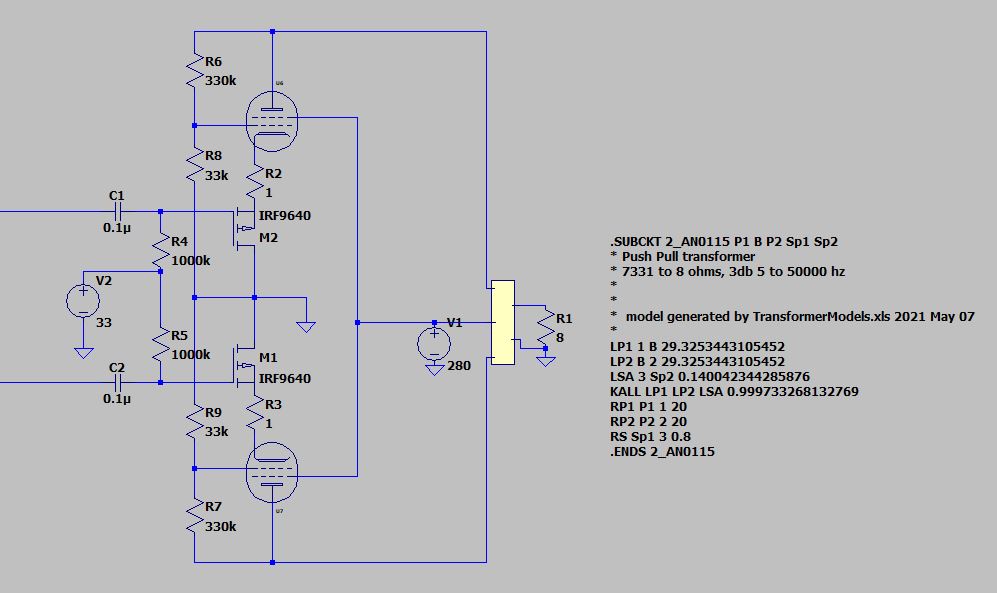

A PP "Unset" configuration with 6AQ5s would work well with these. The source impedance is low and you don't get the power loss you would with triode connection. The attached schematic gives 8W in Class A to below 30Hz with 2 x series connected AN-0115. Output impedance ~7 ohms with no global nfb. You'll have to come up with the front end yourself 🙂.
Awesome! I really have to find the time learn LT Spice someday (after retirement). I really appreciate this tikiroo. I've been wanting to use 6AQ5 in a small bedroom amp for a while now. Like in a small footprint tower chassis (a two story) so it avoids all the bedroom dresser clutter and still leaves my wife with space on the dresser, because its taller not wider (portrait style).
This simulation is going straight into my next breadboarding effort. I think it should be easy to drive 6AQ5 with any number of the proven line amp threads here ("Salas 6V6", "just another 12B4 line amp", there are a number of fine 6SN7 direct coupled line amps here too grounded-cathode-direct-to-cathode-follower types, etc...). Or maybe I'll just use the same front end from the 6BQ5 John Broskie amp I am making a PCB for now, the front-end of this one:

You need a voltage amp and phase splitter to supply about 20Vrms to each half, lots of options to do that. Be sure to connect the primary windings like in Post #4. For 15V secondaries all the windings would be in parallel for an "8 ohm" load, but if you got 5V secondaries there are various series/parallel arrangements to allow for different loads. Just like the old transformers with 4 x 1 ohm windings that allowed 1,4,~8 and 16 ohm connections.
Of course some experimentation will likely be involved, as per Shoogs and Mondgenerators observations.
