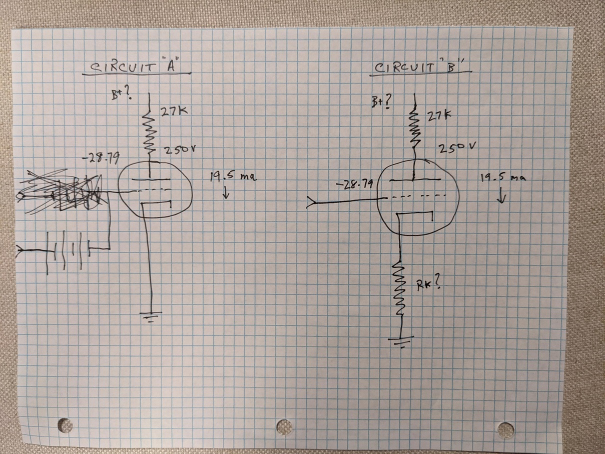

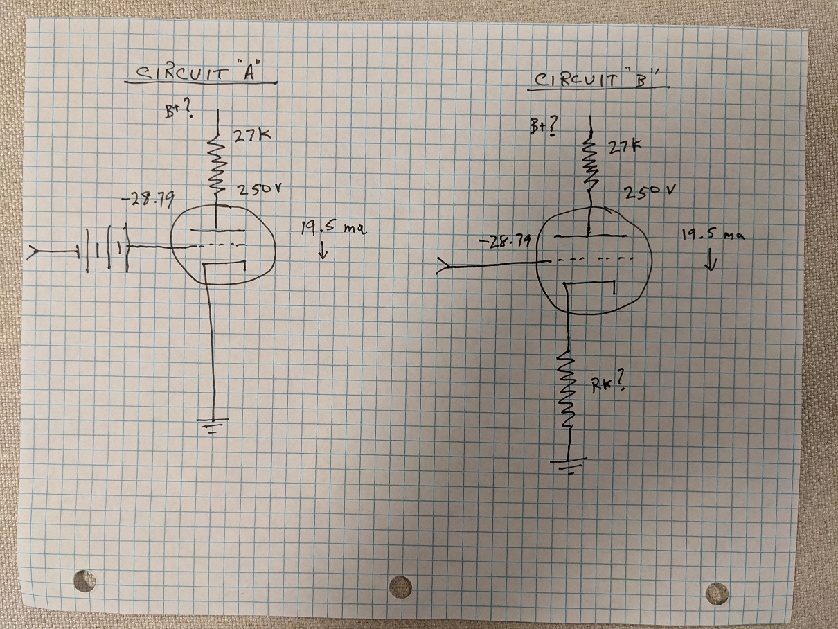

I felt that using what I learned here that I should re-state my original question in a way thats very clear. I wish I could have done that originally but didnt have the knowledge to see it for what it is.
So I'll ask it this way and with a new schematic...
How do I implement "Circuit A" so that all the marked operating points remain by solving for B+?
Secondly how do I convert "Circuit A" into "Circuit B" so all the marked operating points remain by solving for both B+ and Rk?

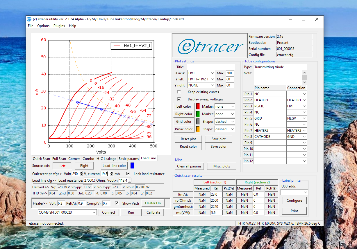

I hope I've got this question right now. My eTracer loadline calculator gives me Circuit A very easily by entering a resistor and dragging around an operating point and telling me all about the distortion, power, swing etc...
But to actually build it using self bias instead of fixed bias, I need to solve for B+ and Rk.
Circuits "A" and "B"

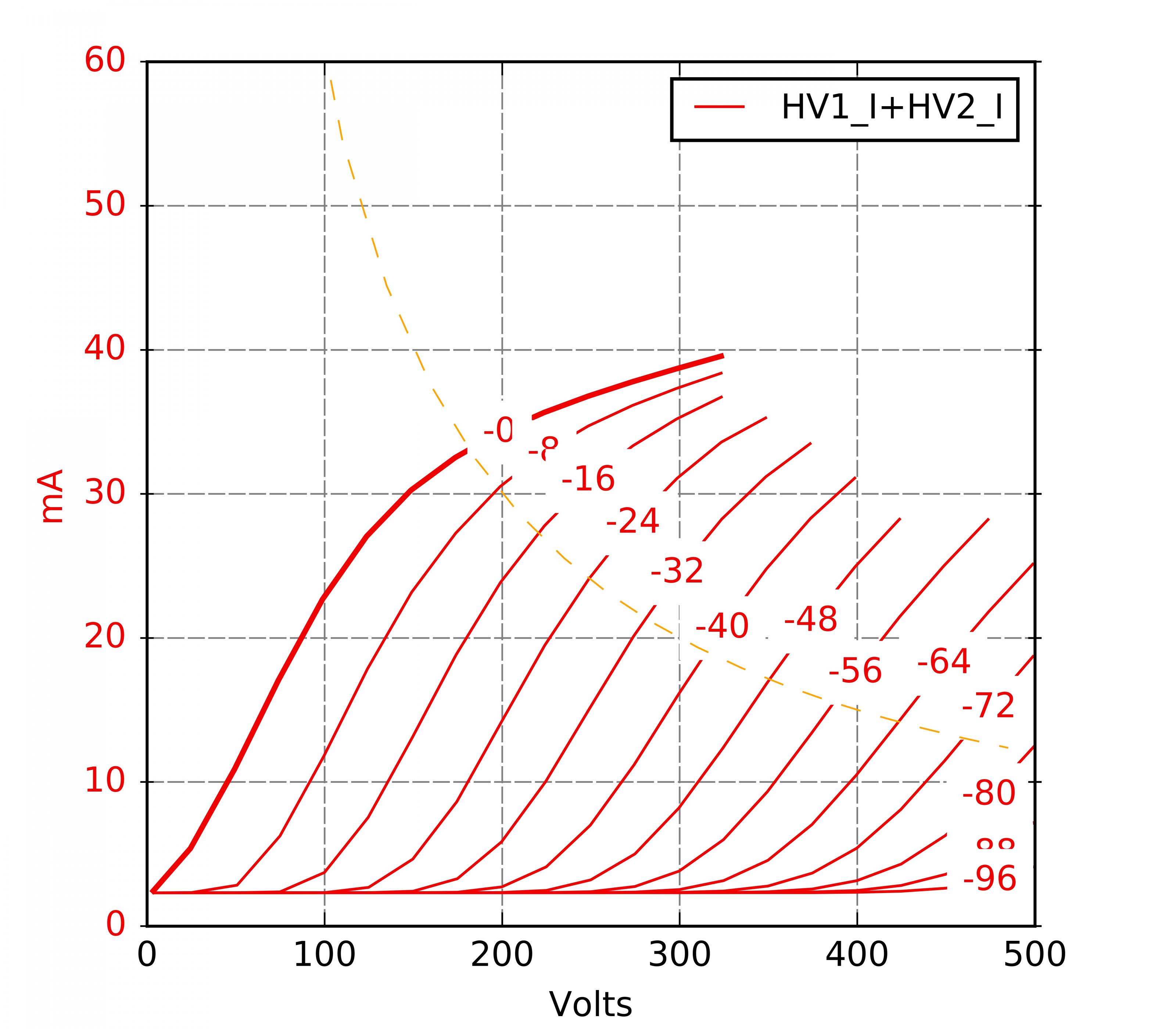

Also here are the curves and the tube is a 1626 triode:
http://www.r-type.org/pdfs/1626.pdf
I still do not know about the software you are using.
But . . .
1. Your battery in Circuit A is reversed polarity, from what it should be.
2. Those curves are not triode curves. The tops of them should not curve and fold over to the right.
They may be actual curves, but only if you either have a resistor in the plate, or if you have a resistor in the cathode, or both.
If an actual triode curve, without plate resistor, and without cathode resistor; bent over to the right like that, it would indicate saturation, and would indicate over dissipation and dangerous operation of the tube.
True triode curves are taken with no plate resistor, and no cathode resistor.
True triode curves I am talking about are the ones you would see in a complete tube datasheet.

I think the curves as measured by eTracer are limited by its power supply. It probably can't supply the higher currents, so the curves are bent to the right.

Oops, here is the corrected grid battery

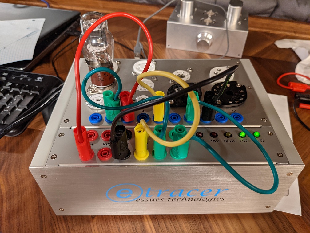

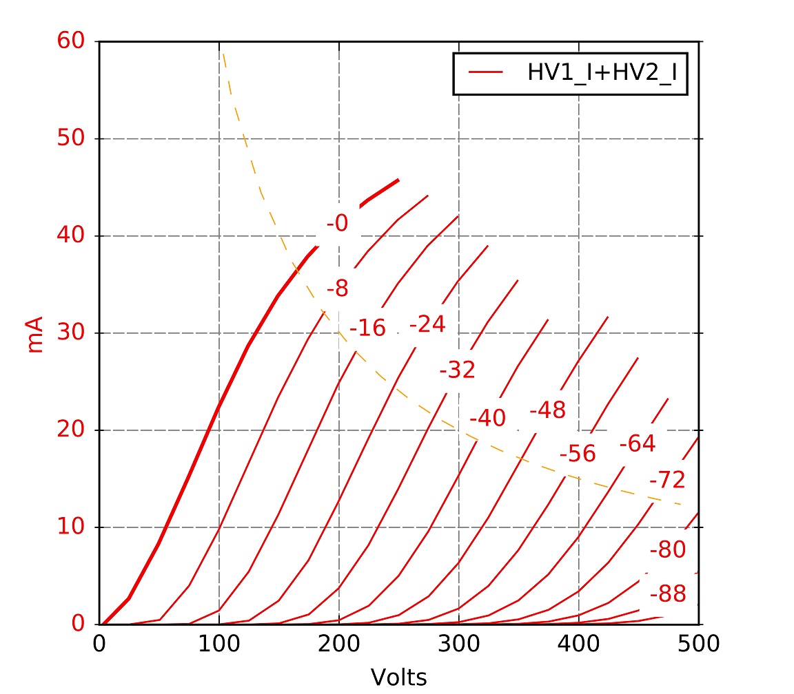

And the curves came from a tube I just scanned, that tube, no resistors, direct from the tracer. The weirdness happens above the max power curve, the tube is actually very linear all below that.
Just scanned now:
Yes that's it, I have the first version of the tracer, the company (one guy) has a mod that increases the max current capability. When I test other triodes this doesnt happen. I'm contacting him today to see how I apply that mod.
For Circuit "B" schematic to be correct, the design grid and plate voltages should be shown referenced to the cathode. Otherwise, they can be taken as referenced to ground. It's a detail, but this way there can be no confusion.
I see because adding an Rk in this context (going from fixed to self bias) and retaining the original operating point, those two voltages now reference to the top of Rk? So when Rk is finally calculated then the plate voltage to ground will be larger but the original operating point was still retained?
Sorry guys for my what seems like my constant stream of mistakes. I just learned that my etracer has a config file update that I didnt apply as I just got a new computer. The give away is that the curves are raised off the 0ma line. The owner is in Taiwan so I need guidance on how to get that config file.
