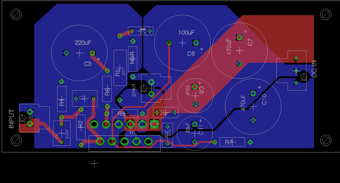

I suggest you swap the Spkr Return/gnd for the two HF decoupling caps.
That gets the HF decoupling route closer to the power pins.
Then move R7 to the right to create a bit of empty space.
Now move C12 down towards that empty space to bring the C12 route closer again to the power pin.
Now move C9 close to C12 and then rotate it 90degrees to bring the top lead very close to the power pin.
It's the length of the route and the area enclosed within the route that determines the impedance (mostly inductive at the frequencies where the HF decoupling is effective).
The total length of the route from the +pin through the two decoupling caps back to the -pin is important. The connection between the two caps becomes the HF audio and power ground.
A short link/plane to the MF power ground then finishes that bit of the layout.
For minimum impedance the speaker return should connect into that short link. Then at some middling frequency the two HF and MF routes will have similar impedances and thus present a roughly halved impedance to the speaker current flow. This is where the swappped location of the speaker return ends up BETWEEN the HF and MF power grounds and that (on a mono implementation) becomes the Main Audio Ground (MAG).

Some suggestions for improvement on the layout in Post #39:
I suggest reducing HBR to 0 Ω and swapping it and C4 in the layout. That'll bring the GND reference closer to the speaker ground terminal, thus reducing any error voltage there.
The node you have labeled as MAG (I'm assuming you mean Main Audio Ground) is actually not the main audio ground. The speaker ground terminal is. I suggest having a look at the Grounding Section of my Taming the LM3886 article series. I explain my reasoning there and back it up with simulation results. I also explains how the LM3886 uses the GND terminal.
R5 needs to be a 2 W type. I don't think that'll fit on your current footprint.
I'd bring C8 closer to the action. There's no reason not to and it will provide better decoupling.
I'd beef up the PWR+ connection. The board cost will be the same regardless of how much of the copper you use, so why not get your money's worth and improve the PSRR+ as well?

Thanks everyone for your continued help and patience. I've updated the layout to address your comments (hopefully I understood them). I've also included the schematic and layout for the power supply; I'm going to be using a 2x25V 300VA toroidal transformer.
Thanks, I'd changed the resistor power rating but forgot to update the footprint.
Sorry if this is a basic question, I'd never heard of a 0 Ohm resistor - does this mean it can just be a trace? Having just looked it up I now know you can buy the component, I just don't understand what that would do which would be different to a trace / jumper.
Thanks again for the help,
Simon.

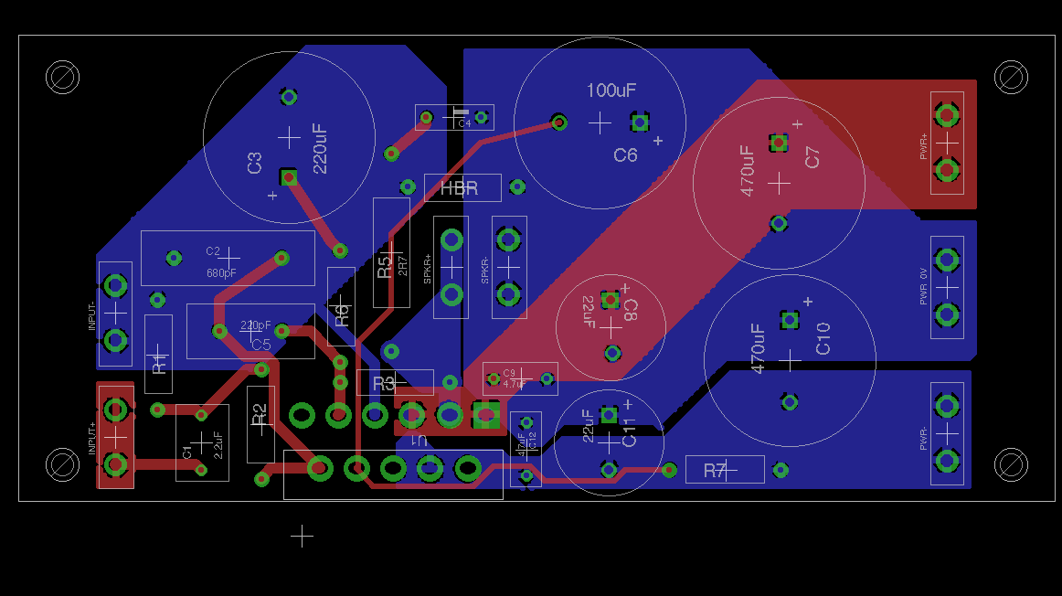

C9 and C12 are normally 100nF. You can increase them to 220nF, if you can keep to the small package.
I can't see how you can get 4u7F into that small a package.
HBR can be a 0r0 link or a trace between two pads that can be cut later, or an actual resistor.
Leaving provision for HBR if required is a wise move in my book.
C2 is enormous. Why? 680pF is available as an MKP in 0.2" pin pitch.
C5 can be sqeezed down to 0.2".
I do recommend that you allow for pin pitch options for your smaller capacitors.
You often don't have the exact pin pitch in stock and it costs lots to order an exact size from a supplier. And some suppliers don't stock all the alternative pin pitch in the values you need.
options for 0.2", 0.3" & 0.4" are useful. & maybe 0.1" if you intend using tiny ceramic (which can be used for 805 smd caps).

The layout is starting to look a lot better.
A few things you could still try:
Rotate both SPKR+ and -. Move HBR to the left of SPKR-. Move R5 and C4 to the right of SPKR+-.
Place C5 on the underside of the board between pins 9 and 10. This will give you more room to optimise the layout of the existing input parts.
Extend the input- plane to go under C2, R2, pins 7, 8, 9 and 10.

I have heard of using low value caps with "gainclones", to be honest, I don't get it. These aren't expensive and they're very good SLPX472M050A7P3 | Cornell-Dubilier Aluminium Electrolytic Capacitor 4700μF 50 V dc 22mm Through Hole A7 SLPX Series Lifetime 3000h +85degC | Cornell-Dubilier

Thanks again everyone, here's the latest version of the amp layout.
C2 changed from Silver Mica to MKP to reduce footprint.
C5 (220pF) removed from layout, to be soldered directly onto the underside of the LM3886 input pins.
HBR & Speaker terminals re-orientated.
Signal return plane extended.
I'm trying to find a way of adding pads to the top layer under the spade terminals to add mechanical support... Eagle keeps accusing me of layer abuse when I try to do this.

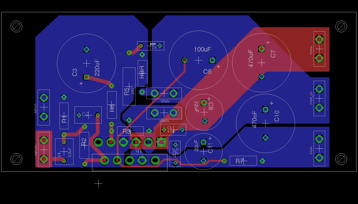

Hi everyone, hopefully I'm almost ready to order the pcbs to be manufactured. Here are the latest layouts. I've swapped out the spade terminals for signal, output & DC to molex ultra-fit. I've also included the remainder of the Thiele circuit on a separate PCB - I'm planning on bolting this directly onto the binding post terminals (hence the M8 pads), there are a couple of vias I can solder to if that doesn't work.
If you spot any problems, I'd be really grateful if you could let me know. Otherwise I'll go and order these.

What's going on with the stripey tracks on the right of the PSU PCB?
Yeah, I wasn't sure about that - it looks fine in Eagle so I guess it must have been an artefact of the conversion to png.
You have plenty of room to scoot C10 closer to the LM3886. I'd beef up the VCC pour even more. You're paying for the copper anyway. Might as well use it.
You're missing three components necessary for stability as the output voltage swings near the negative rail: Cc, Rf2, and Cf (see Test Circuit #2 on page 5 of the LM3886 data sheet).
I also suggest adding 47-100 kΩ from the input to GND on the "outside" of the input cap. This to prevent the input cap from collecting charge if the input is left floating.

I'll squash up the right side of the board a bit more and increase the size of the vcc plane. I plan to solder Cc directly across the input pins on the underside of the pcb - that's why it's disappeared from the layout.
I have to admit that I'd completely confused myself about Rf2 and Cf and also mis-read the responses in this thread. Having read back through all the info I think I understand what they're there for I'll add them back in using the datasheet values.
When you say to add the resistor to the "outside" of the input cap does that mean between the signal input to the board (the molex connector) and the cap?
