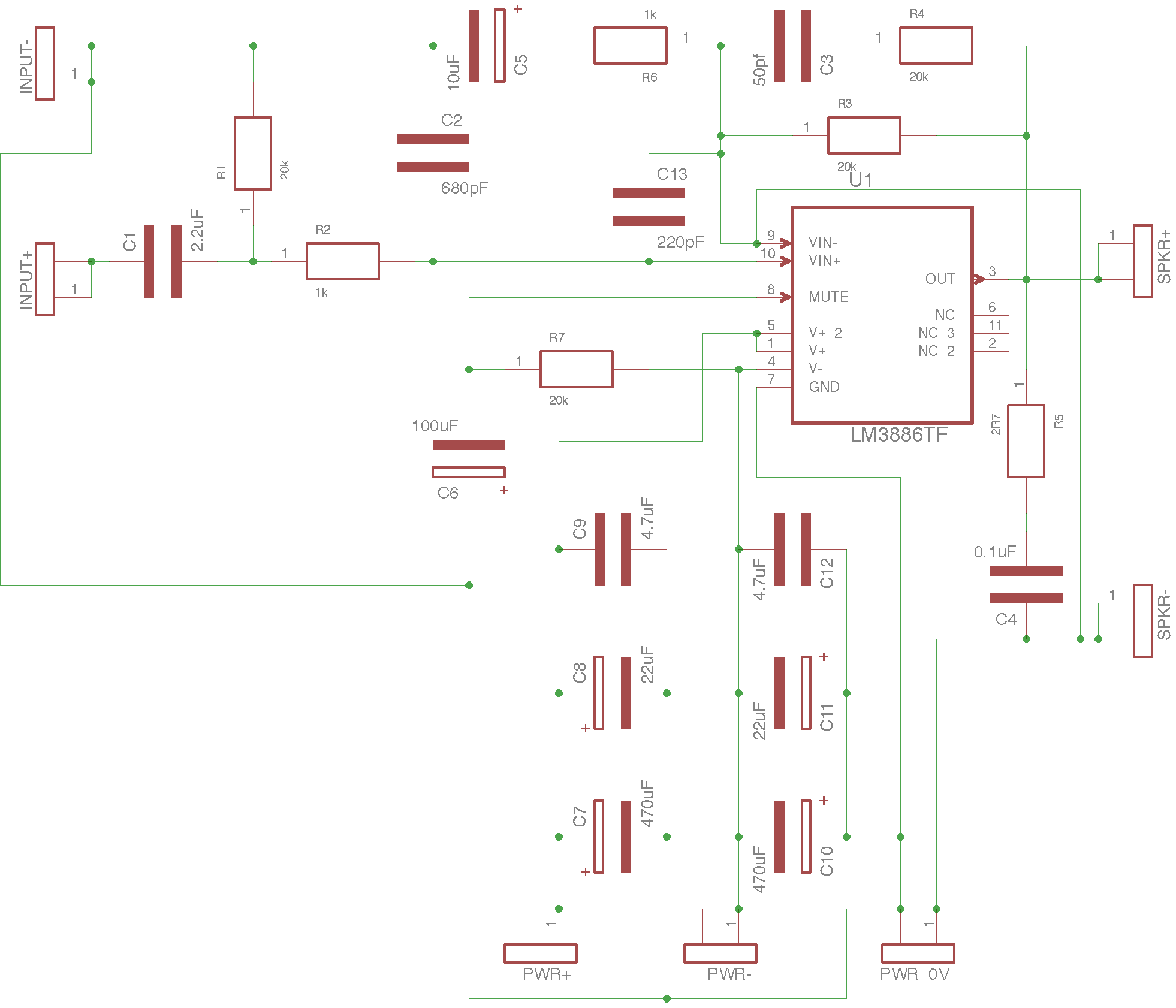

I've tested DC offset with my cheapo DMM and I'm getting a reading of 0.0mV so I thought I'd check that I'm doing this right. I have the amp powered with no load connected and (out of the picture) I'm shorting the input terminals.
When I first switch on I get a reading of <10mV which reduces to 0 over a few seconds. Then when I short the input I get a reading of 1 or 2 mV which quickly goes down to 0.
That's exactly what I'd expect. Most DMMs aren't good enough to resolve the 50-100 uV of typical output offset on the Modulus-series amps.
Does this sound correct or should I buy another DMM to check this with?
If you have money burning holes in your pocket, I'd look at a HP/Agilent/Keysight/Whatever-Their-Name-is-This-Week 34401A. It's a 6.5 digit bench top multimeter. It'll set you back about $1200. Nice meter. I have two of them that I picked up calibrated for dimes on the dollar during the recession. The HP 3478A isn't bad either, though for measuring on tube circuits its 300 V limit can be annoying. That one is more like $150. Get a calibrated one if you go that route.
Seriously, though. You're trying to invent problems where there are none. Everything you've reported so far indicates that your amp works as designed.
Test #2 - I used REW to create a 400Hz sine wave and using the digital volume control on the miniDSP the closest I could get to 100mV was 102, this gave me 2.08V on the output with a 10W 8R2 as a load. So I guess that sounds about right.
That's within the measurement tolerances of your meter.
Test #3 - Question - how do measure whether the amp is clipping? Also I don't have a scope at the moment although I do have some software tools capable of creating square waves (REW, Reason etc.) I have no way of checking how they are reproduced at the analogue input.
If you don't have a scope you can't look at the clipping behaviour. However, as I pointed to earlier you're creating problems where there are none. Plug the amp in and enjoy the music.
...unless you're trying to learn how to test an amp, in which case you should get a scope and learn how to use it.
You can kinda/sorta test clipping my measuring the gain. You did that earlier. Input voltage: 0.102 V; output voltage: 2.08 V. Calculate the gain (Vout/Vin). Crank the input up to 0.2 V. Measure again. Draw gain vs input voltage. Or Vout vs Vin. You'll find that once you reach about 900 mV on the input, the output no longer tracks the input. I.e. as the input voltage is increased, the output voltage no longer increases. That's hard clipping. To look at the clipping behaviour, look at the output on a scope.
