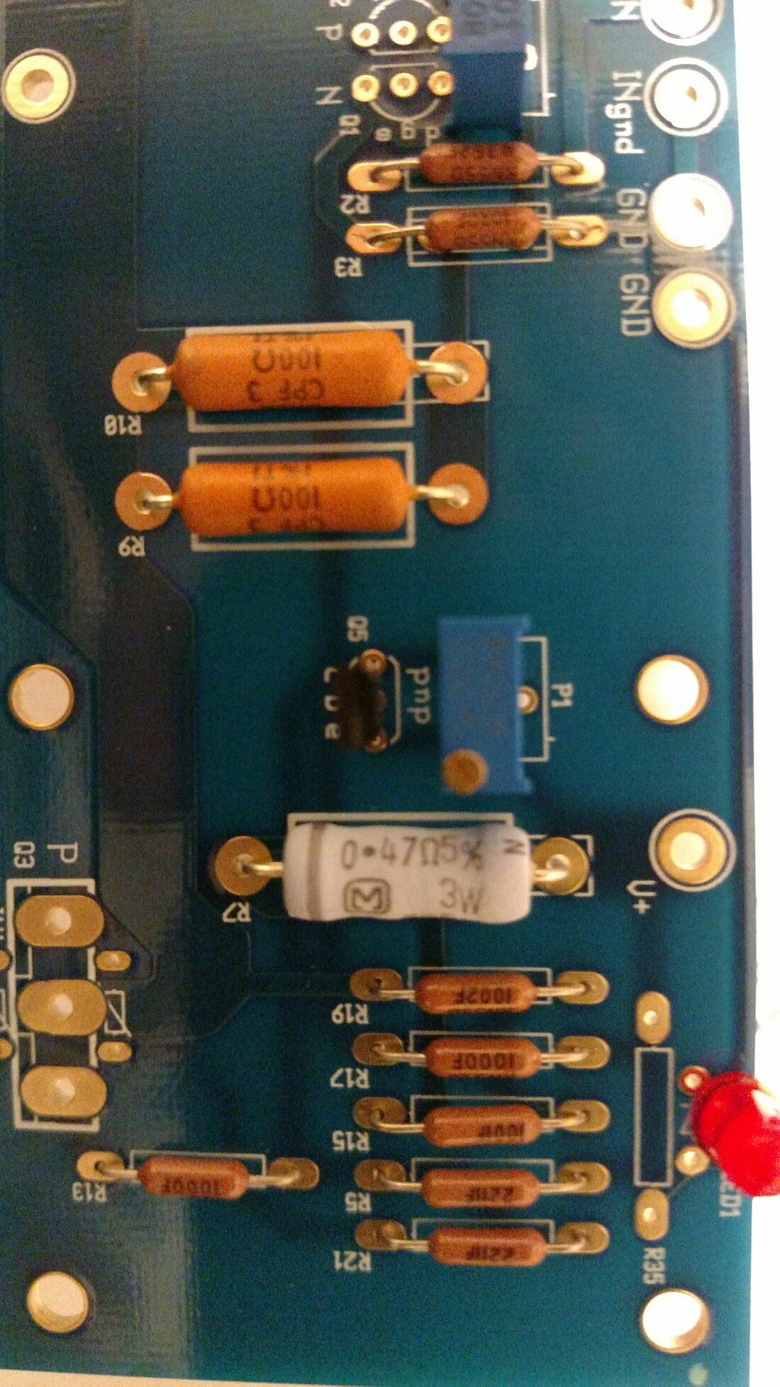

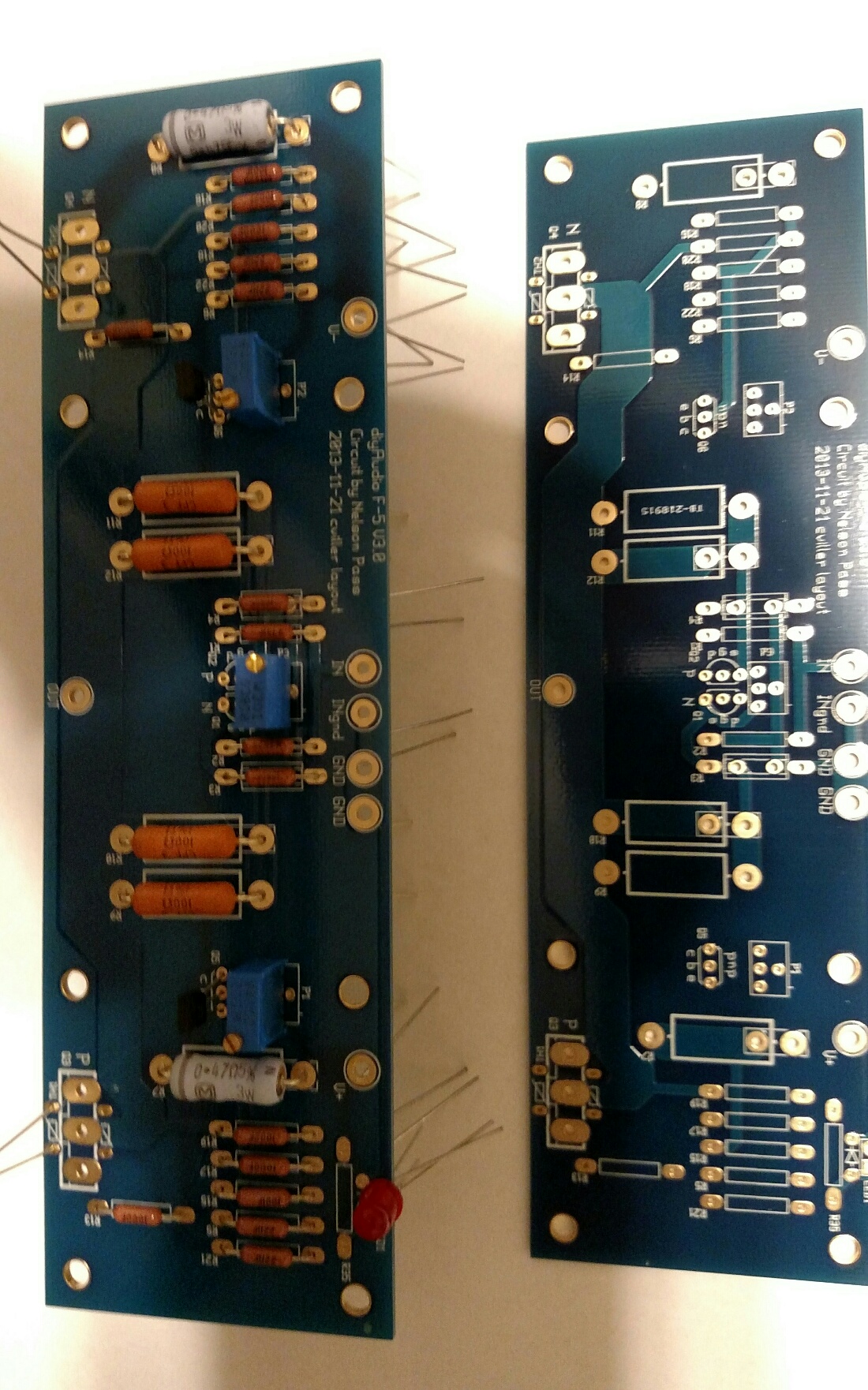

Working on the PCB now and was wondering if someone could give me the go-ahead. I know I still need a 15 k resistor for the led.

Unfortunately going by direction is not fool proof since it also depends on
the orientation of the pot.
Instead, for the V3 schematics,
( see p2 of http://www.firstwatt.com/pdf/art_f5_turbo.pdf )
just turn P1 and P2 so that the measured resistance
across R5 and R6 are close to zero.

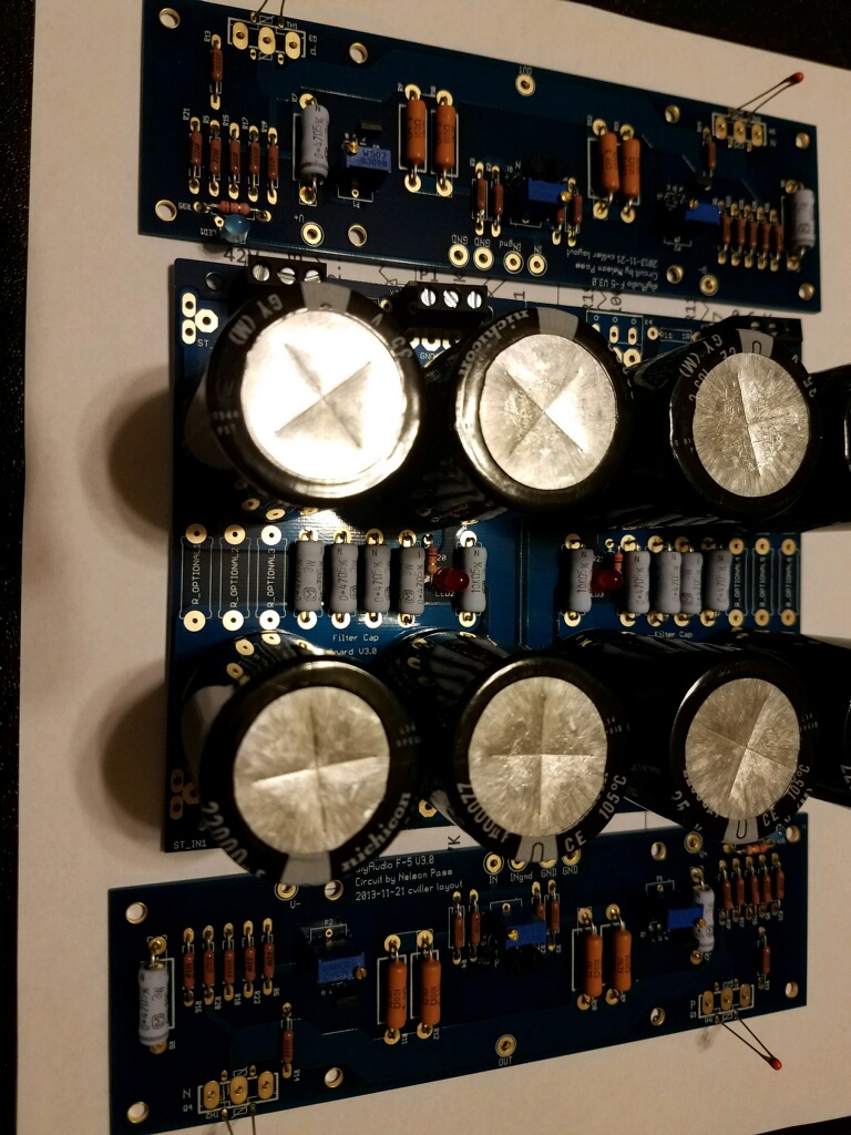

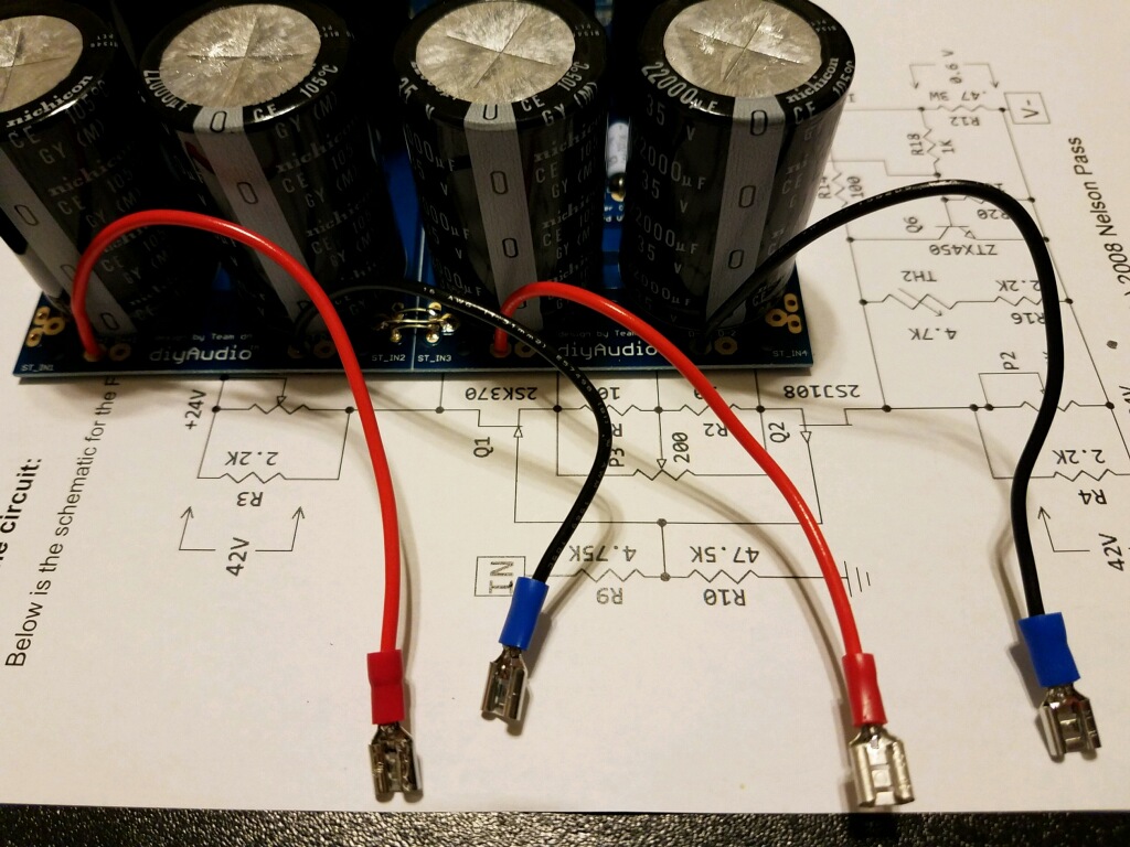

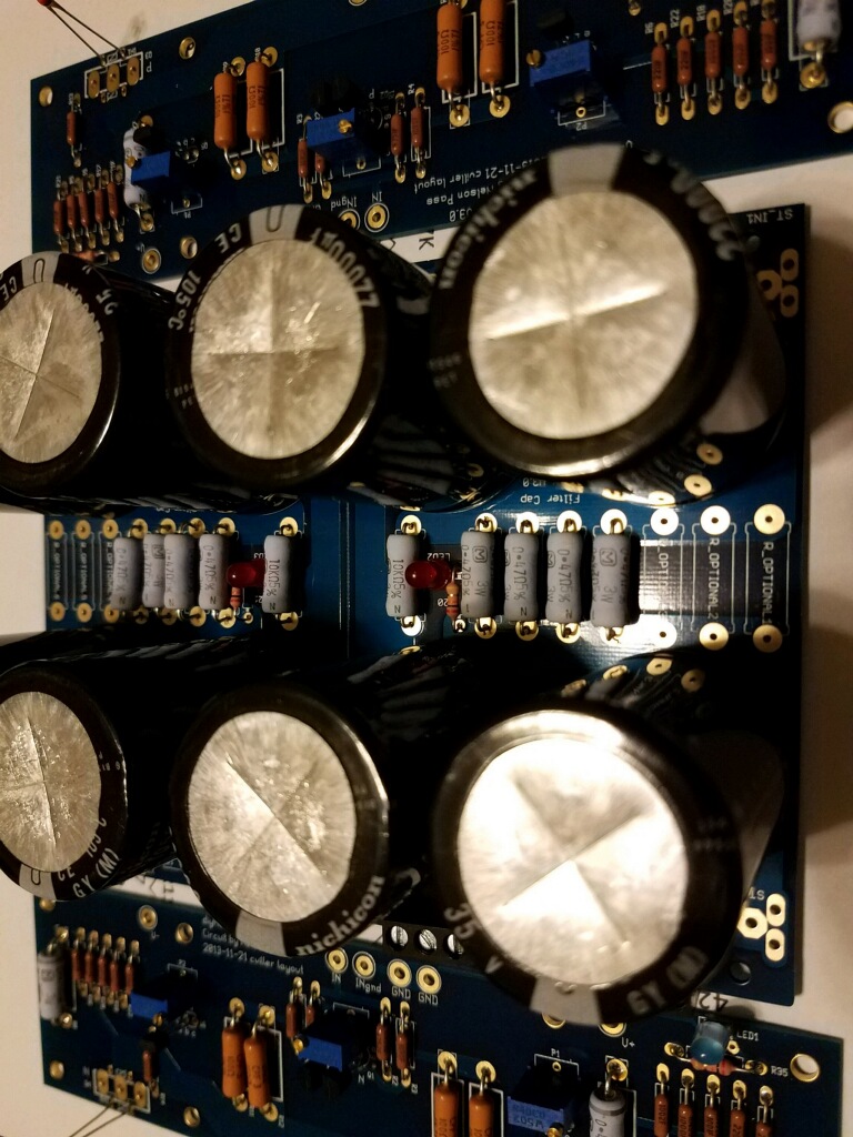

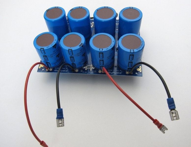

Update. Boards completed. Only question was which direction to mount LEDs, particularly on the PCB for UPS. Please chime in if you see anything faulty or questionable . Thanks

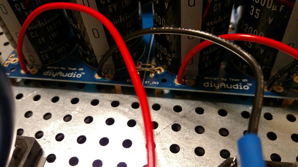

You have the black and red wires on the right side in different holes than the picture in the guide. I'm smart enough to know they are in different holes, but not smart enough to know if it will still work or not the way you did it.

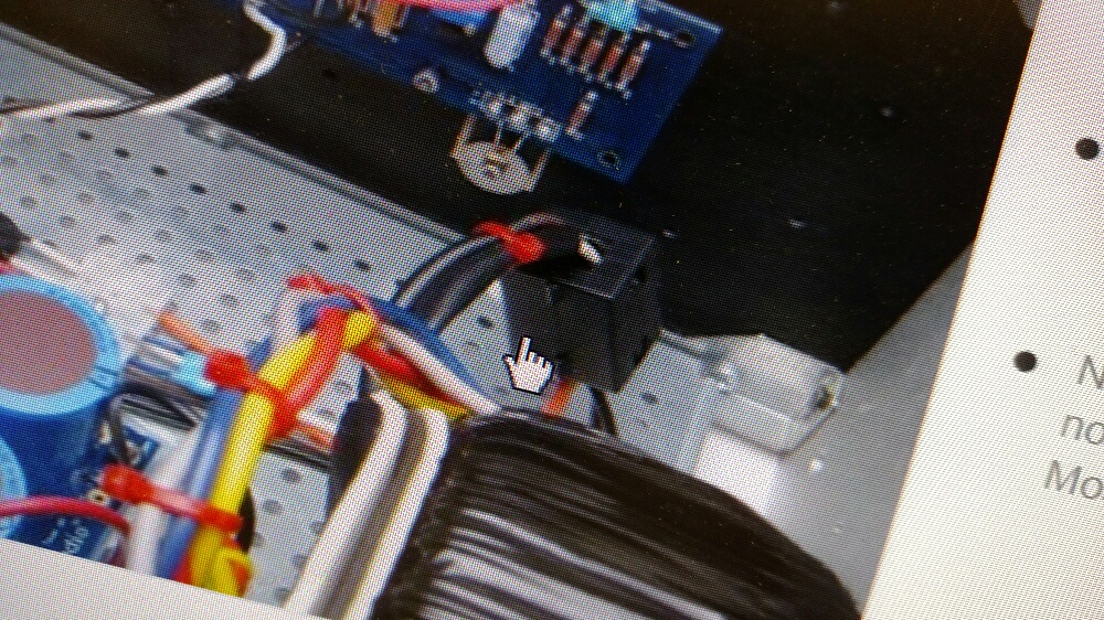

Thanks for the thread cue. Great idea to thread the leads in with the connect crimp, maybe solder after for insurance.
Glad the other holes will still work, hate to redo it
