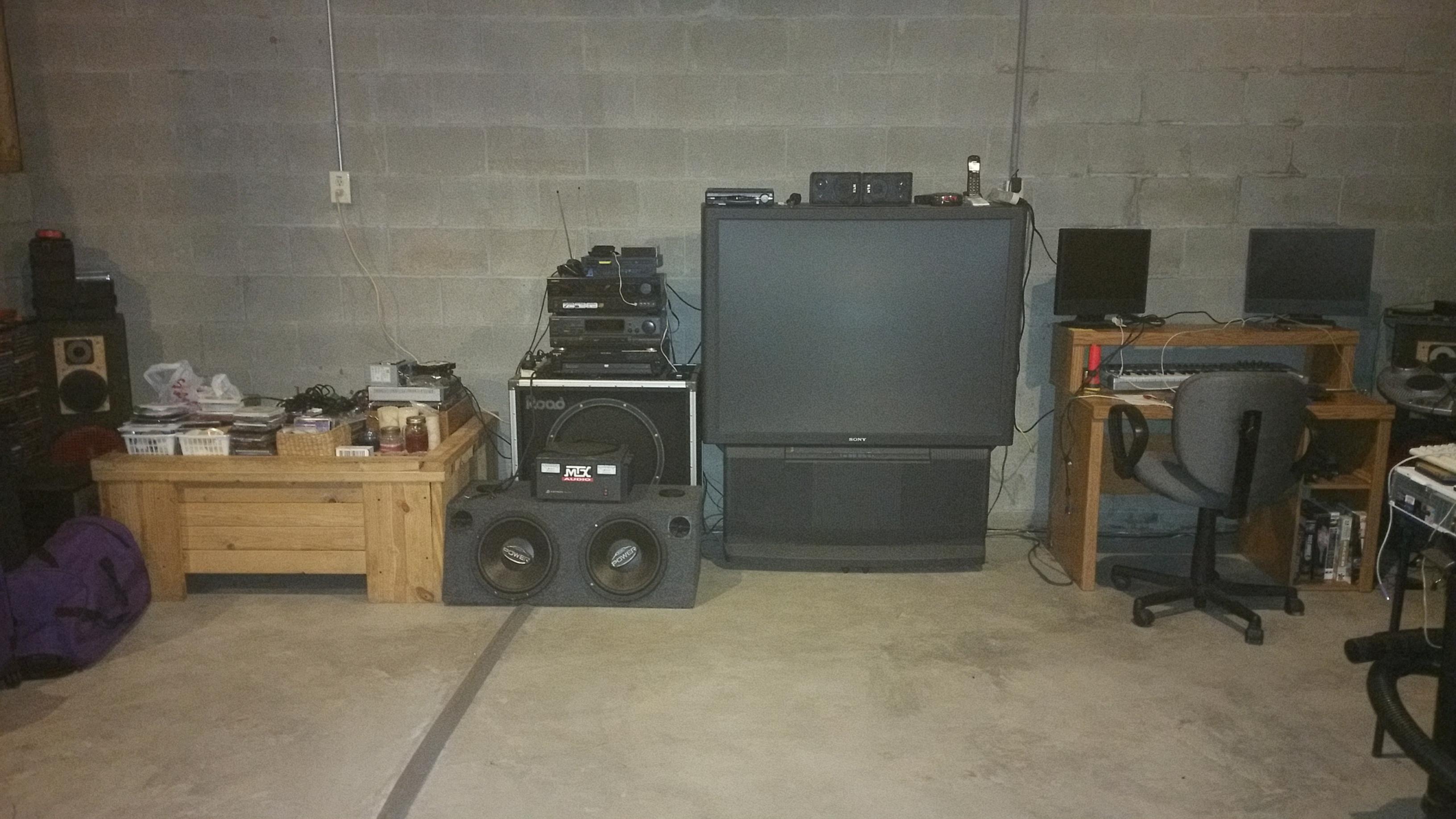

I vote for the bandpass box for your neighbors to enjoy! There are 2 car audio 12's in a BP4 in the table on the left. It's powered by the 2 x 100w receiver in the stack above the 18" PA enclosure. I let my neighbors hear it every now and then!
