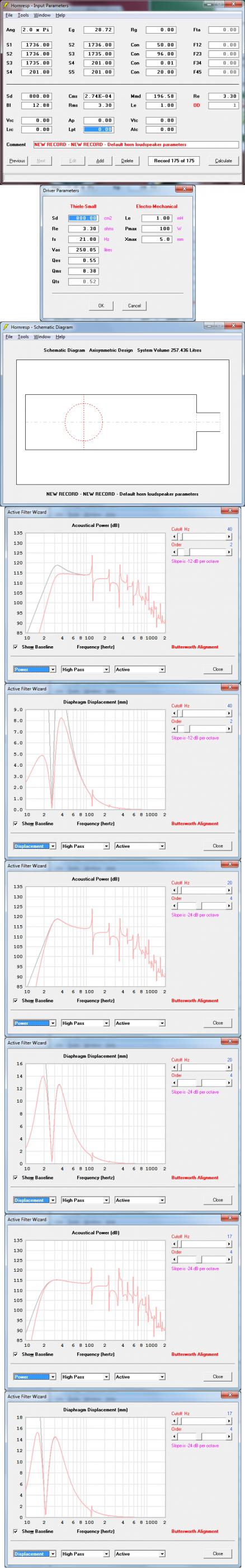

Ran out of time to edit unfortunately so here it goes copy paste:
edit: Just googled some more, it would be 5 times cheaper to go with 160mm pvc pipe than 150 tin one, let alone how much easier it would be to glue it and cut it. I did some noob calculations on some port calc site app and it tells me my 160mm diameter port would have to be 8.94 inches or 22.71 centimeters long. Is that correct? I dont know which parameters you used so with this calc i guessed 26.5Hz tuning frequency, inputed 250 liters for enclosure and of course put 6.3 inches for port diameter (160mm).
If it is even possible to do it with 160mm please let me know, im sure there is more to it than just its proportions so i dont know if it is even possible but it would be A LOT easier and cheaper.
160 mm diameter tube is fine, if my calculations are correct that's about 201 sq cm.
It's a bit odd to have an empty chamber below the box that the port fires into but if you want to do that, it's fine. It will be a bandpass chamber but the effect is likely way too high in frequency to worry about for a subwoofer so I've neglected it in the sim.
These sims show a variety of different situations, a couple of different filters and a couple of different tunings.
All sims shown at 250 watts.
Image 1 - hornresp inputs
2 - t/s parameters (make sure I didn't make any mistakes or change anything since I started)
3 - schematic drawing - the port should be simulated inside the enclosure with volume subtracted but that would require different software and it hardly matters
4 - frequency response with a 20 cm port and 40 hz 12 db/oct high pass
5 - displacement with 20 cm port and 40 hz 12 db/oct high pass
(velocity for this port length and high pass is low, maybe 12 m/s IIRC)
6 - frequency response with a 20 cm port and 20 hz 24 db/oct high pass
7 - displacement with a 20 cm port and 20 hz 24 db/oct high pass
(this high pass would have to be done with your parametric eq, velocity for this high pass is high, maybe 27 m/s IIRC)
8 - frequency response with a 40 cm port and 17 hz 24 db/oct high pass
9 - displacement with a 40 cm port and 17 hz 24 db/oct high pass
(this high pass would have to be done with your parametric eq, velocity with this high pass is moderate/high at about 22 m/s IIRC)
This shows that port length isn't that critical - the difference between a 20 and 40 cm port length drops tuning from about 27 hz to 21 hz and the bump in response shifts a bit lower in frequency and smooths out a bit in amplitude (a few less db) with the lower tuning. BUT the lower tuning comes at the expense of higher excursion for the same output level.
This also shows that you can control the bump in response with a high pass filter or with eq - but with the type of music you listen to you might enjoy a really fat bass line. Personally I like a bit of a bump at the lowest frequencies especially with this type of electronic music. It will sound different in different rooms, room modes may be as strong as +/- 15 db and could occur at any frequency in the subwoofer passband so it's hard to say what response to target and what you will prefer.
It's easy to do the high pass as shown with the parametric eq. Just use the eq to cut the DIFFERENCE between the blue line and red line in the frequency response graphs shown.
This gives a pretty good idea of what different port lengths are going to do, what different filters are going to do, and what velocity will be like for these situations.
After this if you have any general questions I will answer them but for the most part I'm done with this. You really should download a simulator and play with it. I recommend Hornresp but most people start out with WinISD.

Pvc pipe i found is 160mm in diameter and 500mm long so i will start experimenting with port lenght before i cut it to calculated 222mm, i wont seal it with silicone right away since there will be changes but i will think of something with a putty or something stupid like that.
Big thanks to all.
Small update. Ordered front and back panels couple of days ago but they have legal right to deliver them up to 15 work days so thats gonna probably take a while.
In the mean time i decided to take another cabinet and re-purpose it
for this kind of thing because panels in those dimensions i showed earlier were in the neighborhood of $150, these are about 65 cutting included.
While waiting for the most important panels i decided to build some basic bracing inside, It is all glued first then screwed after the glue has hardened a bit so i dont get any squeaky noises. there is still one horizontal one to install but i will do that after im sure i have subwoofer clearance.
I also put between the panels some pva glue to fill the small gaps and after it dried i put silicone over all the edges i currently can silicone.
Im thinking about bracing front to back but i dont know how will i manage to drill the holes exactly where those braces would be once the box is closed so im thinking about just seriously thickening the sh!t outa those front and back panels with some nice planks. It might even be needed since im not sure about my port clearance from the inside at 40cm long and 16cm diameter it leaves me with just 6cm to the back side, dont know if that would be a problem so im planning on making a thicker front side and have port stick out but id hate to have it like that, I might find an 160mm pvc elbow but im not sure how lenght of port would be calculated then, imput is appreciated!
Could use some planks from an old shed that look cool and aged, would sand them on one side and glue them on with some epoxy glue or other that has great shear strength and that way all flex would be held by the glue layer.
Not to mention its more difficult to move more mass so that will help with efficiency of the box as well.
Anyway i know i jump from subject to subject but everything is getting close and last minute changes are still possible.
Components are waiting
Cheers guys and i cant wait for your comments!
