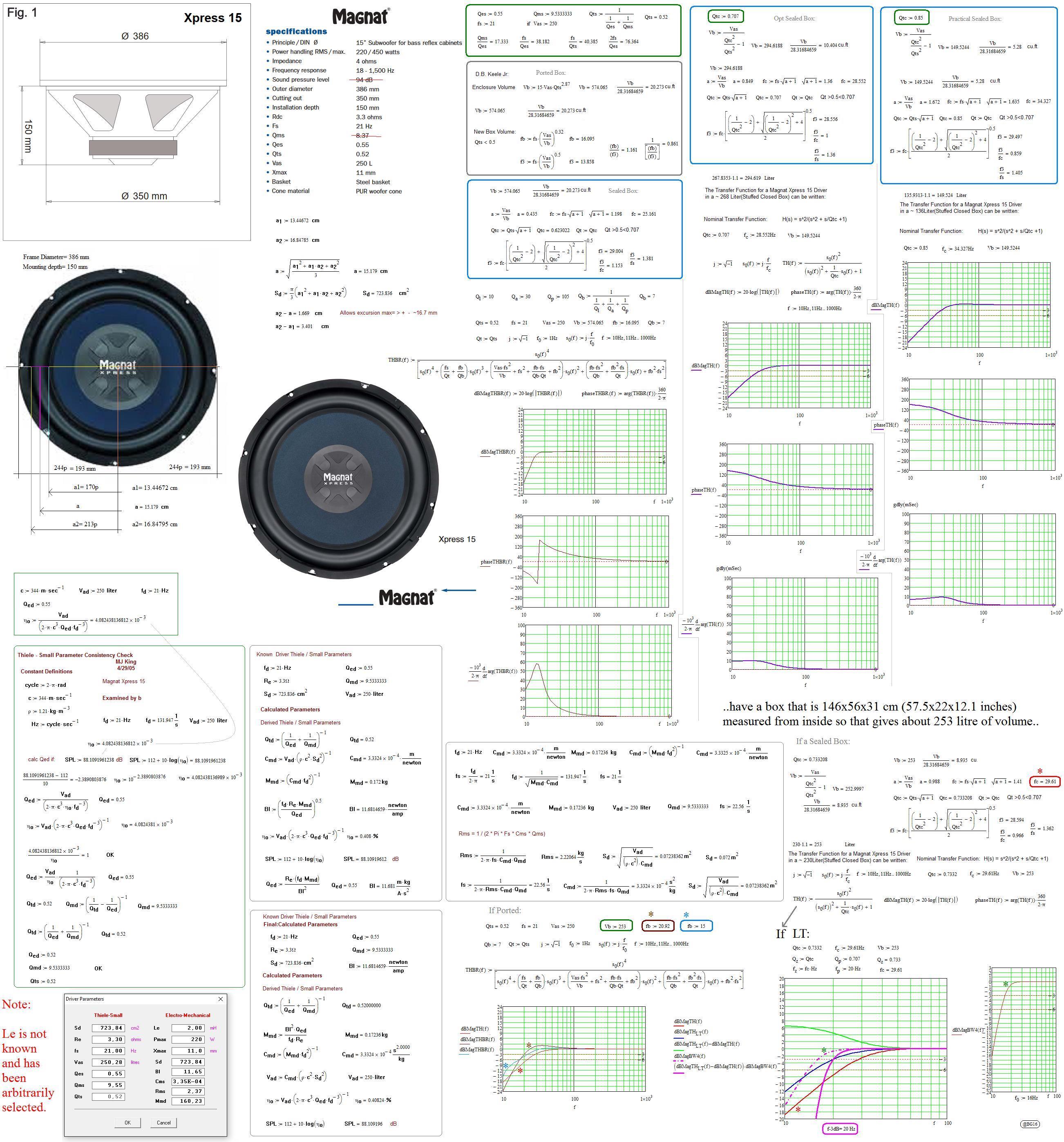

Just bought a cheap Magnat Xpress 15. I know its not the best sub there is but this IS diyaudio and i like doing things on the low budget side so i think this is the best place on the internet to seek help.
Anyway i would like if you guys could help and guide me with box design and parameters. Here are the screenshots of subwoofers specifications to make it easier for you guys.
I like music with really low bass sometimes hitting 30hz and lower so whatever you guys think would be the smartest thing to do please let me know.
Id like to mention that i have a box that is 146x56x31 cm (57.5x22x12.1 inches) measured from inside so that gives about 253 litre of volume, made from good quality wood and im ready to repurpose it whole just for this enclosure. It would be preferred if i could leave the box as is and just port it or put a horn or something.
I would really like it to go as deep as possible and im not expecting miracles from that sub but it would be nice to hear a boost in that part of the bass feels nice instead of that cheap crap that only rumbles in your ears.
Anyways guys, be it closed, ported, horned or whatever things exist that i havent even heard of please give me ideas, links, plans, opinions or whatever else, im all ears and im very excited to read your posts tomorrow!

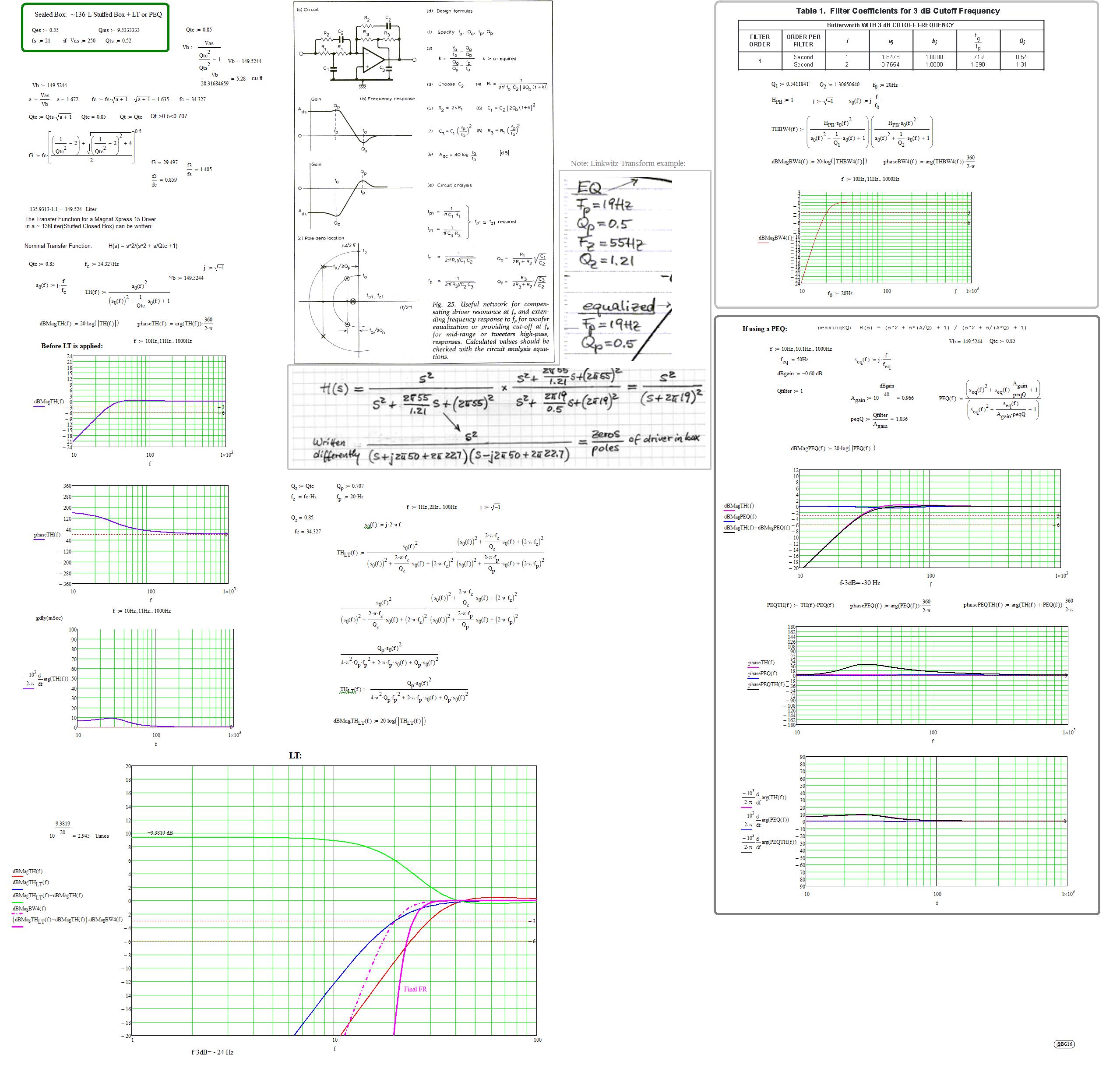

Well it turns out sealed 250 litre has Q=0.707. F10 <20 Hz.
If you heavily stuff it that will further push the Q down so that you have a better match to room gain.

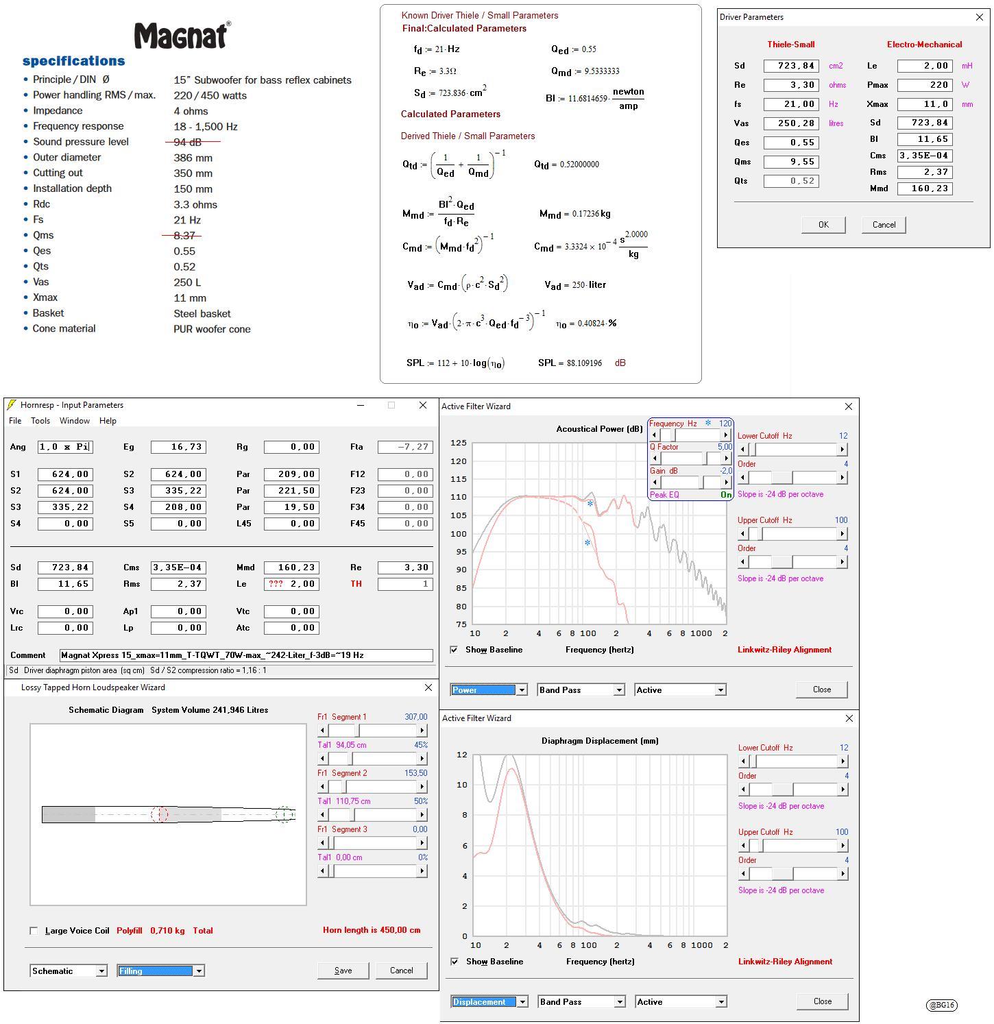

This is not a very good driver, it has limited usefulness.
Simulated here in both ported and sealed 250 liter boxes. Hornresp says qtc and f10 are both a bit higher than predicted by P10 in the previous post. I had to guess at Sd and Le. And I'm not sure if the xmax is rated for one way or peak to peak, so I've assumed one way which is the best case scenario.
Shown at 125 watts (which is enough to drive the sealed box several mm past xmax, while the ported box stays within excursion limits as long as a 16 hz 4th order high pass filter is used).
The sealed response is not bad and will blend ok with room gain but it's not going to be loud at all even at it's limits. The ported box will be pretty boomy in room unless you eq since the room gain will boost the already boosted lows. It would require a MUCH larger box with lower tuning than shown to get a better response with a ported box, but for a cheap driver like this a box like that is a waste of money and space. If you had 20 or 40 of them and used them in infinite baffle that would be another story ... that could work really well.
This kind of driver is meant for car audio infinite baffle, or seriously boosted response in smaller boxes. There's a 100 liter ported box recommendation in the manual for the driver, as you can see it's got a seriously boosted low end that doesn't go much lower than 30 hz.
Here's the manual - http://www.magnat.de/media/image/articles/datenblatt/f/Xpress_10_12_15_Manual.pdf
Here's the sim -

There's not enough information to give a real recommendation.
1. It looks like you are eq'ing everything below 20 hz down by 48 db/oct or so.
2. In addition, you say the amp has a subsonic filter (high pass filter) of 12 db/oct at 15 hz.
3. Also in addition, the amp has another high pass filter with 40 hz lowest setting, 12 db/oct.
Hopefully #3 is defeatable, otherwise you may never achieve your goal. I assume #2 is not defeatable, and #1 may not be necessary.

Ok, here's one way to do it.
Put a port in the 250 liter box that is 180 sq cm and 20 cm long. That can be a slot port or round. If it's round you can use a 6 inch port or four 3 inch ports. That should be big enough to keep velocity at an acceptable level with the filters used here.
Use the amp's 15 hz subsonic filter AND the amp's high pass filter set at 40 hz. You don't need to use your eq to cut anything, these two filters will give the response and displacement shown with 250 watts.
The blue line on each graph is the performance with only the 15 hz subsonic filter, the red line is with the subsonic filter AND the 40 hz high pass filter. Both filters are BW 12 db/oct.
This is only one way to do this. If you wanted to use eq instead of the high pass filter that could work too, might even work better. As you can see, when using the 40 hz high pass filter you don't have enough amp power to get the driver to xmax so a bit of performance is left on the table.
As shown, this will give you a strong 30 hz as requested, and 27 hz is about 5 db down.
Of course this assumes that the filters in your amp will perform as advertised. On a cheap amp they might not do exactly what they are supposed to do.
If you want to try using your eq as a high pass filter instead of the amp's built in high pass filter I can work something out for that too. I would need to know a bit about the eq settings - frequencies and slopes available.
Just note that a response like this might sound a bit boomy in room, but I have a feeling that's what you are going for.
