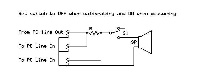

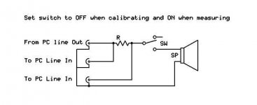

here's the simple jig I use, just need to remember to flick the switch to 'calibrate' (speaker disconnected) when you start up LIMP, run the calibration (need to make sure you've got the correct inputs/outputs selected for your operating system)
then switch to 'measure'.
