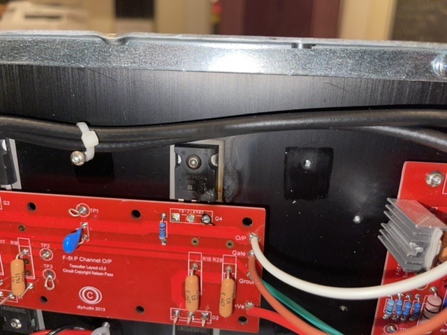

I think I found out what happened. One of the speaker wires had come off the terminal and made contact with the case. <face palm> Now it's time to pull that open and find the smoke... order parts, wait a month. blah! Lesson to me to properly terminate wires instead of just slap 'em on there.
I was so happy to find it was just a fuse. So I replaced it… hmmm another fuse. I’d ran out of identical fuses, so I put in a … larger one. Now there’s some action! Smoke and fire from one of the IRFP9240. There’s something I can fix. Remind me to get the video rolling before hitting ON switch next time.
What’s the best way to proceed? I’ll certainly need at least a new MOSFET.
