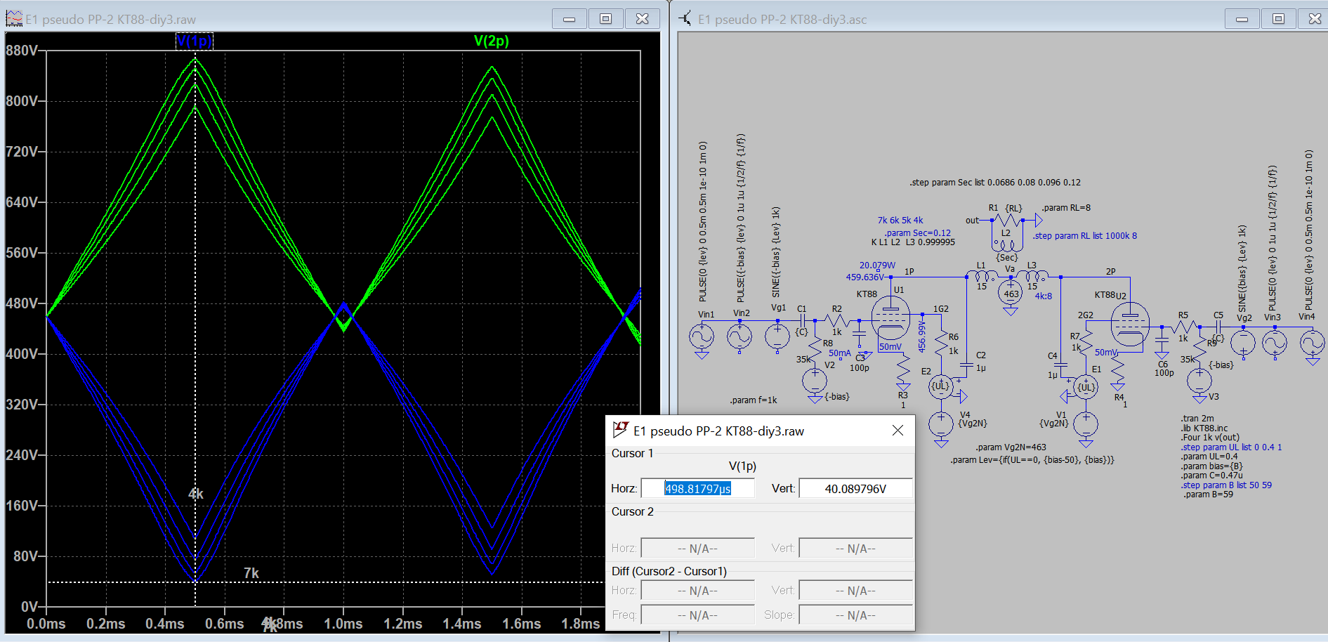

New year trouble shooting a KT88 output stage
In the AB1 region, (when one tube is cut off) negative feedback reduces the 'effective rp' of the single tube that is on.
That one factor, causes more output power before the amplifier starts to clip.
That is what I have been trying to communicate.
Matt Rowland,
With the 44 Posts so far, I do not remember . . .
Did you ever listen to the amplifier at moderate volume (staying in the Class A region)?
I would be surprised if it did not sound real good at that volume.
And I would bet even in AB1, it sounds OK, instead of some of the solid state amps that have real sharp clipping characteristics.

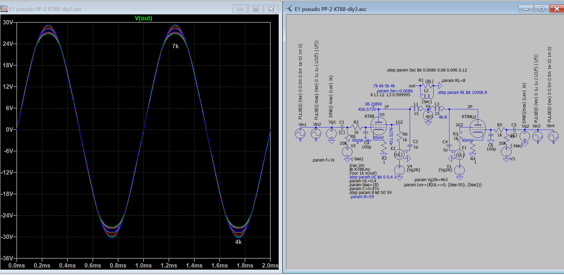

Here is Thd% report of various OT impedance (7k 6k 5k 4k), best around 6K:8.
